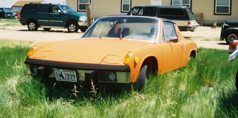

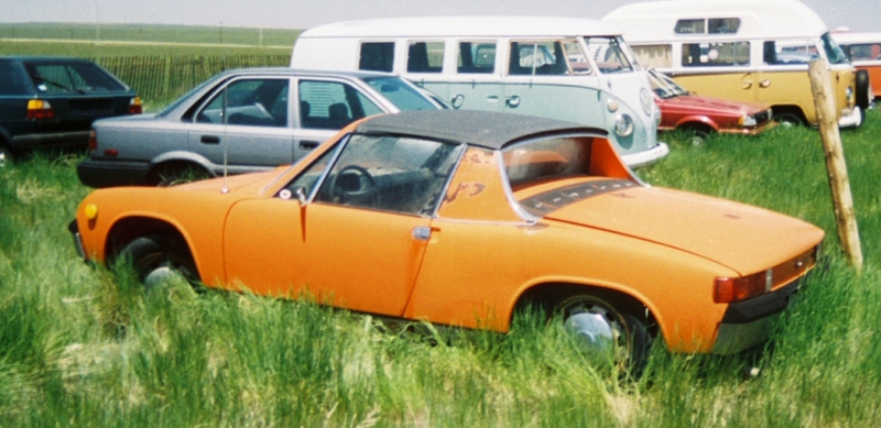

First off here is a little history on the car.
In 2002 I found this 1973 1.7 in a field outside Laramie WY where it had been sitting since 1982 with some other VWs.
After bolting on some webers and swapping out the battery, fluids, and tires I drove it out of there.
As you can see she was pretty rough but other than some surface rust she was darn near rust free.

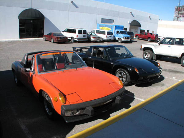

Here is a picture of the 914 about a month after I found it, next to it is my '37 Plymouth street rod.
As you can see I had already installed the rollcage when this picture was taken.

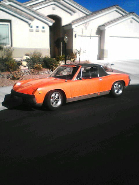

After school I moved to Las Vegas to work for Renegade Hybrids. This is when I really started upgrading the car.
Here is a picture of the car with stock body and drivetrain after I had installed the carrera front suspension and polished fuchs.

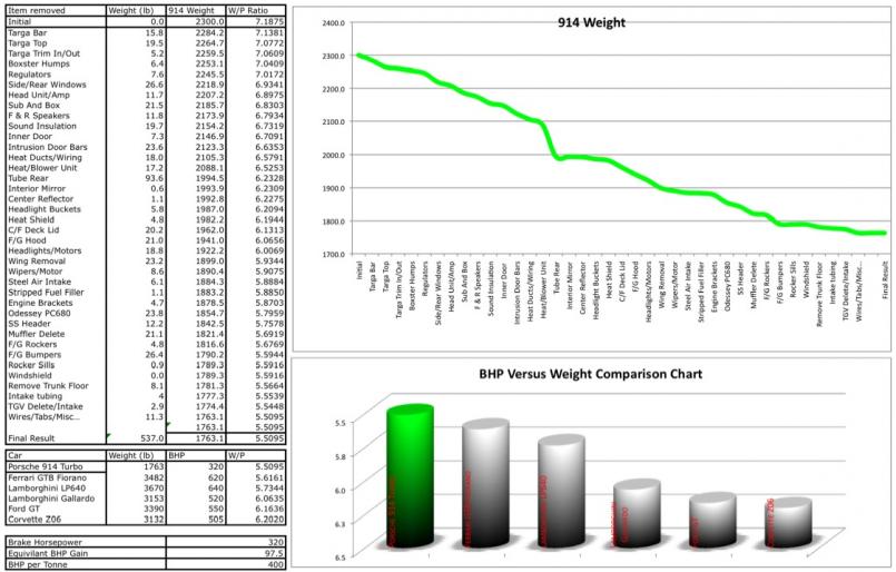

To keep track of my progress have been documenting my weight savings with excel.
Here is my spreadsheet showing the part removed or replaced, the resulting weight and power to weight ratio, along with the info from a few other cars for refrence. So far I have dropped just over 500 pounds.
I have a feeling this car will kill me if I ever get it on the road.

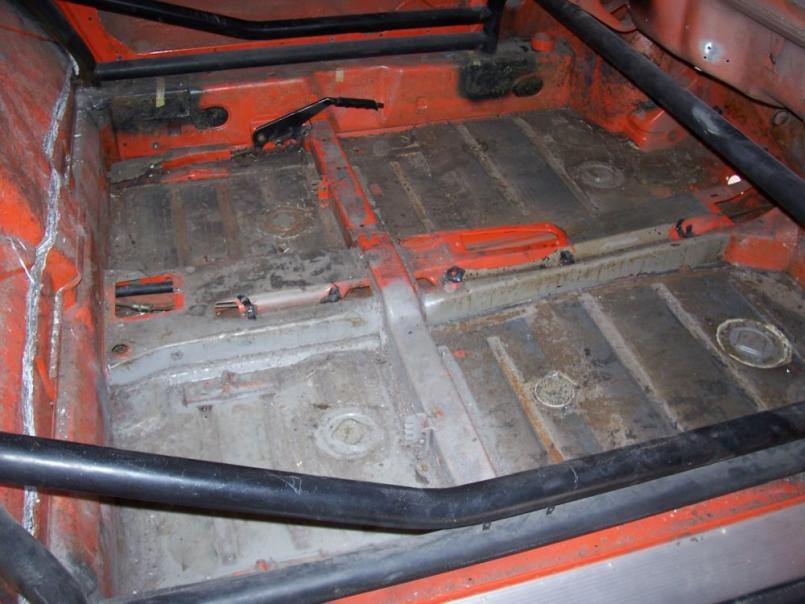

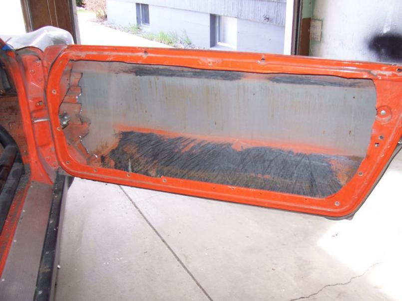

I finished scraping the tar out of the interior and gutted the pass side door.
I was glad to find very clean floors under the tar.

Wow those floors look great. I had just done that a few months ago and mine were not like that.

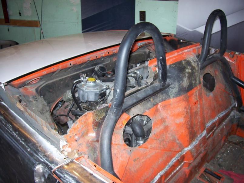

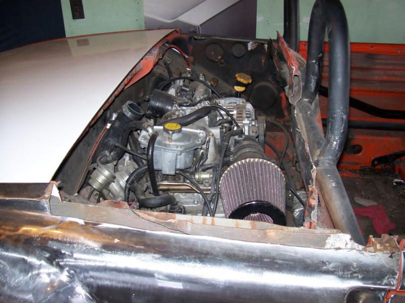

I cut off the targa bar and made this horrendous hole...
The car is pretty much stripped but I am leaving the engine and tranny in for now so I can build the belly pan and design the intercooler system.

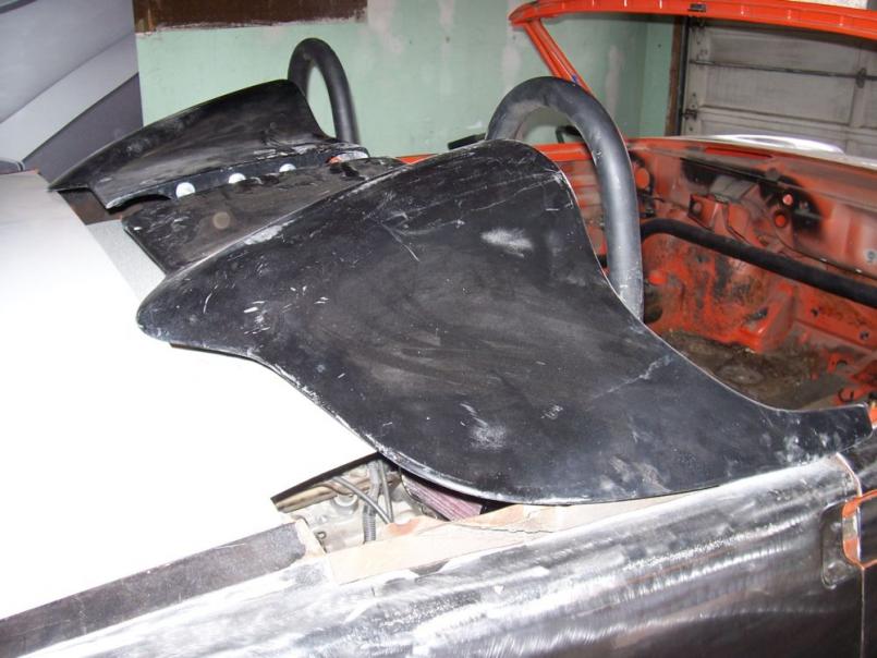

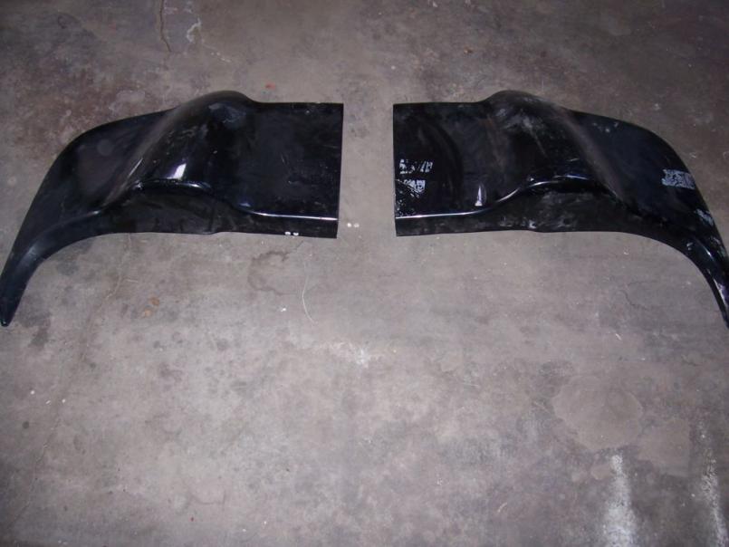

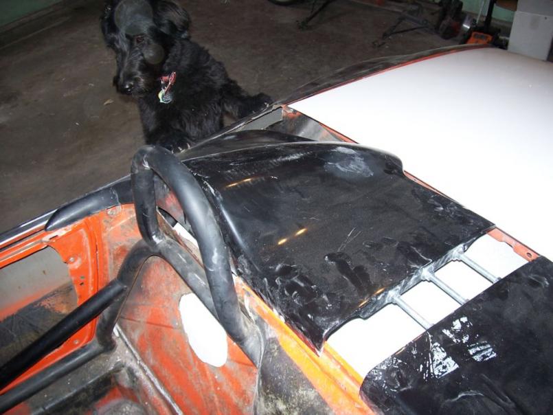

I got a heck of a deal on these Boxster Humps. The plan is to 'glass these into one piece and build up the lid to match the rest of the car. Then I will rebuild the metal around the area. I absolutely hate working with F/G so I will make the metal match the F/G lid rather than vice versa.
My dog Bailey checking the fit.
This just might work!
