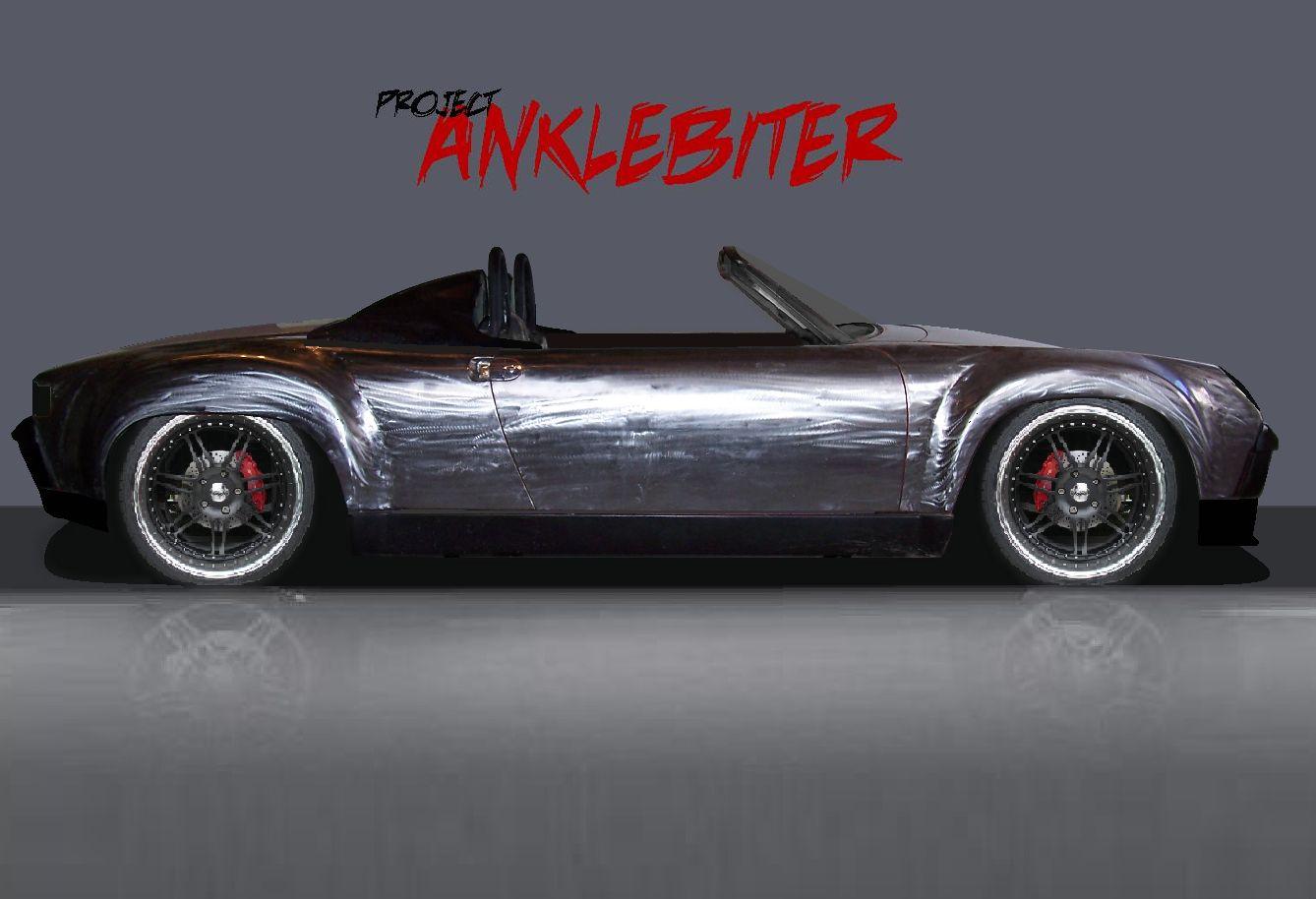

Click to view attachmentHere's the plan:
Tub up restoration/customization (no cutting corners here).
Speedster styling.
40" tall
Under 1800 pounds.
350 horsepower WRX engine.
Let the games begin!

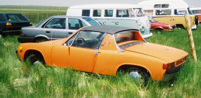

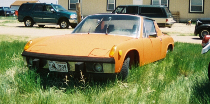

First off here is a little history on the car.
In 2002 I found this 1973 1.7 in a field outside Laramie WY where it had been sitting since 1982 with some other VWs.
After bolting on some webers and swapping out the battery, fluids, and tires I drove it out of there.
Click to view attachmentAs you can see she was pretty rough but other than some surface rust she was darn near rust free.

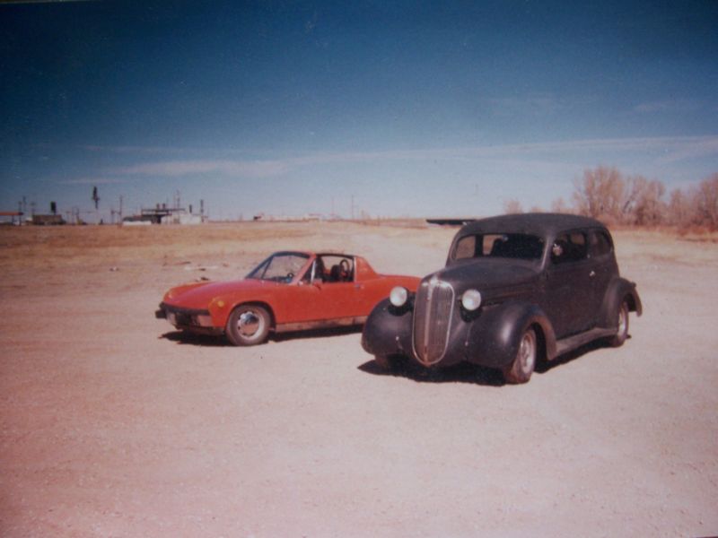

plymouth37
Jun 9 2008, 01:25 PM

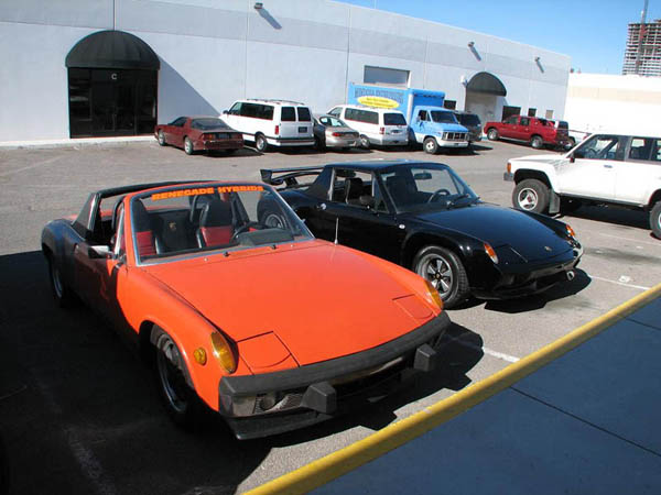

While in school I added a custom cage and interior both of which will be modified during the course of this project.
Here is a picture of the 914 about a month after I found it, next to it is my '37 Plymouth street rod.
As you can see I had already installed the rollcage when this picture was taken.

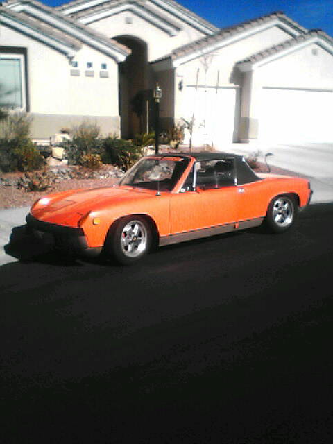

Click to view attachmentAfter school I moved to Las Vegas to work for Renegade Hybrids. This is when I really started upgrading the car.
Here is a picture of the car with stock body and drivetrain after I had installed the carrera front suspension and polished fuchs.

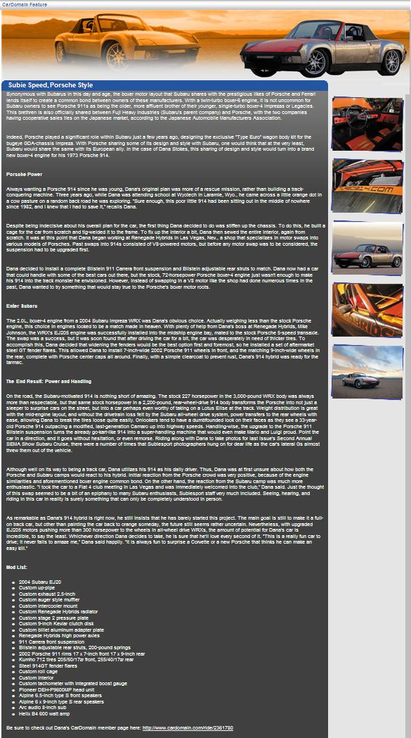

plymouth37
Jun 9 2008, 01:28 PM
The car has been featured by SubieSport magazine and by several online publications including Cardomain.
Click to view attachmentClick to view attachmentClick to view attachmentI drove the car in its subie powered form as a daily driver for about 2 years then decided to move to Wyoming to pursue a Mechanical engineering degree.

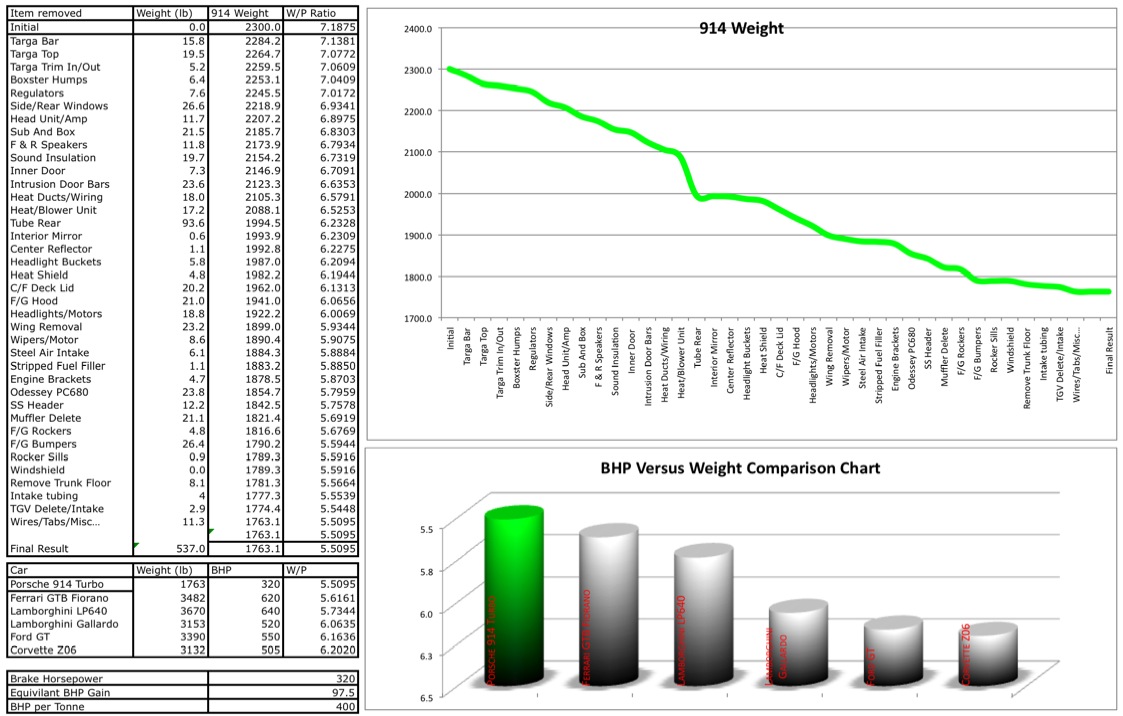

To keep track of my progress have been documenting my weight savings with excel.
Here is my spreadsheet showing the part removed or replaced, the resulting weight and power to weight ratio, along with the info from a few other cars for refrence. So far I have dropped just over 500 pounds.
I have a feeling this car will kill me if I ever get it on the road.

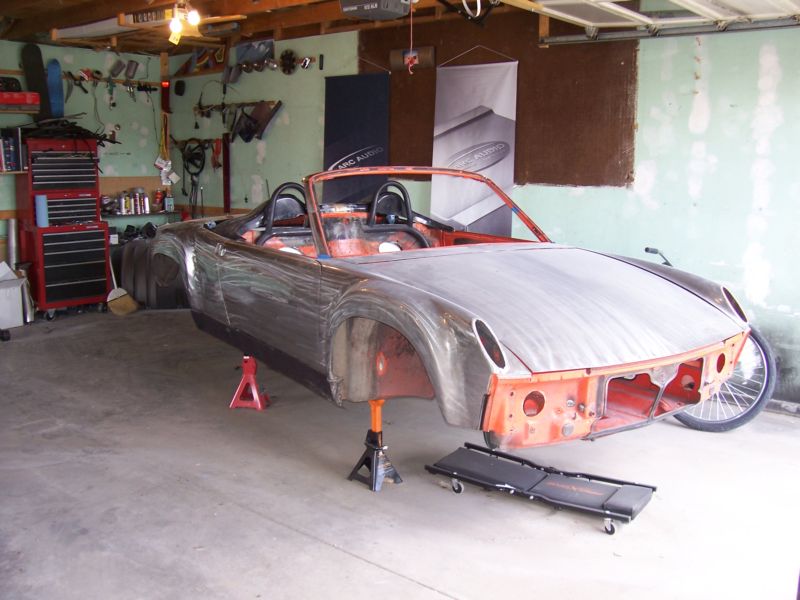

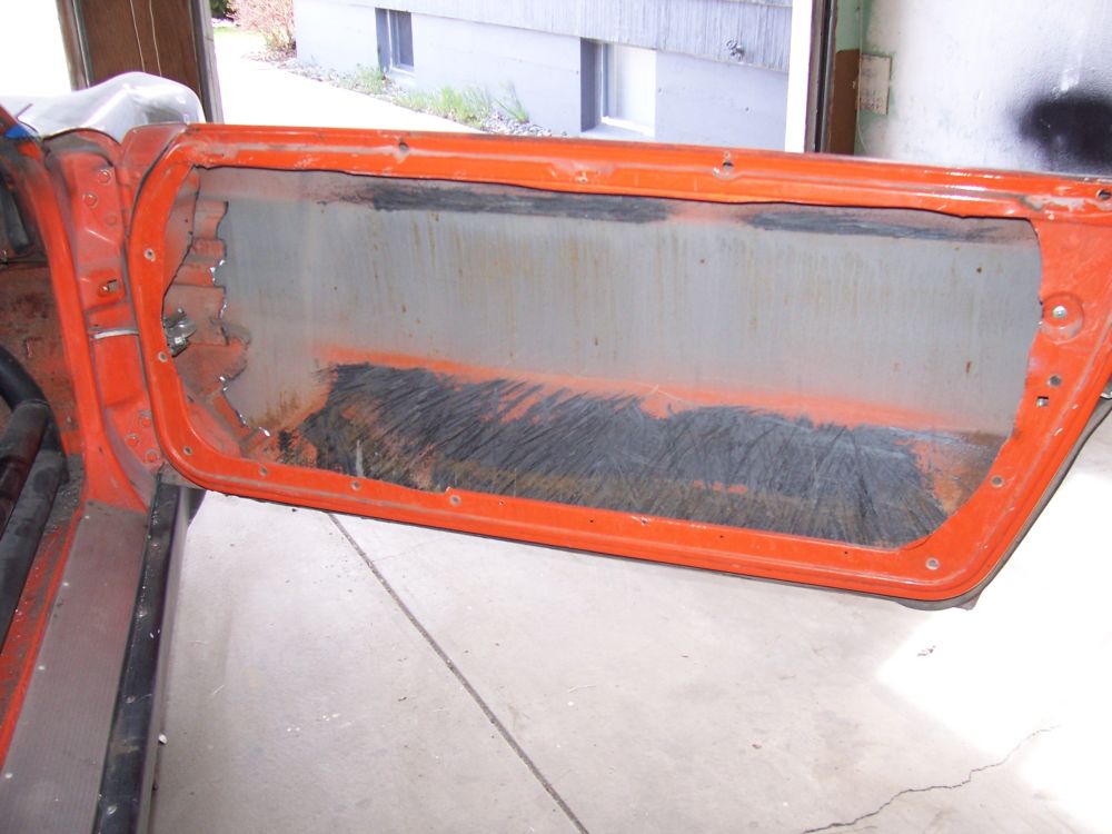

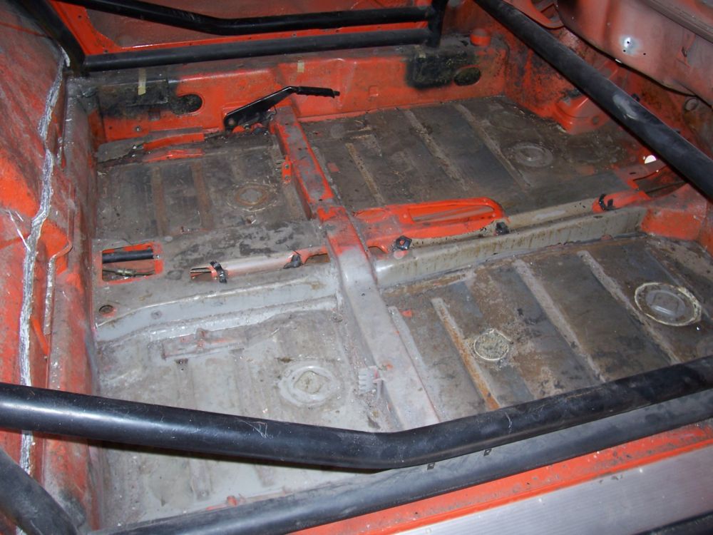

I finished scraping the tar out of the interior and gutted the pass side door.
I was glad to find very clean floors under the tar.

Wow those floors look great. I had just done that a few months ago and mine were not like that.

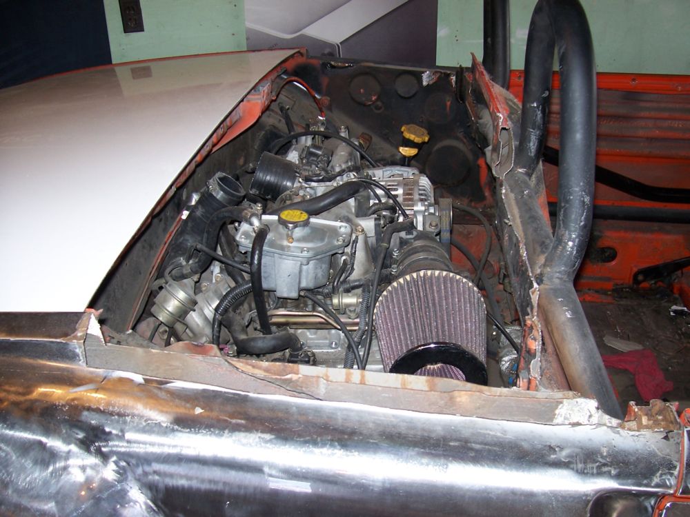

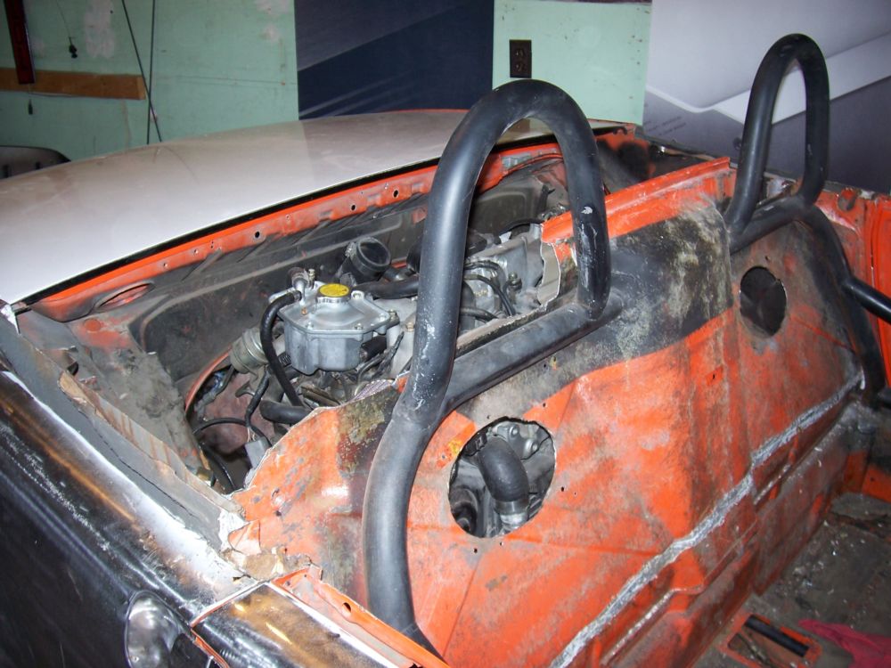

I cut off the targa bar and made this horrendous hole...
Click to view attachmentClick to view attachmentThe car is pretty much stripped but I am leaving the engine and tranny in for now so I can build the belly pan and design the intercooler system.

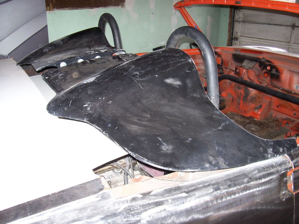

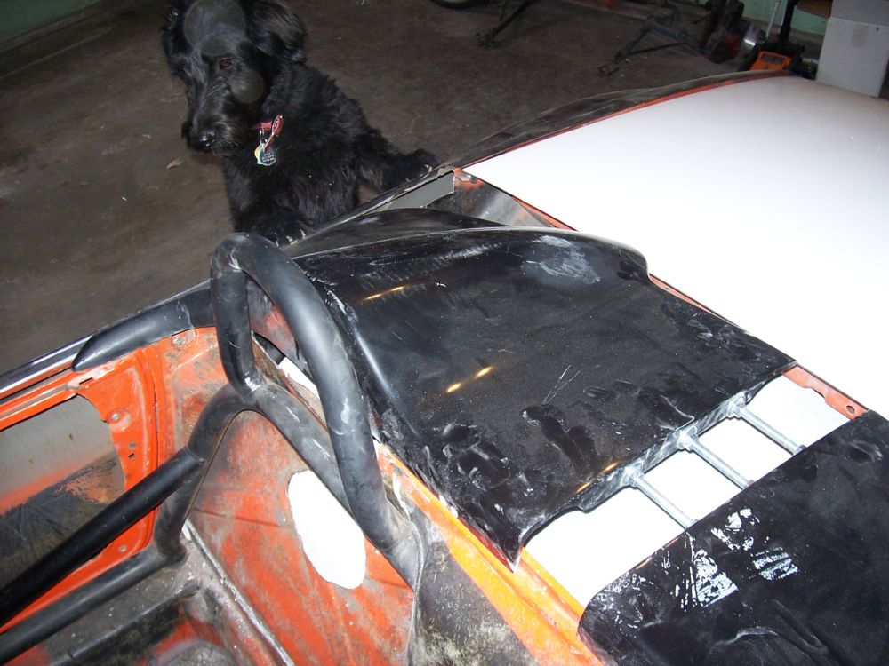

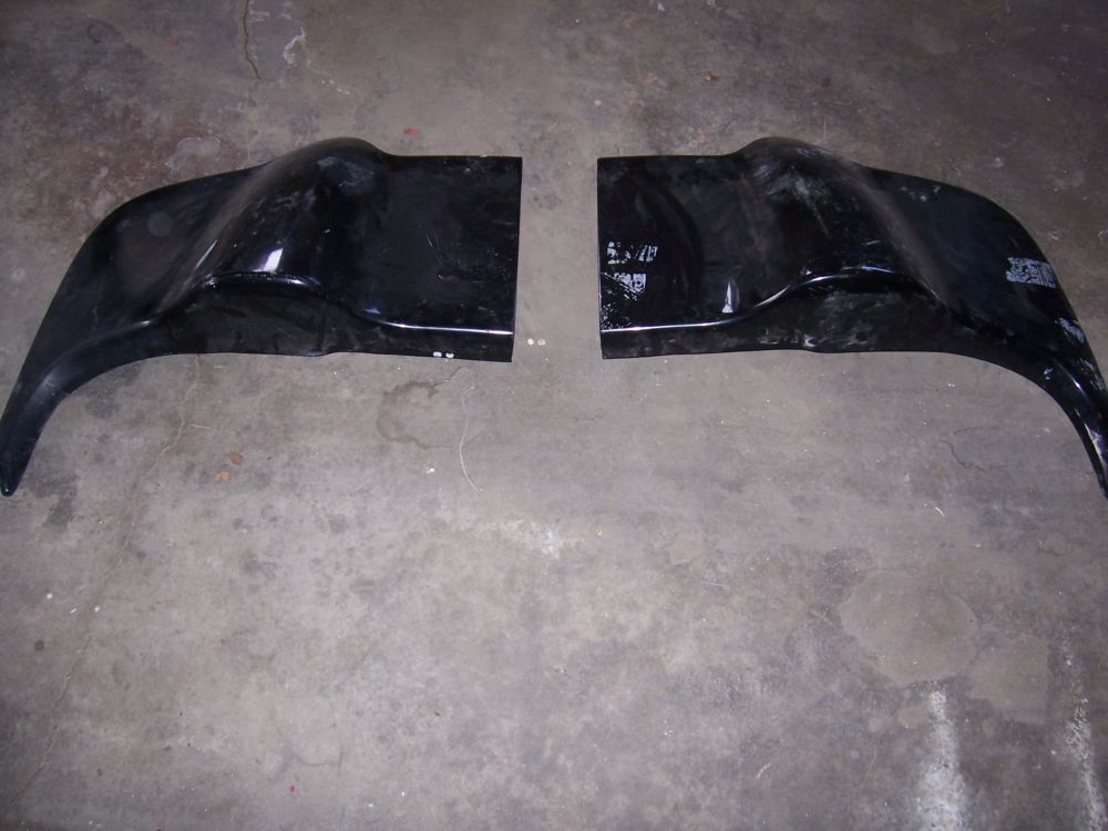

plymouth37
Jun 9 2008, 03:49 PM
I got a heck of a deal on these Boxster Humps. The plan is to 'glass these into one piece and build up the lid to match the rest of the car. Then I will rebuild the metal around the area. I absolutely hate working with F/G so I will make the metal match the F/G lid rather than vice versa.
Click to view attachmentMy dog Bailey checking the fit.
Click to view attachmentThis just might work!

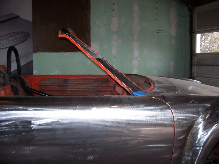

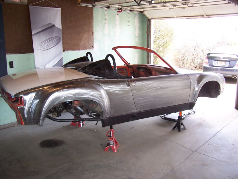

I raked the windshield posts back as far as the stock windshield allowed.
Next I will chop the windshield posts so the top of the frame is even with the top of the rollbar hoops.
I found a guy that will cut the stock glass to fit. Or cutting a lexan one is always an option if all else fails.
Click to view attachmentHere's how things are looking now.

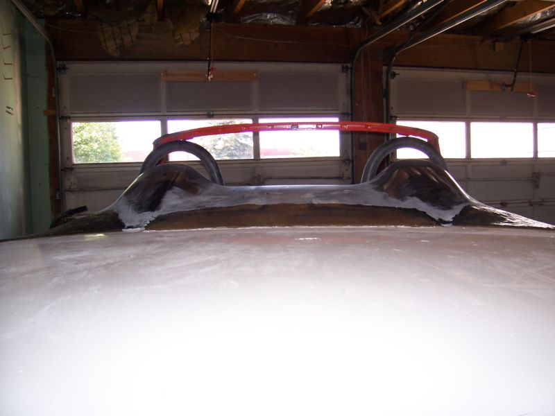

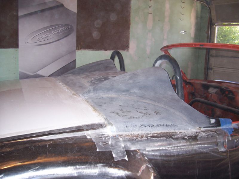

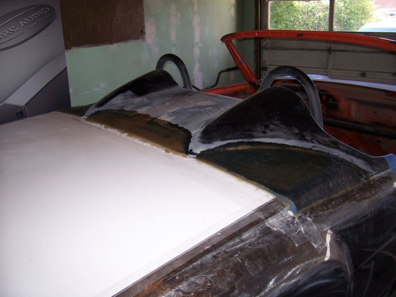

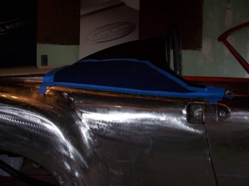

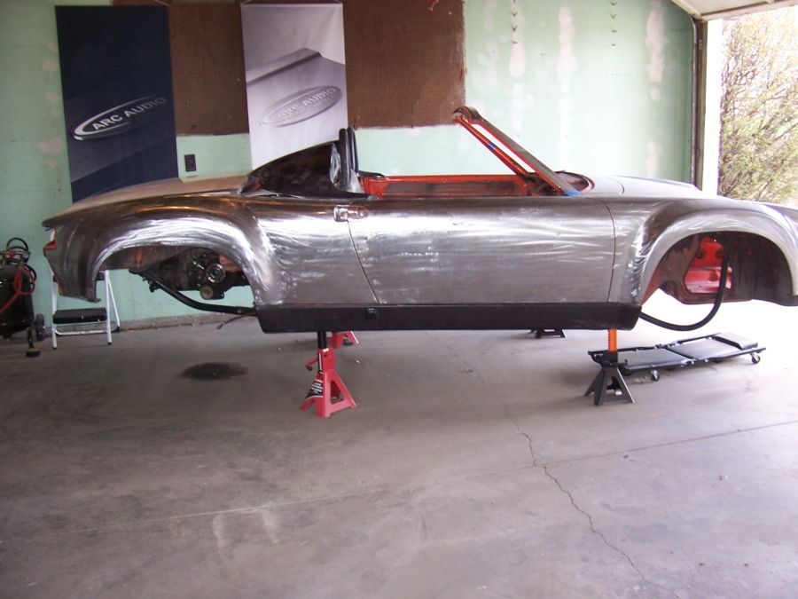

I started 'glassing the humps today and remembered how terrible fiberglass is to work with.
I 'glassed the two halves together and filled in the area at the back of the lid between the humps. Despite my total lack of skill I think it's coming along pretty well. It's a good thing I got these humps for cheap because the quality was terrible (good thing I am just cutting them up huh?)
Click to view attachmentTo blend in the sides I am stretching polarfleece and glassing it (a trick used by audio guys to build complicated sub boxes). The fleece creates really nice transitions and when covered by F/G cloth is really strong.
Click to view attachmentClick to view attachmentHere are some more shots of the car and the garage.
Click to view attachmentClick to view attachmentThanks for the support guys, this is gonna be fun!

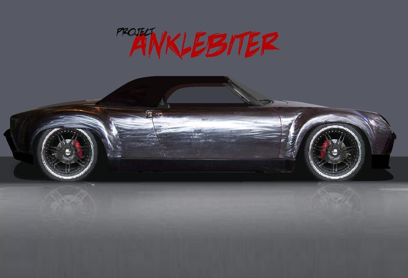

I was playing around with the concept of a lift off hard top with drop in windows.
It would be hard to build but it would really make the car alot more useable. We shall see...

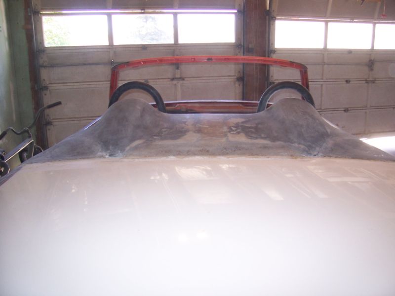

I added a layer of F/g last night:
Click to view attachmentClick to view attachmentI sanded the humps down this morning. There are a couple low spots but the shape is getting pretty close. I should be able to get it straight with one more glassing session, after that I will finish the bottom and edges.
PeeGreen 914
Jun 10 2008, 12:50 PM
Looking good
Rand
Jun 10 2008, 01:03 PM
Is that piece going to lift off or be hinged (for engine access)?
Are you keeping the retractable wing/brake widget, or is that gone now?
Nice work Dana. Loving this!
