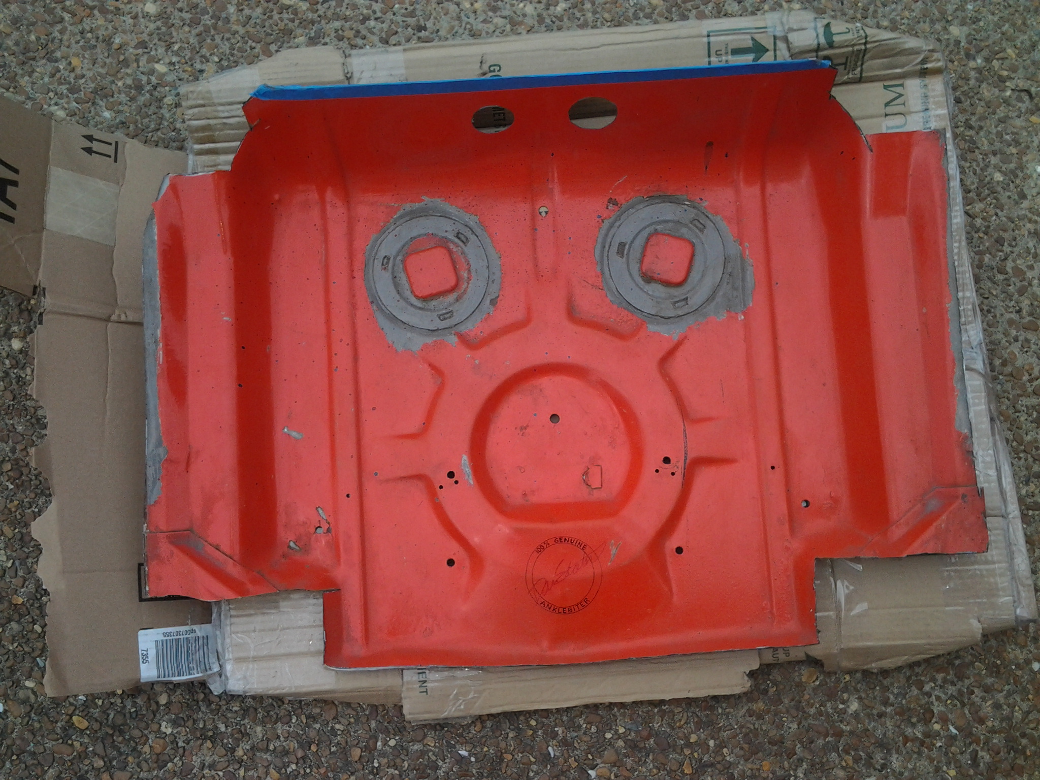

malcolm2
Jun 23 2012, 03:16 PM
QUOTE(malcolm2 @ Apr 18 2012, 08:56 PM)
QUOTE(plymouth37 @ Apr 17 2012, 10:02 PM)
QUOTE(malcolm2 @ Apr 17 2012, 08:56 PM)
Hey... PM sent. I can certainly use that trunk floor.
Thnks,
Clark
It is all yours, give me a day or two to box it up!
Awesome, Autograph is welcome. I'll do my best to keep it whole. I PM'd my number, just call and let's work out the details.
Clark

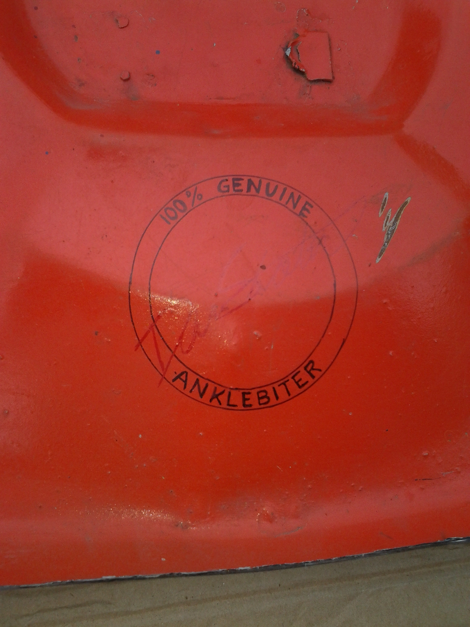

Thanks again....here is the autograph.
Click to view attachment Click to view attachment

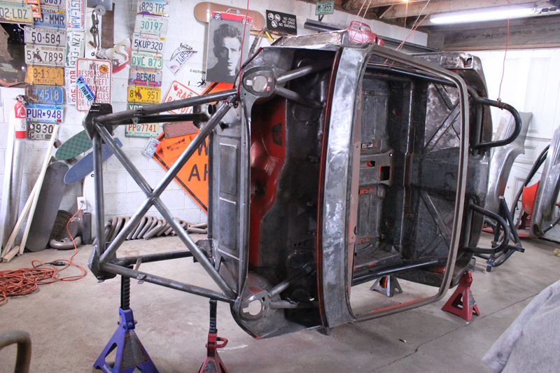

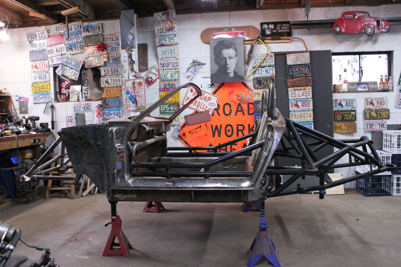

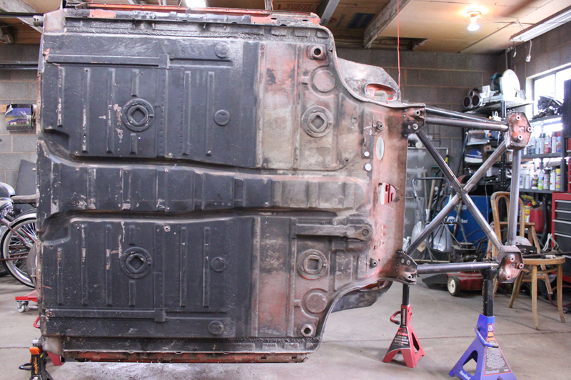

plymouth37
Jul 5 2012, 07:32 PM

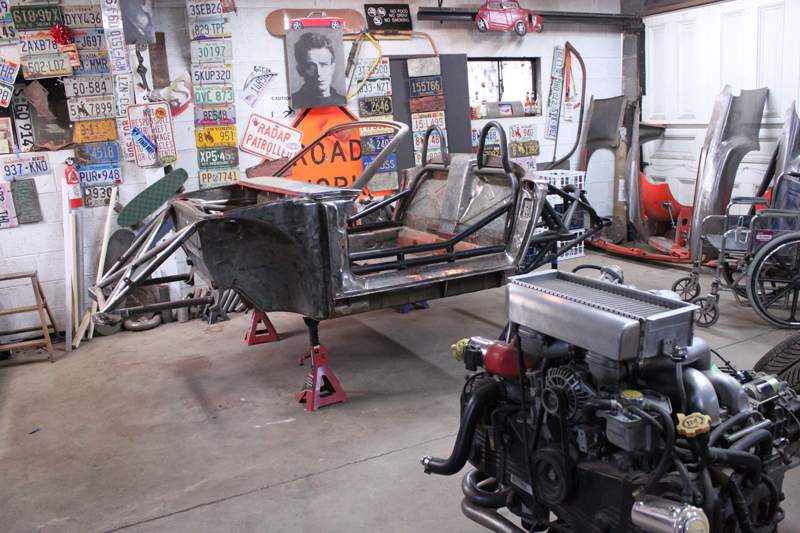

Today I broke down the car into its bare tub and rear chassis. I was surprised it only took a couple hours to pull the suspension, brake the car in half, and pull the engine.
With the extra time I gained I started stripping the remaining stock paint off of the tub in preparation for a couple coats of chassis primer and paint.
I like having a project you can lift onto jackstands with one hand...
Click to view attachmentClick to view attachment

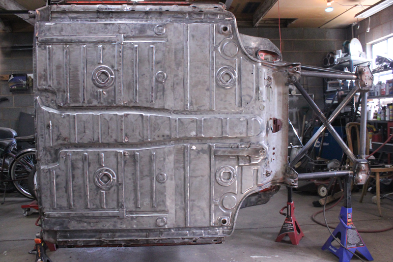

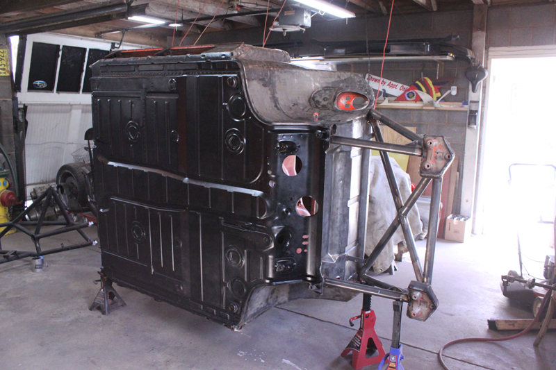

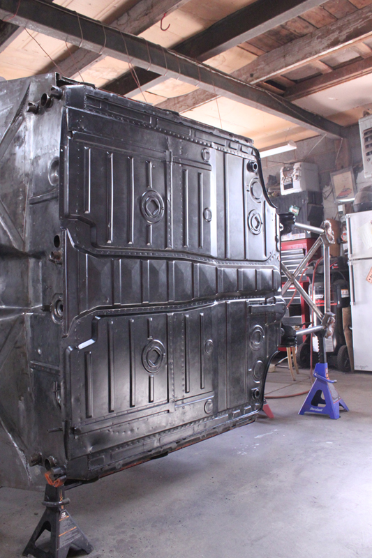

plymouth37
Jul 9 2012, 06:11 PM

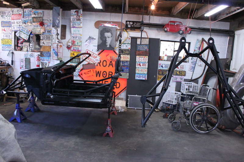

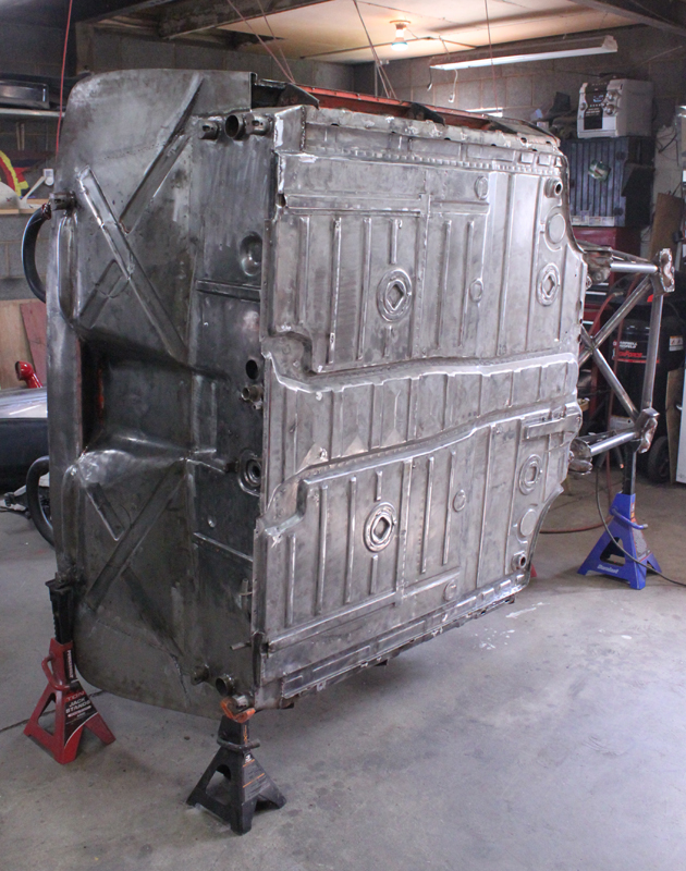

This morning I tackled the under side of the tub. Using every jack, jackstand, and a system of levers and pulleys I got the tub resting on its side with minimal "sketchiness".
To lower the murphie's law factor I anchored the tub to the I-Beams holding up the rafters. It is actually pretty solid and makes working on the belly of the car really nice.
Click to view attachment Click to view attachmentI started out by stripping off all of the old paint, then welded up the forty or so holes I had drilled in the floor to mount the old water lines and after market rockers.
Click to view attachmentClick to view attachmentFinally I sprayed on the first coat of primer. I am using the Eastwood chassis black paint system, I used it on a couple cars when I worked at Renegade, it is tough as nails and looks pretty good too. After this first coat I will apply a second coat of primer, then 2 finish coats of satin black.

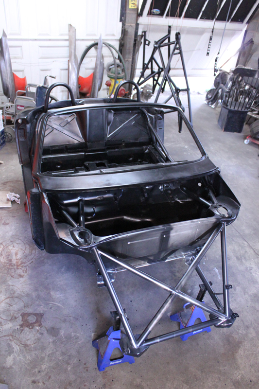

plymouth37
Jul 10 2012, 07:01 PM

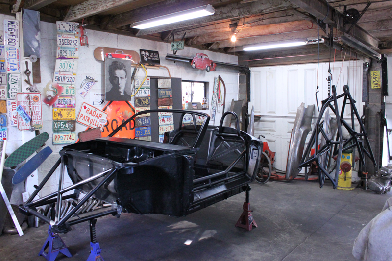

I prepped and primed the tub and the rear tube frame today. Paint goes on tomorrow!
Click to view attachment Click to view attachmentClick to view attachment

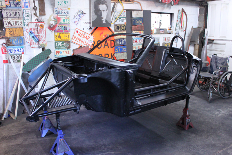

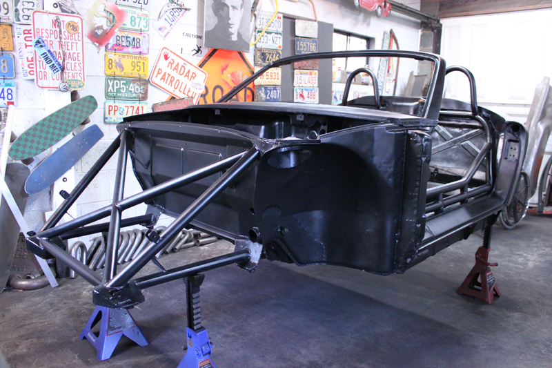

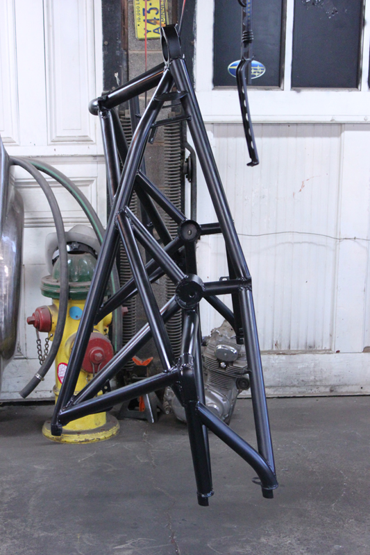

plymouth37
Jul 11 2012, 08:07 PM
Satin black chassis paint is on! I found it sprays the best reduced by about 20%, I put on 2 light coats and got the coverage I was looking for.
I turned the heater in the garage up as far as it goes and will leave it to bake overnight.

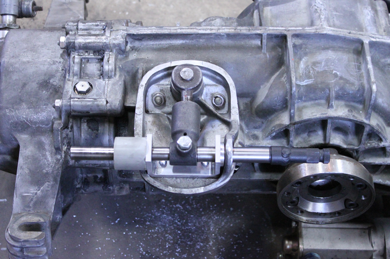

plymouth37

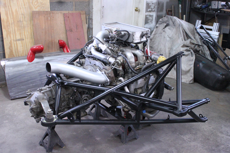

Jul 18 2012, 06:37 PM

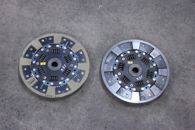

I did a bunch of little tasks to get the engine ready to install.
First I replaced my thoroughly melted clutch and reinstalled my freshly turned flywheel.

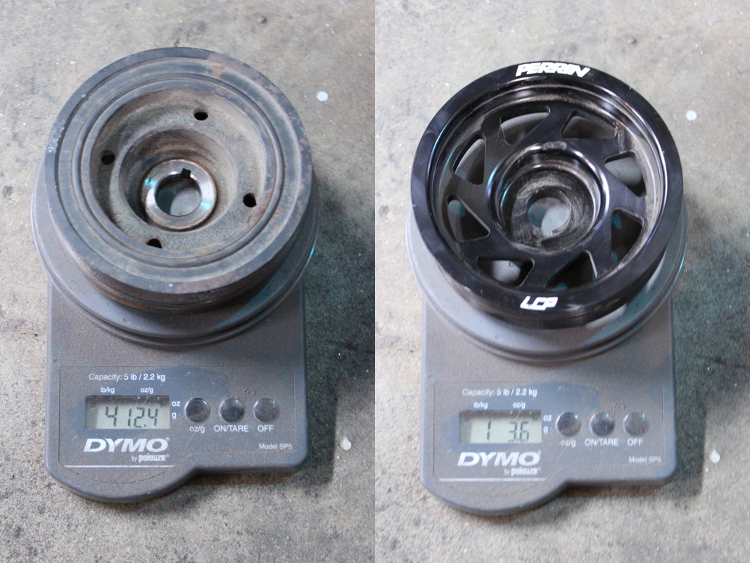

Click to view attachmentThen I installed a new Perrin light weight pulley, this took 3lbs 8.8oz off of the rotating mass of my engine, that aught to change it's revving characteristics!
Click to view attachmentNext I installed the rear piece to the JWest shift linkage.
Click to view attachmentFinally I mounted the rear tube chassis to the drivetrain. I even miraculously avoided scratching the new paint!

QUOTE(plymouth37 @ Jul 18 2012, 05:37 PM)
Click to view attachmentBeing a Suby guy I would keep the factory one on it works as a great harmonic balancer, for the little differance you feel from the Perrin it's not worth the relaibility issue's you "WILL" have. Even with a B & B engine I still think the factory one is the best option. I know it's really easy way to drop some weight especially on a rotating mass but sometimes weight can be a benefit.

QUOTE(Dasnowman @ Jul 18 2012, 09:27 PM)
Yeah, I have read the thousands of arguments on nasioc.com
Here is a good one regarding the aftermarket pulleys, some guys (myself included) are of the opinion that they are safe to use, some guys think the engine will grenade if you remove the stock one. I have a couple friends with over 50k miles on their pulleys without experiencing problems, hopefully I will be as lucky as they have been. I figure I will try this one out and if I am not happy with it I can always swap back, thanks for the advice!
Mike Bellis
Jul 18 2012, 10:54 PM
Less rotating mass is cool to a point. My rotary setup has a lightened flywheel. It gets a little "jumpy" at low speed low throttle driving. A heavier flywheel would help prevent this but would make the wind up slower.
There are pros and cons to rotating mass, especially when our cars are so light...
plymouth37
Jul 18 2012, 11:01 PM
I think this is one of the components that I will just have to wait until the R&D portion of the build to see if I like it.
Right now I am sticking to the theory that lighter is better, if my driving experience starts to tell me otherwise I will reevaluate.
