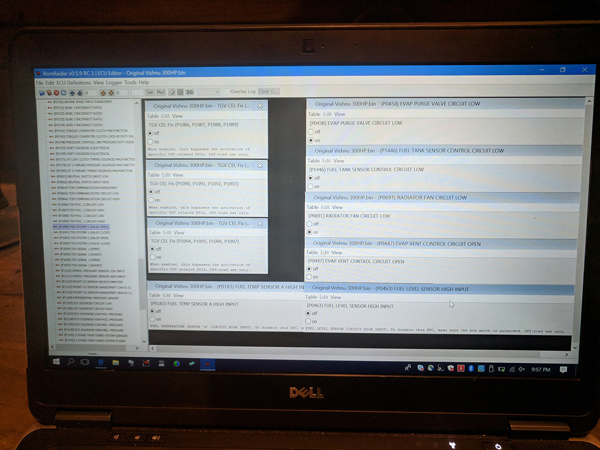

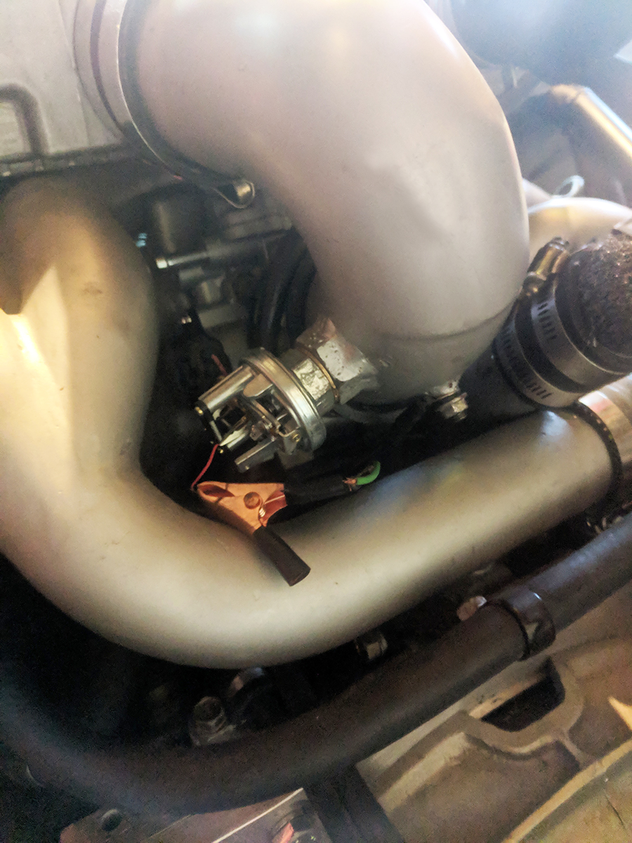

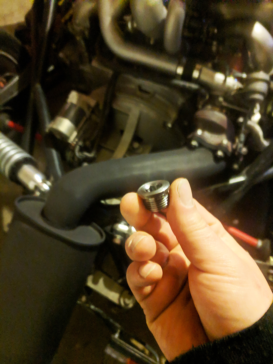

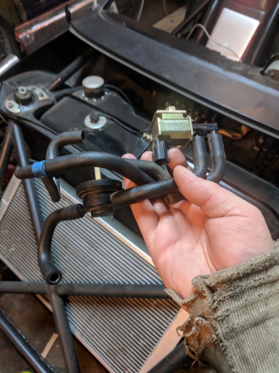

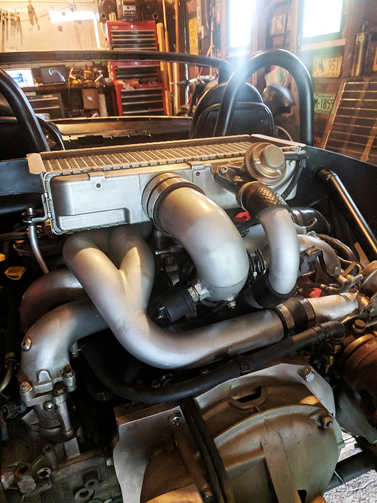

As I was plugging up my intake to pressure test it I started to ask myself what all of these vacuum hoses and controllers were in there for. Turns out these are part of the emissions system that purge the charcoal canister on the gas tank, the little doohickey is the purge valve, needless to say I don't have any canister or emissions anything so I gutted everything and capped the intake nipples, I was rewarded with the code "P0458 EVAP Emission System Purge Control Valve Circuit Low" but it doesn't throw it into limp mode so I will just add it to my list of codes to have programmed out when I get the ECU tuned. Less crap on the engine is a win for me!

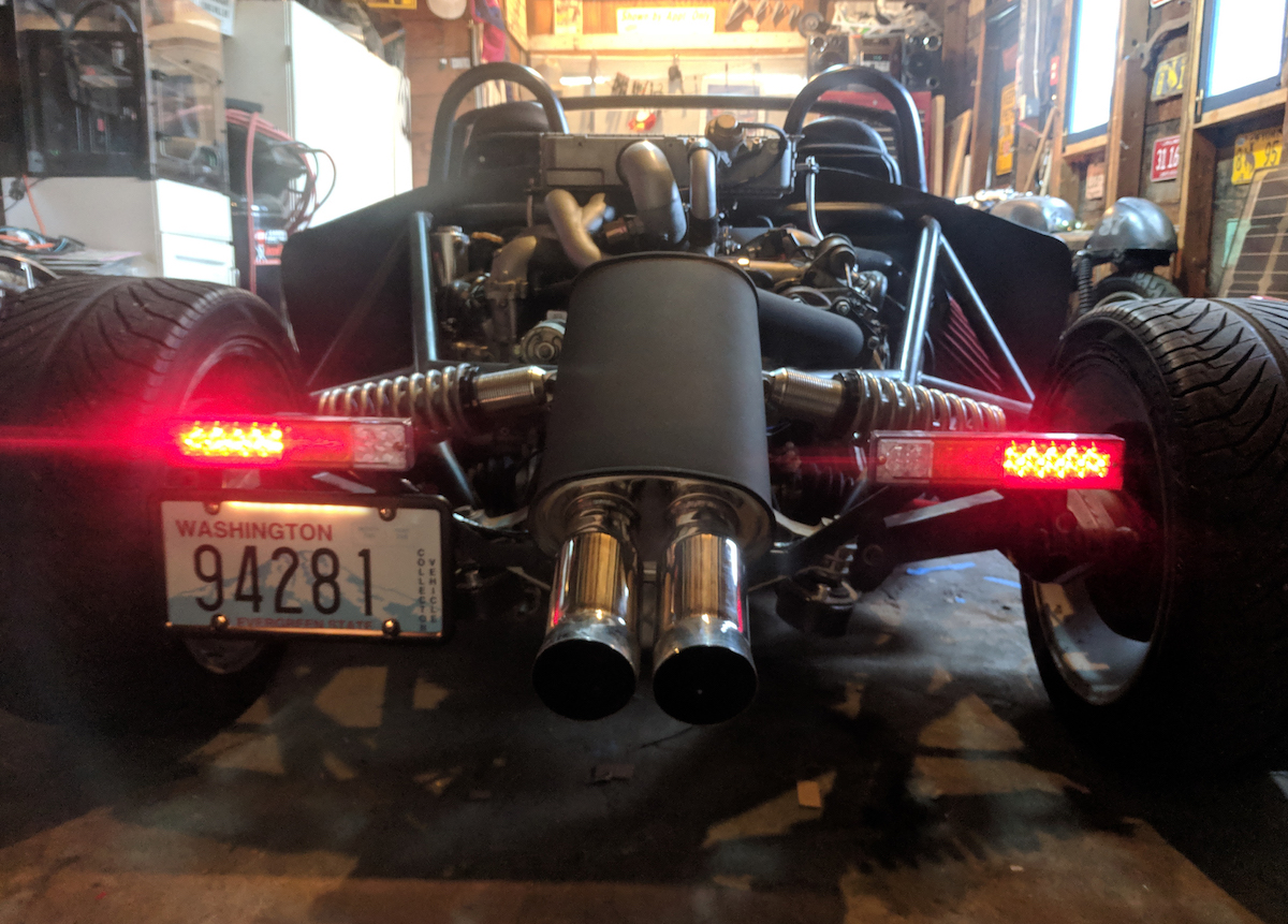

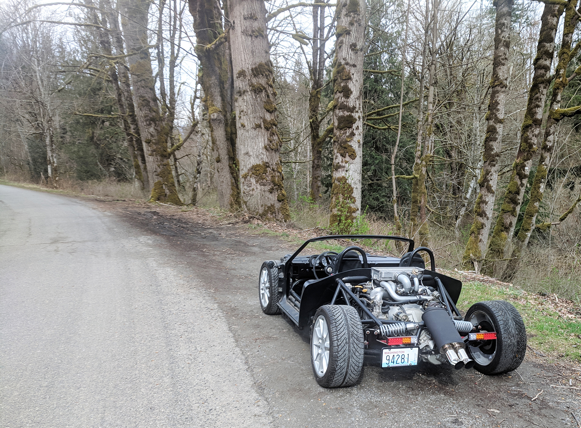

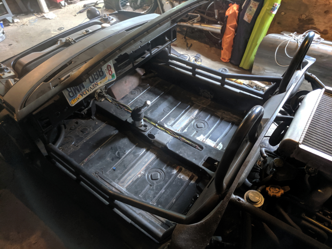

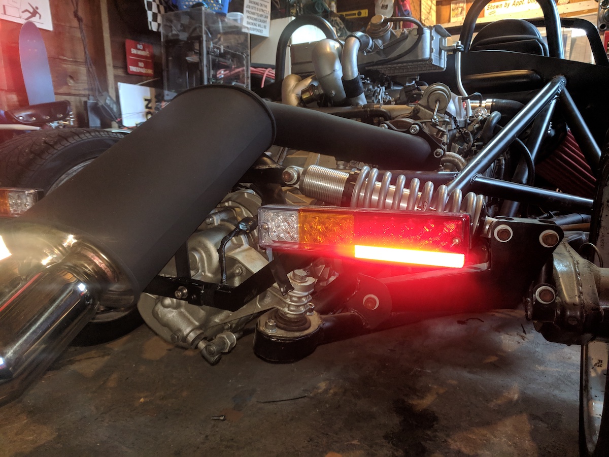

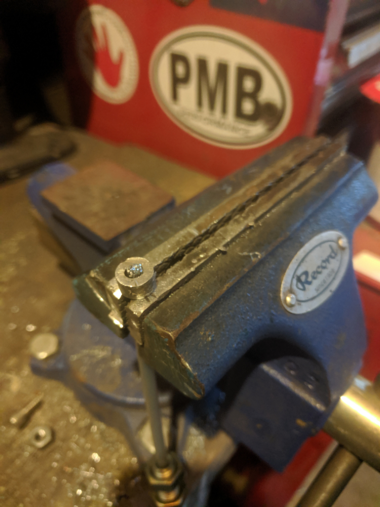

Click to view attachmentSpeaking of taillights from the earlier conversation, when I put in the muffler it eclipsed the spot I had made for the license plate, zipties weren't cutting it for Mr. Officer so I welded up a little bracket and hacked in some led lights into a license plate frame. There, that's legal too.

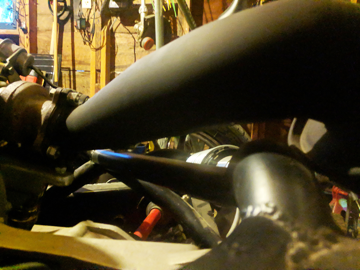

Click to view attachmentFinally the trailer lights i got didn't have reflectors which isn't legal, so I got some reflective tape on Amazon for $3 and stuck a strip on the lights, Check that one off too.

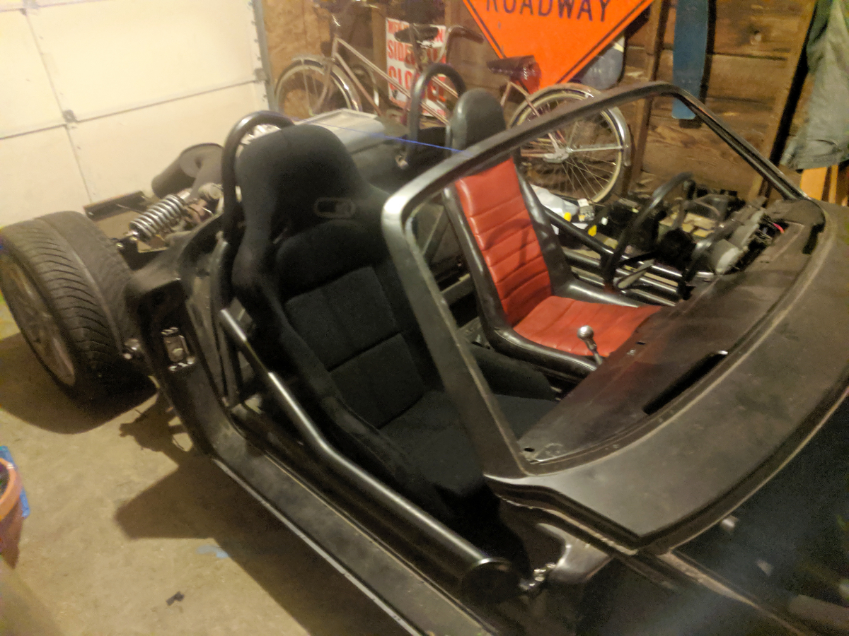

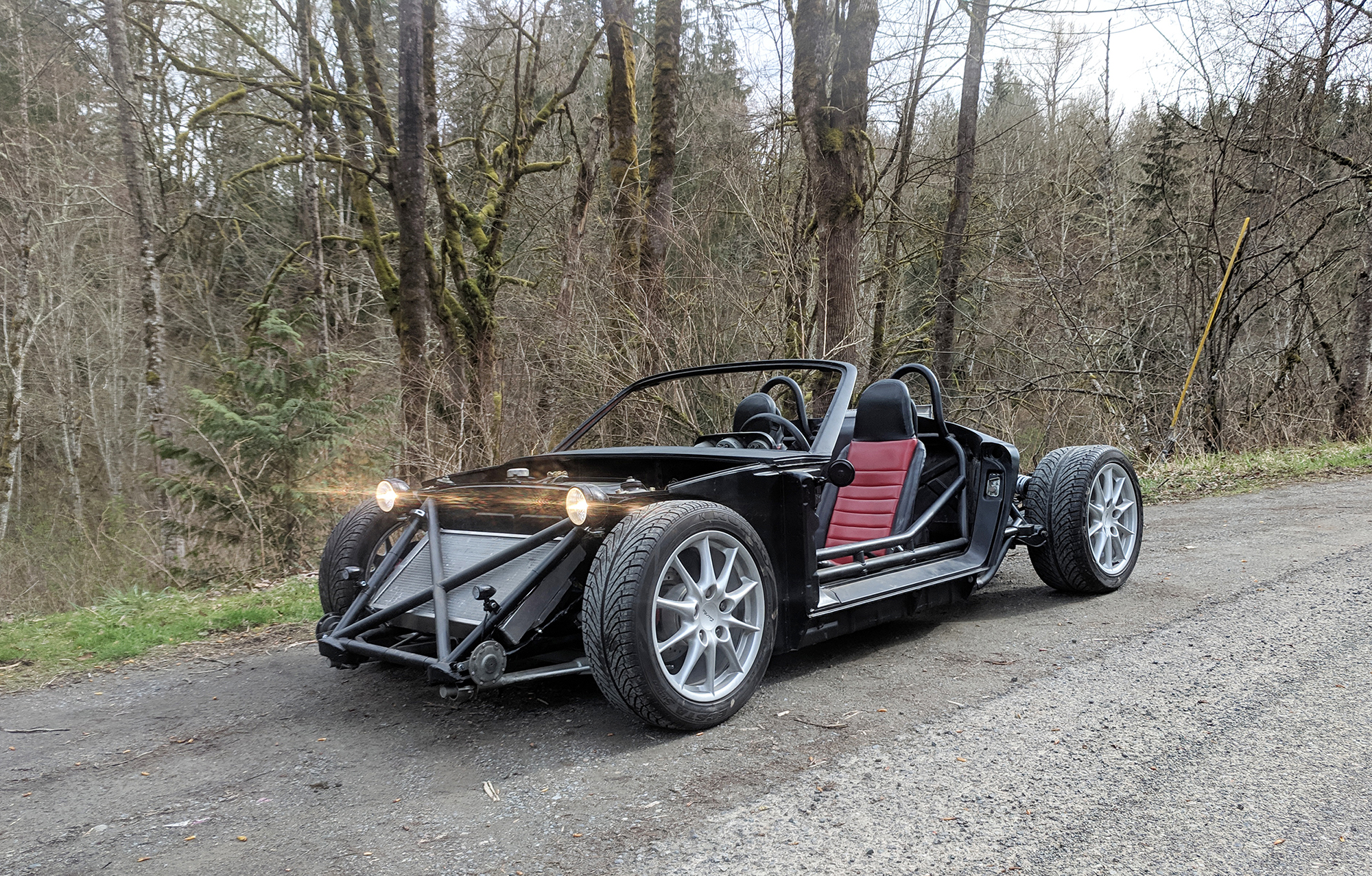

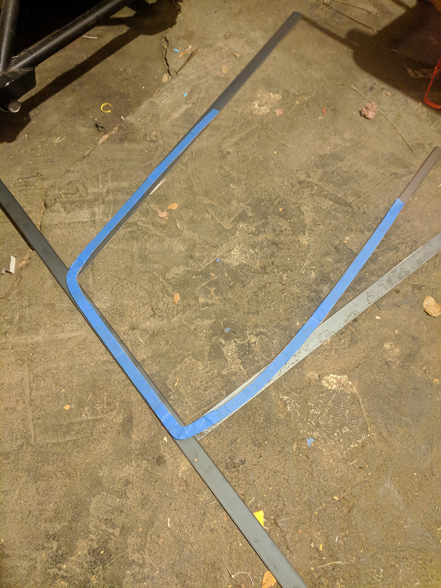

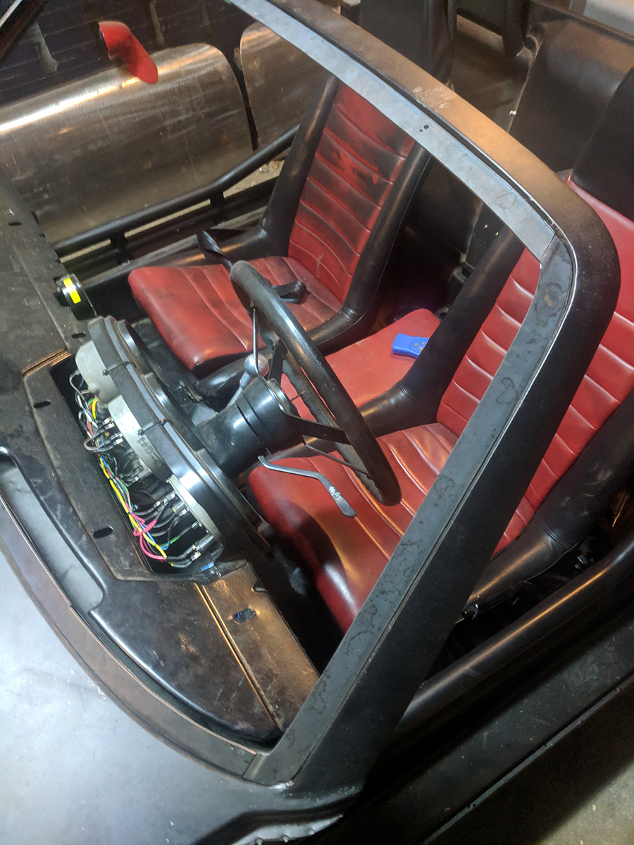

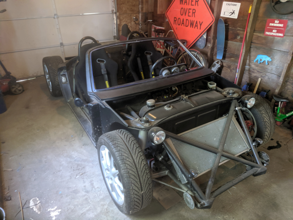

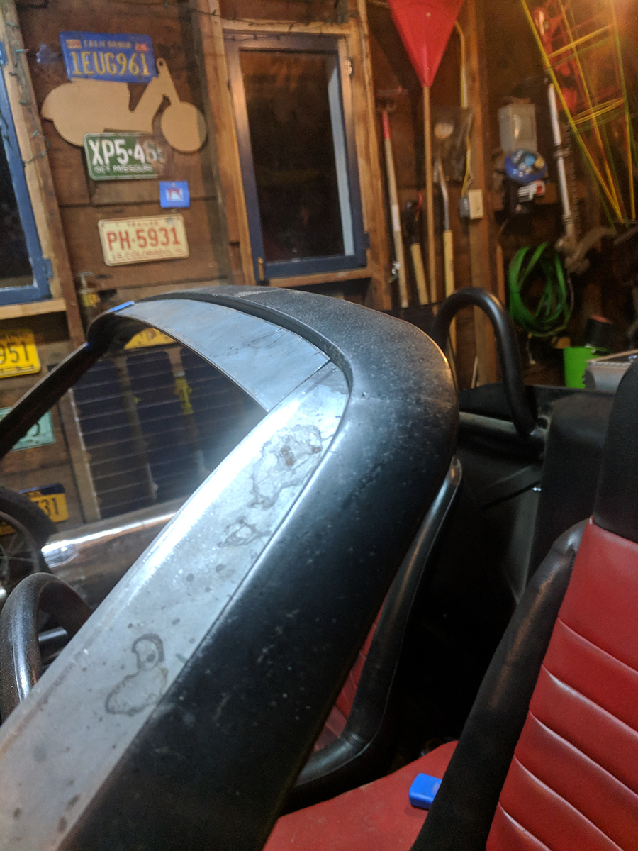

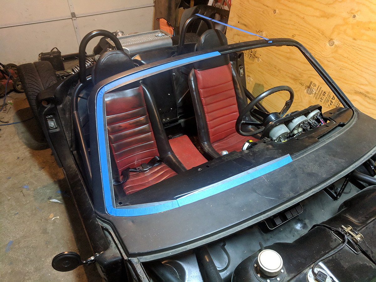

Click to view attachmentI think I do actually legally need doors, the law is pretty explicit about that, despite the plethora of doorless Jeeps that I see all over the place. Being the sitting duck that i am and that I guess the ultimate goal is to have a body on this thing eventually I am going to clean up and paint the doors next, stay tuned!
