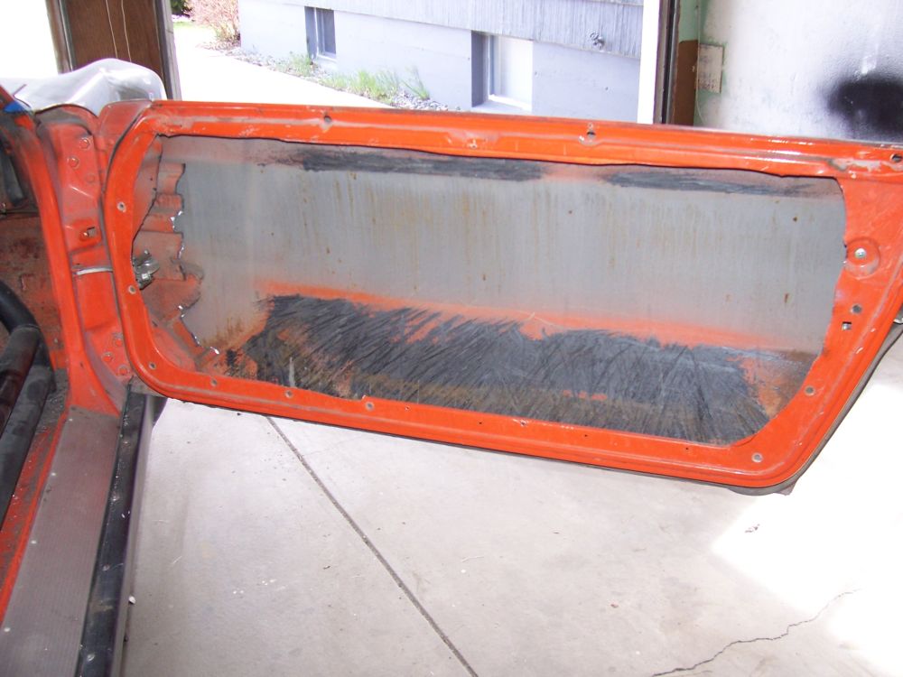

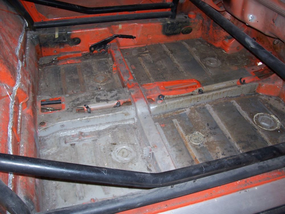

I finished scraping the tar out of the interior and gutted the pass side door.
I was glad to find very clean floors under the tar.

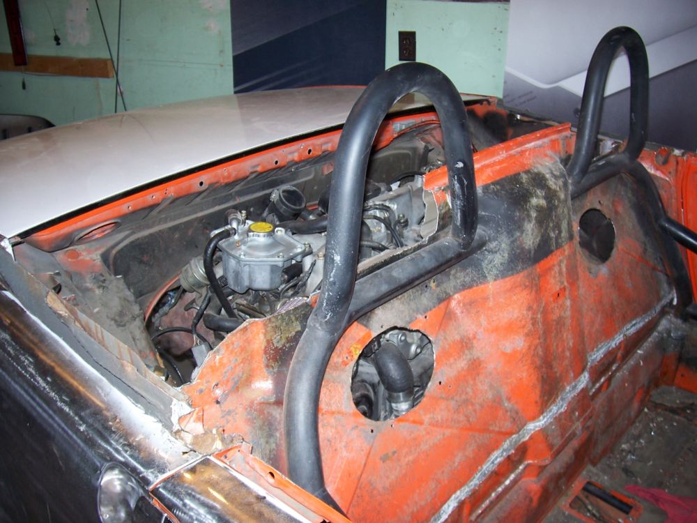

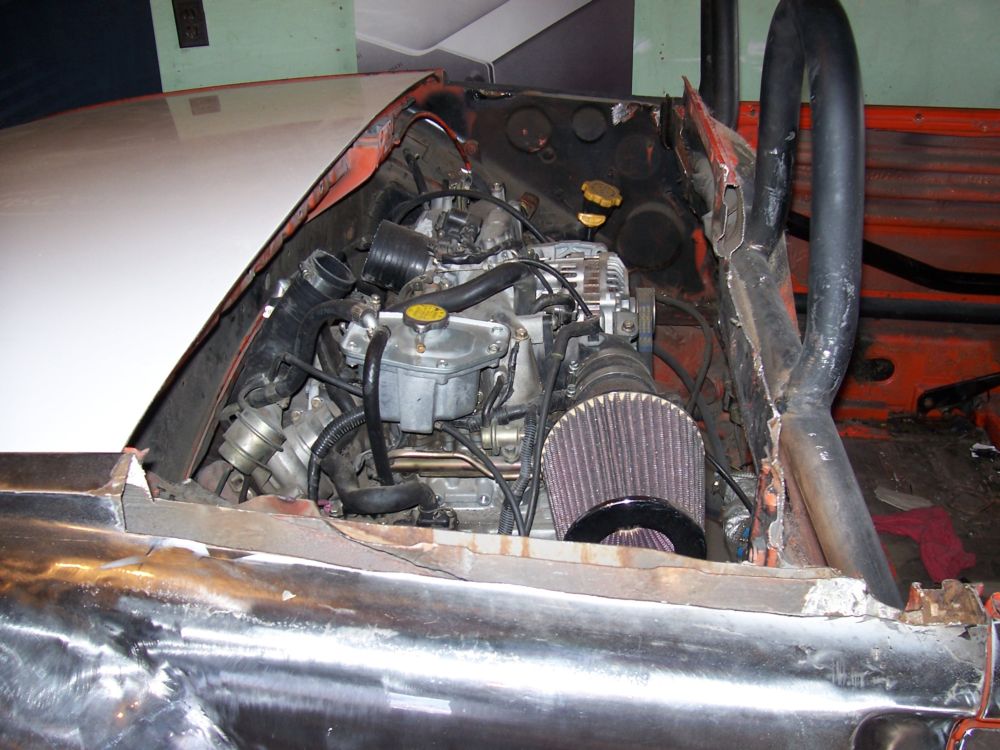

No turning back now!
I cut off the targa bar and made this horrendous hole...
The car is pretty much stripped but I am leaving the engine and tranny in for now so I can build the belly pan and design the intercooler system.

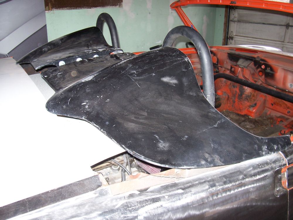

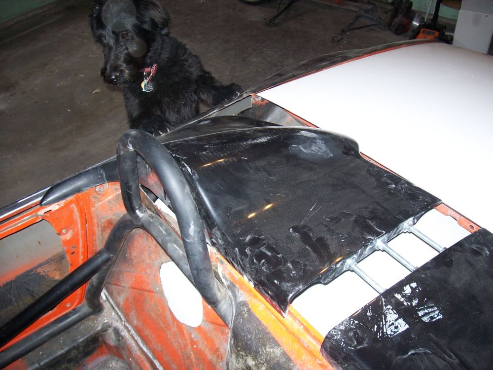

plymouth37
post Jun 9 2008, 03:49 PM
Posts: 1,825
Joined: 24-May 05
From: Snoqualmie, WA
Member No.: 4,138

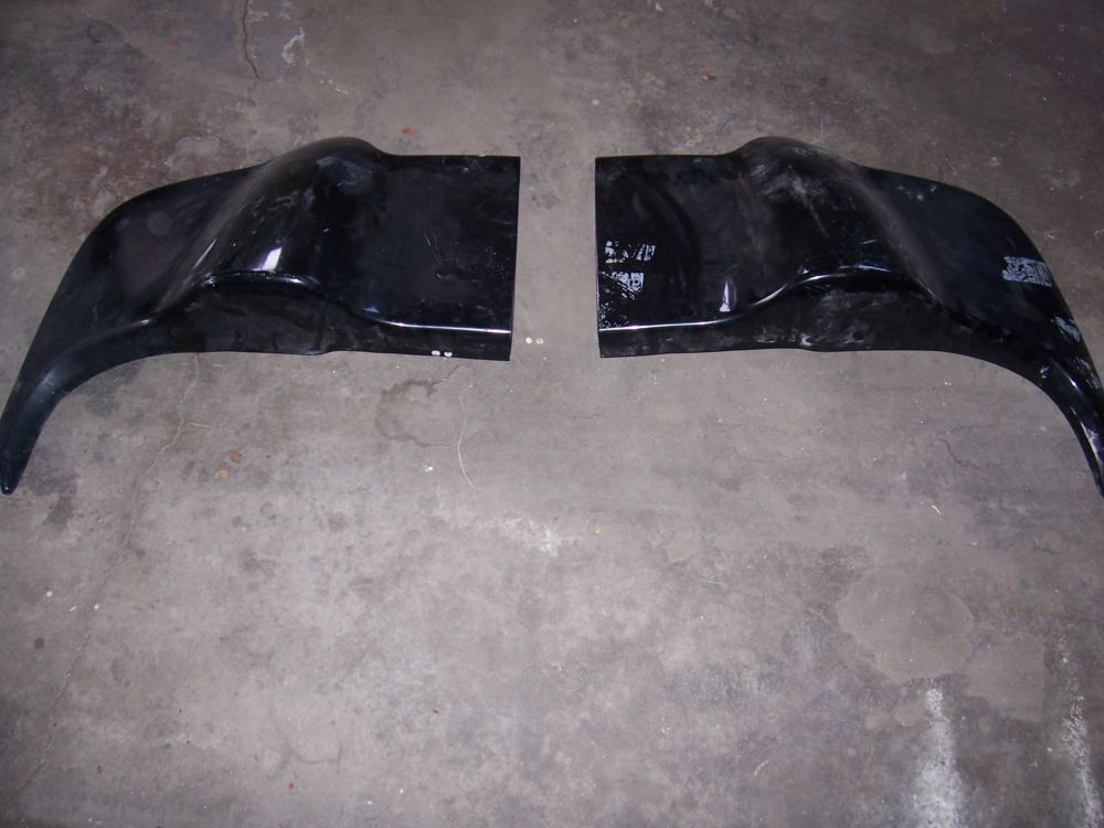

I got a heck of a deal on these Boxster Humps. The plan is to 'glass these into one piece and build up the lid to match the rest of the car. Then I will rebuild the metal around the area. I absolutely hate working with F/G so I will make the metal match the F/G lid rather than vice versa.
My dog Bailey checking the fit.
This just might work!
