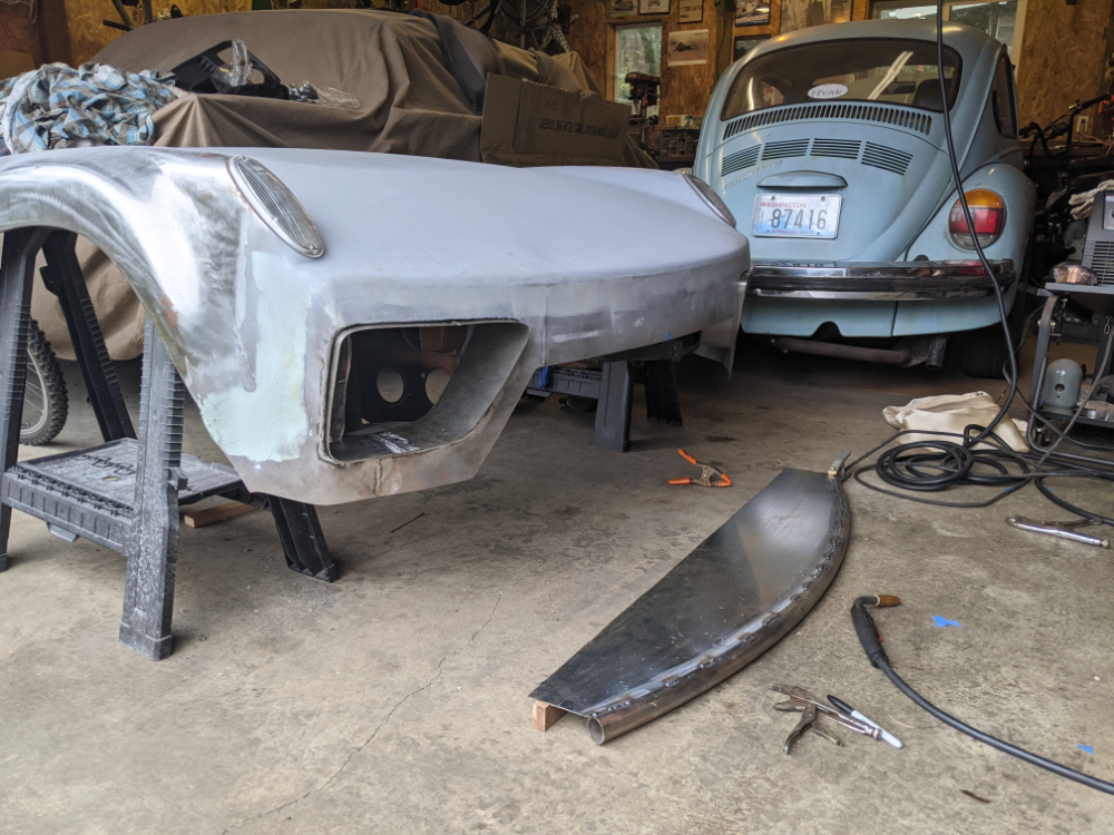

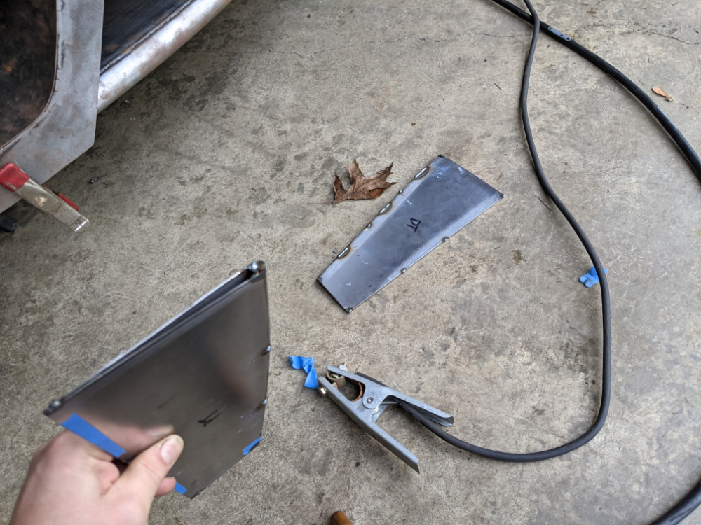

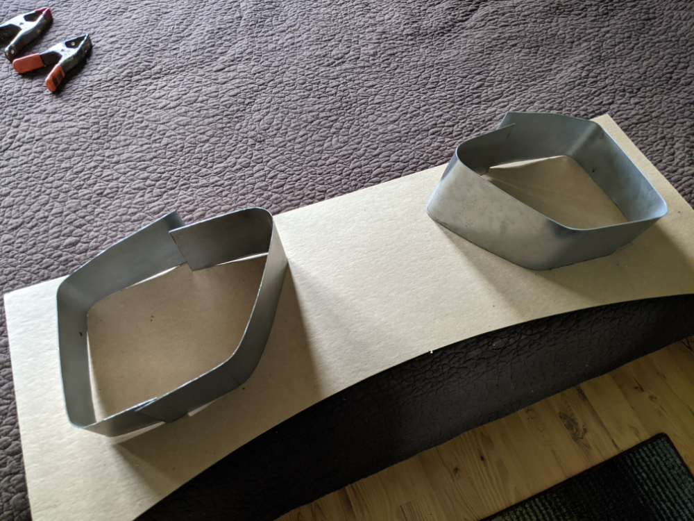

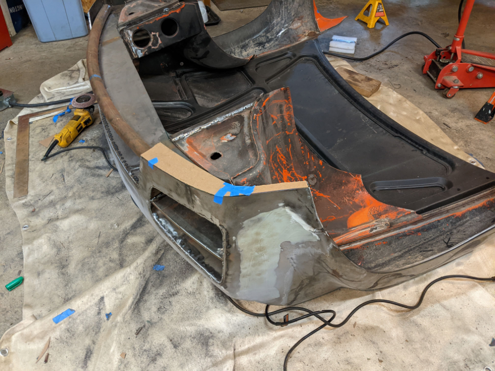

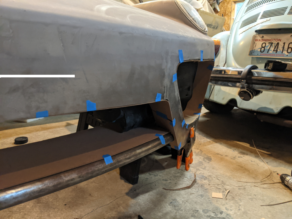

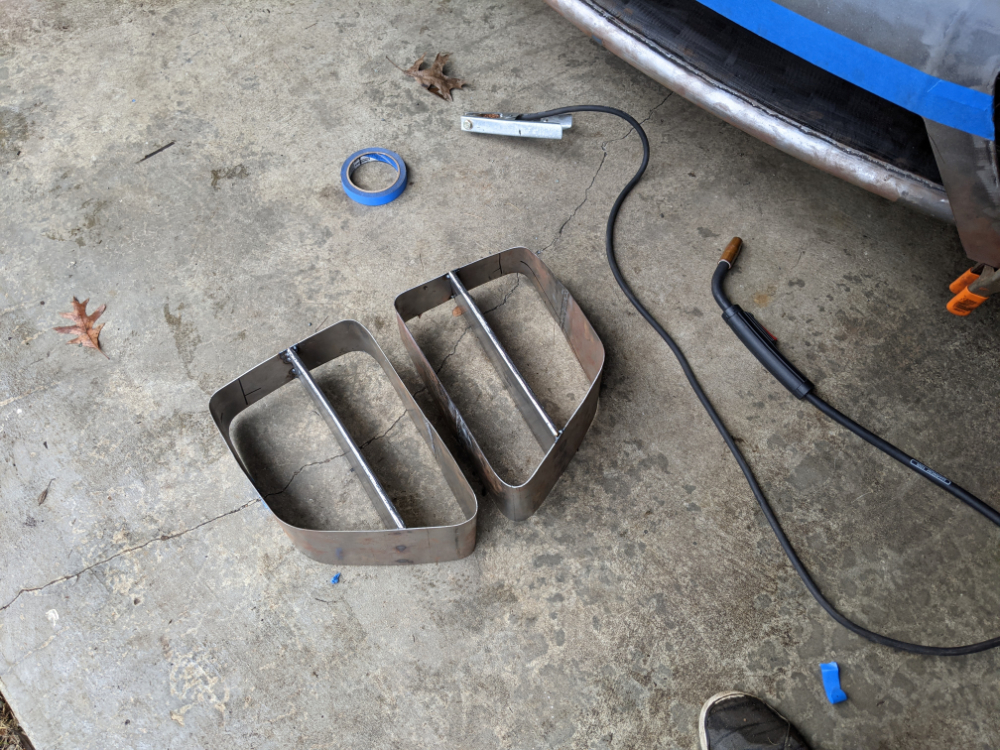

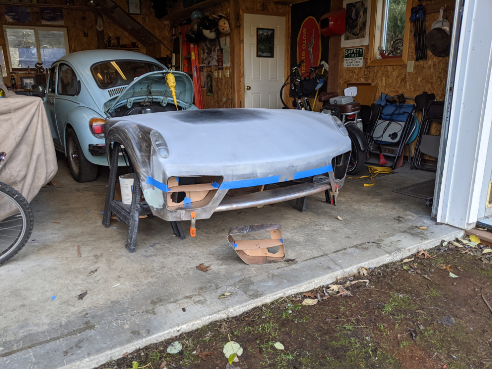

Time to make templates for the openings.
Here is a quick mockup.
Transfered my templates to steel.
And formed the side grill buckets

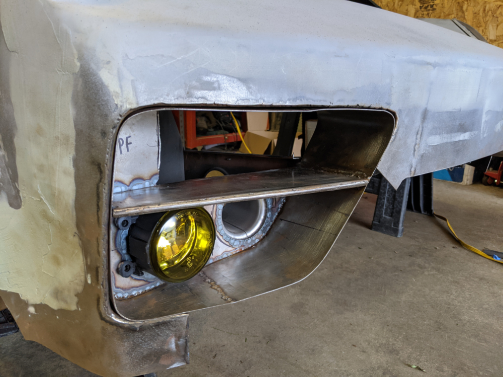

Test fit the side buckets and welded the center grill plate onto the lip bar as well.

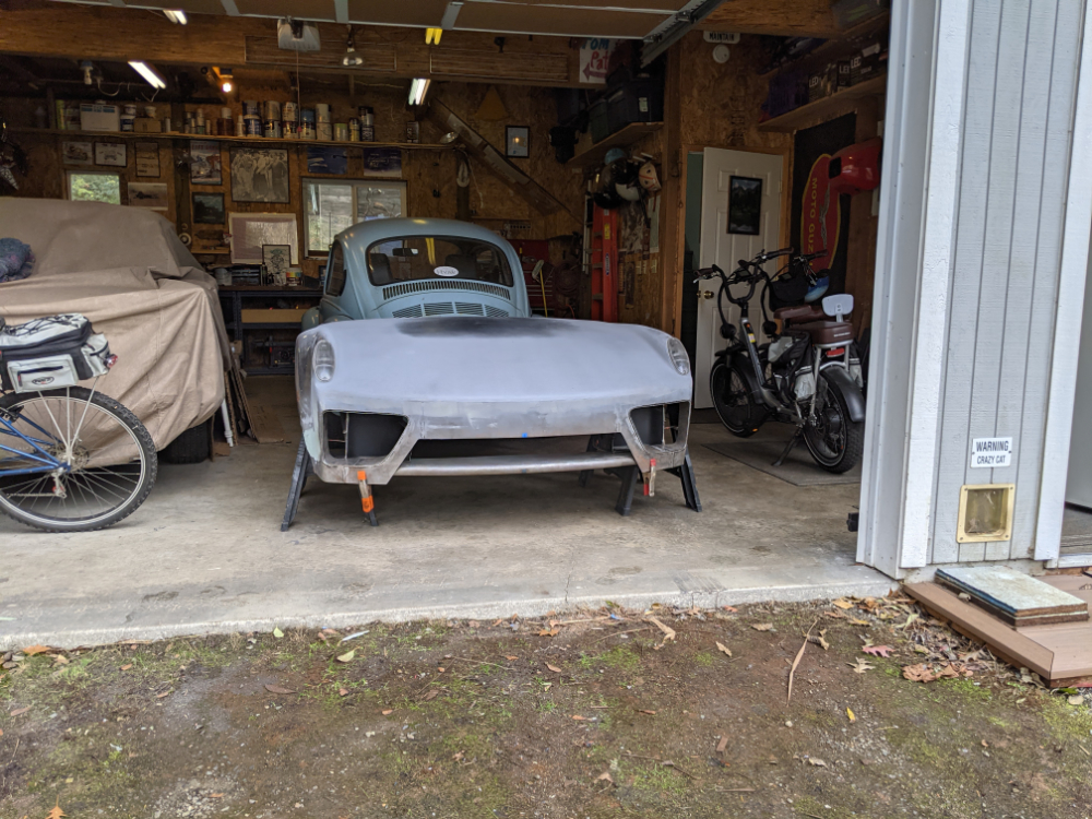

plymouth37

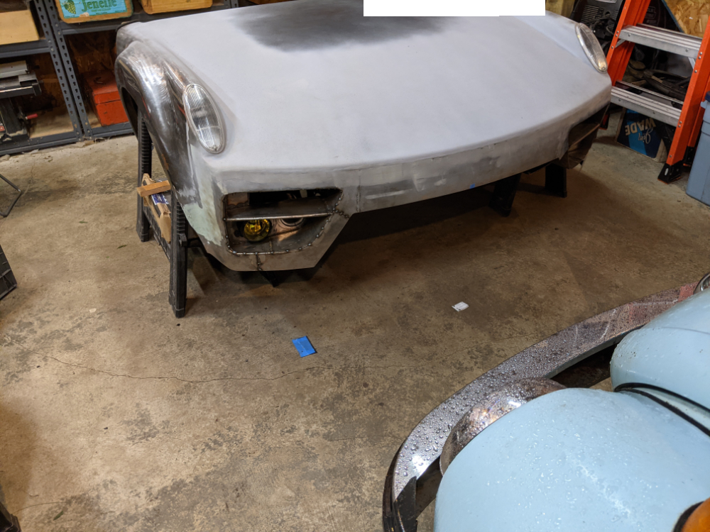

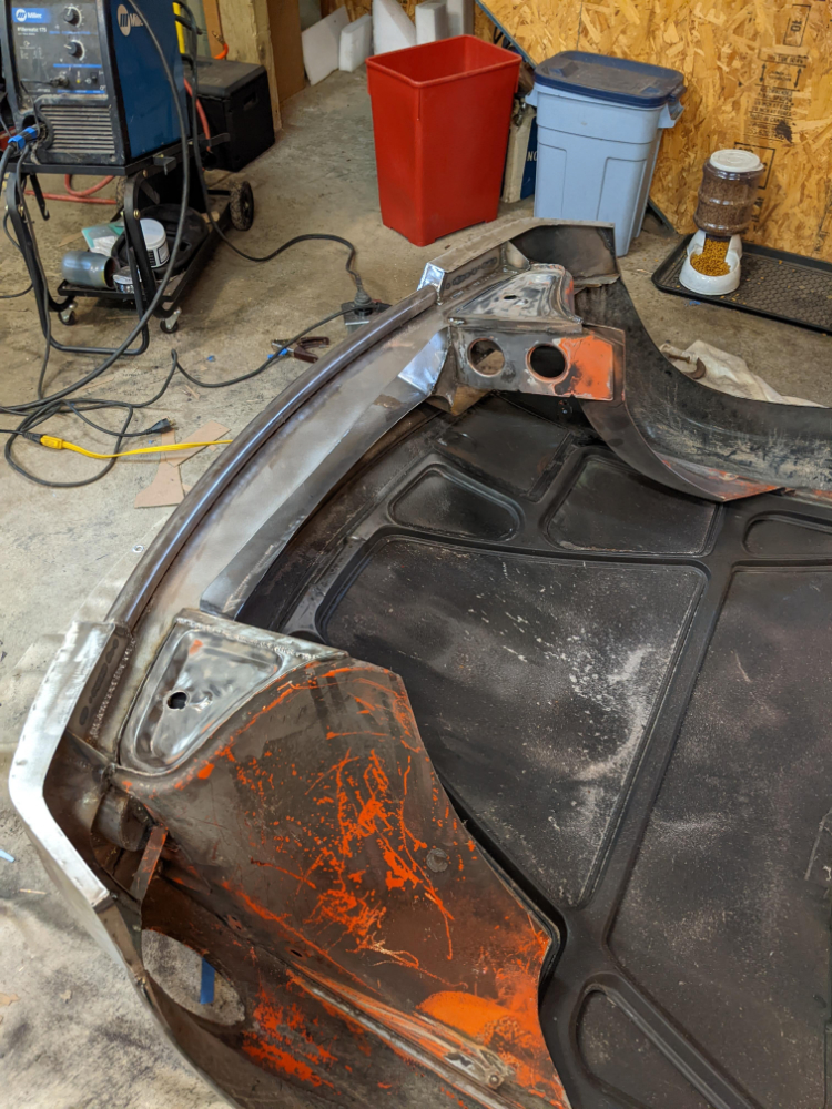

Here it is with everything just slipped loosely into place.

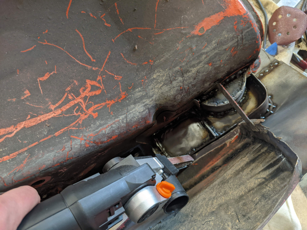

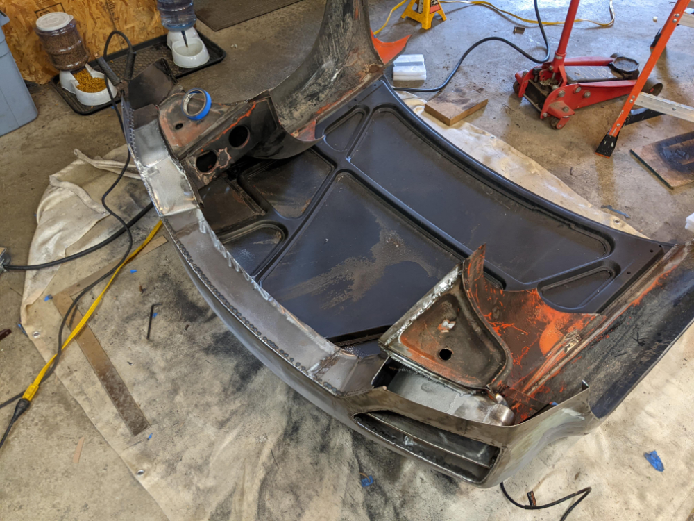

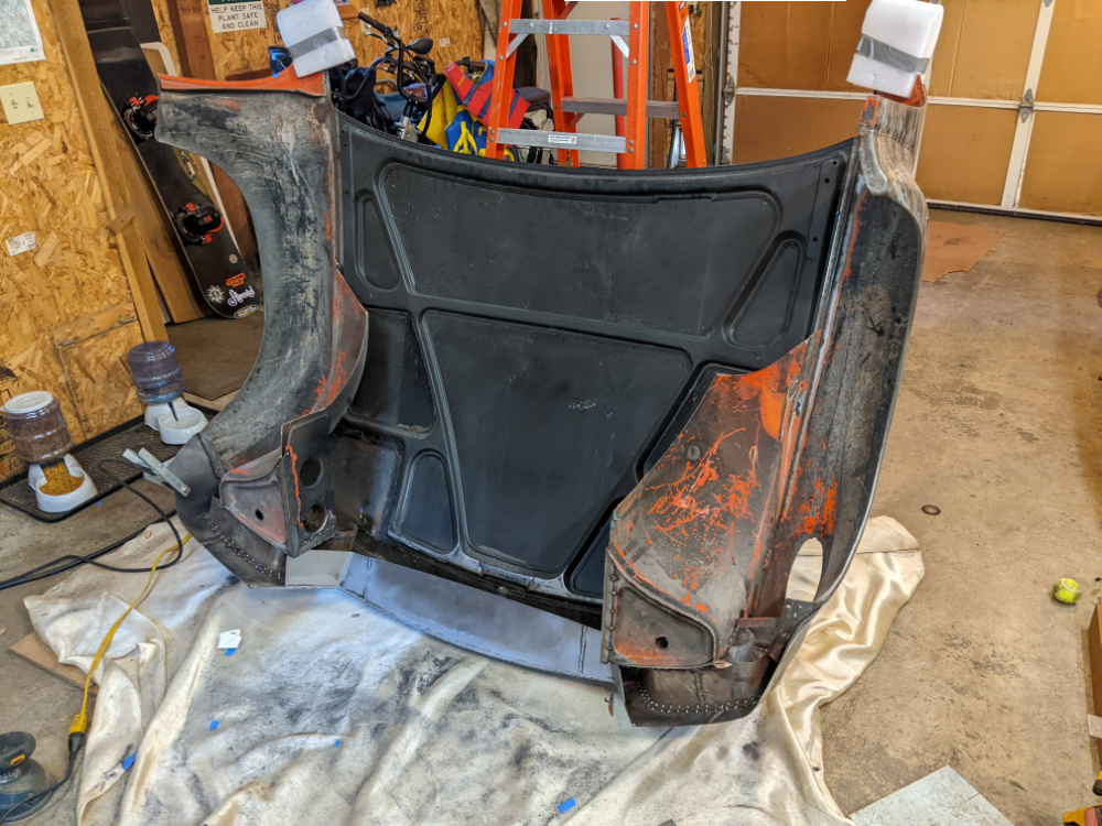

Here you can see I cut out the inner sheet metal from the original bumper that fell within the side opening.
Removing that inner metal revealed the inner fenderwell, I will need to seal this back up as I rebuild.
Here is a loose mockup, nothing welded yet but progressing!

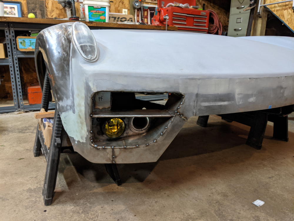

Time to start filling the side grill areas, I am loosely following the organization of the WRX grills, a horizontal division, with a radiator opening on the top, and a Foglight and brake duct on the bottom.
I lined up the horizontal division with the upper center opening edge to continue that line across the front of the bumper.
I made the dividers teardrop shaped in profile so they would be rounded and thick in the front by welding in a rod.
Then tacked them into the pods.
plymouth37
Here they are fitted in place.
Next I will make and weld in the rest of the elements that hold the fog light and ducts.

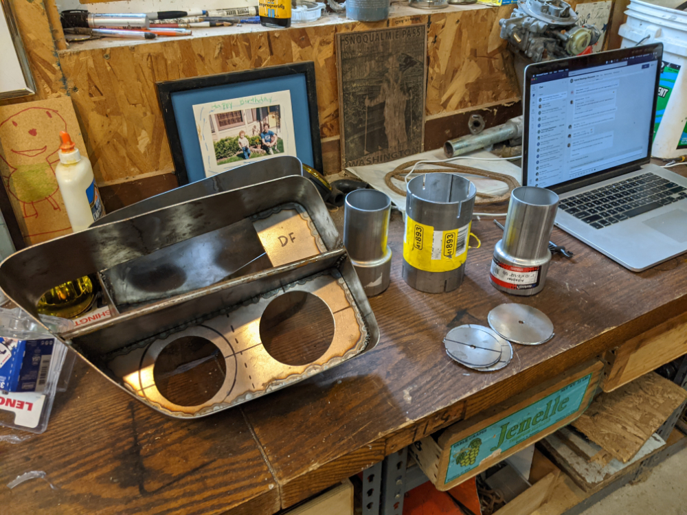

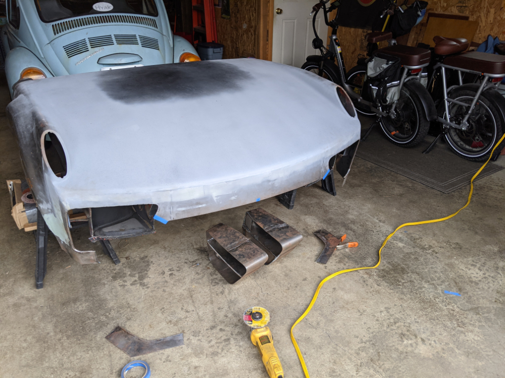

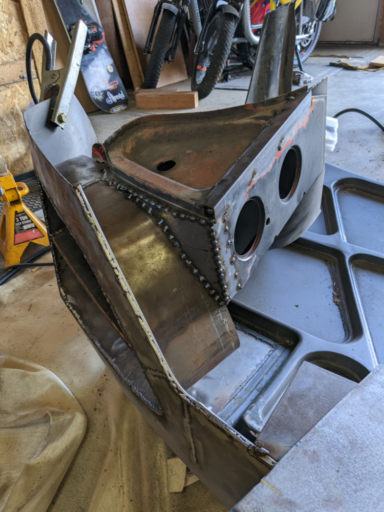

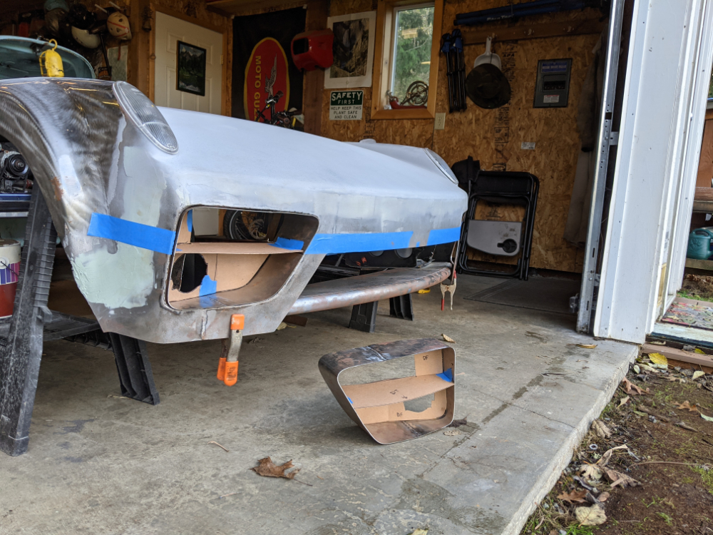

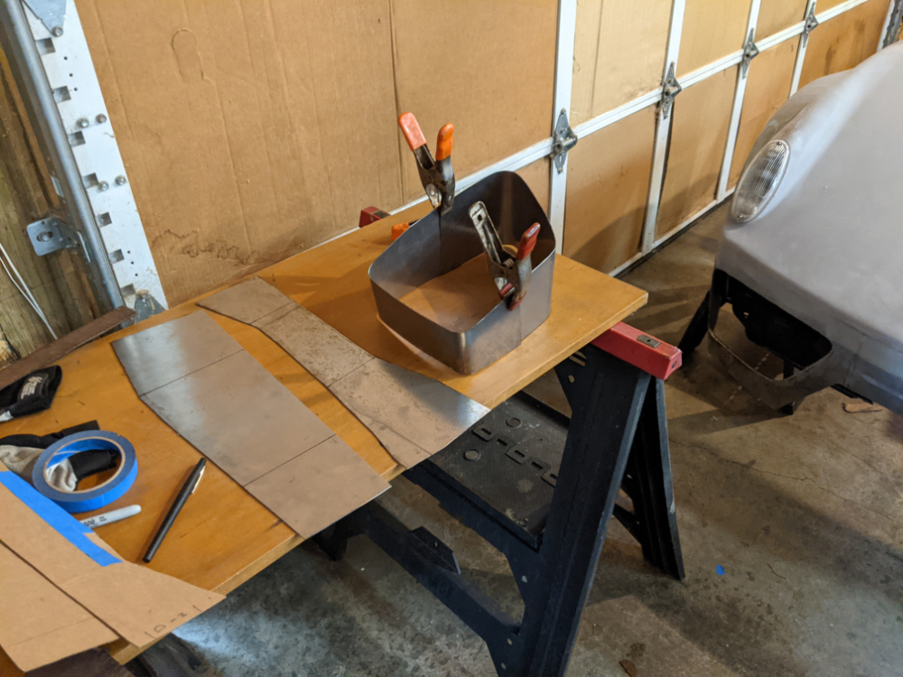

I started building out the fog light buckets, The top half is radiator inlet, the bottom is divided between fog light and brake duct inlet, I am taking advantage of NAPA exhaust bits to make nice, flared inlets for the brake ducts.
I quickly discovered that after welding the buckets together they were no longer flexible enough to fin in the bumper openings so I had to temporarily chop off the bumper bottoms.
Here they are just sitting in place, the fog lights came along with the WRX grill set I used as a template, there will be a grill near the front of these bumper openings so the fog light lenses will be more flush than they appear now.
Rest of bumper duct taped into place.
plymouth37
Tack welding has begun.
Fully welded in ready for finishing. I had to pie cut and reweld the seam that attached the center section of the bumper, the contour of the center opening was a hair too far out to match the contour of the top of the bumper, all good now!
Next I will flip the nose over and work on underside and interior.

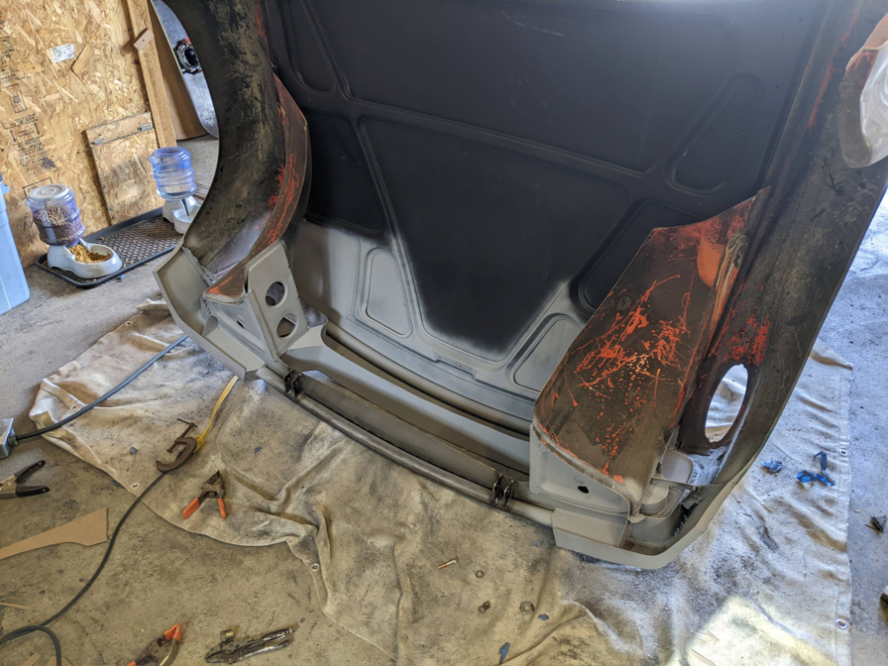

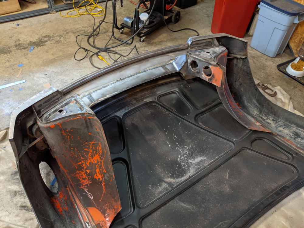

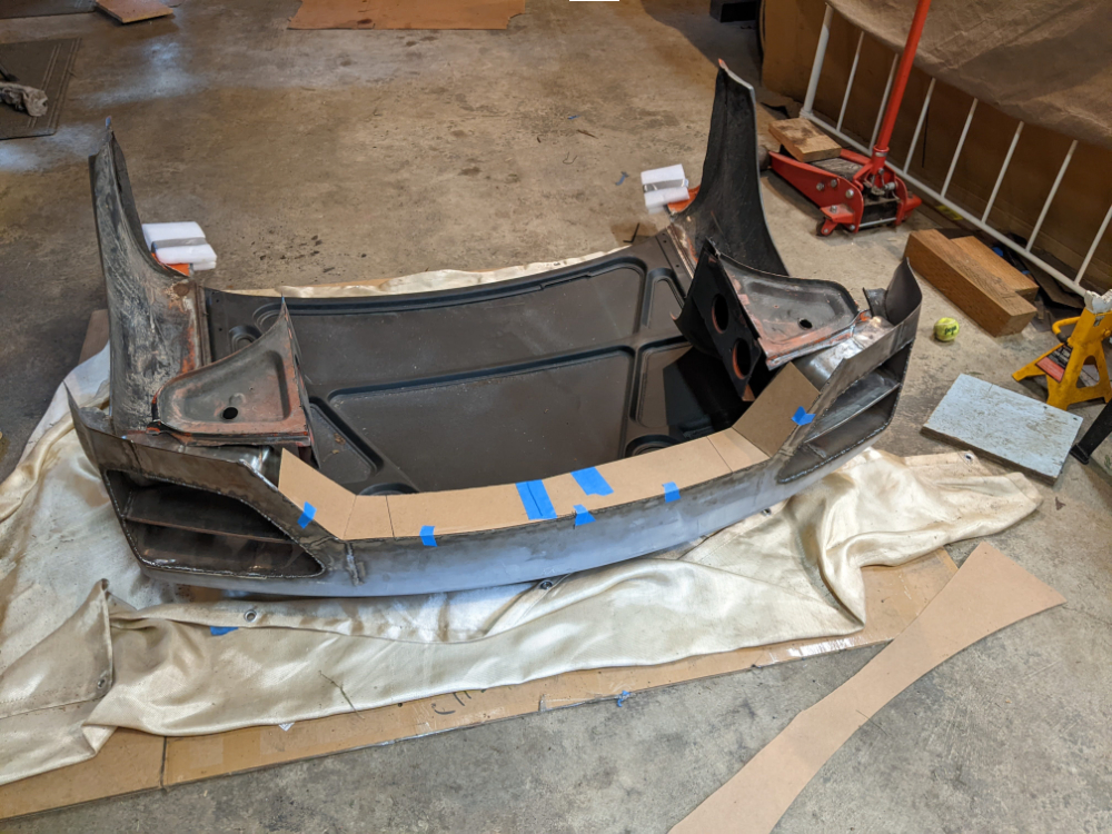

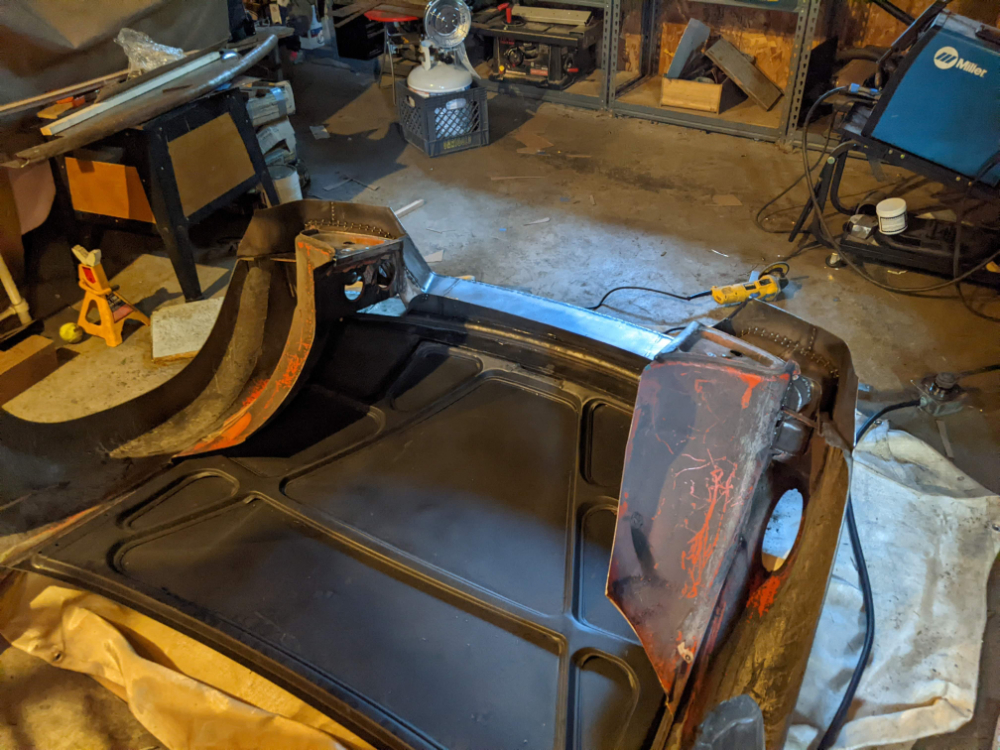

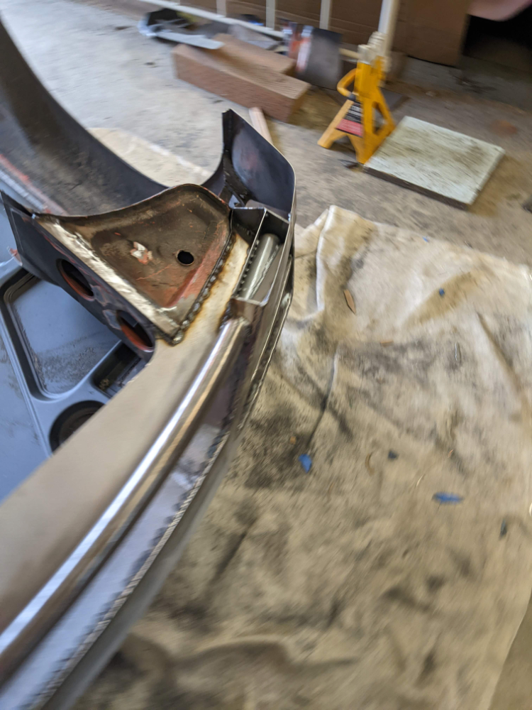

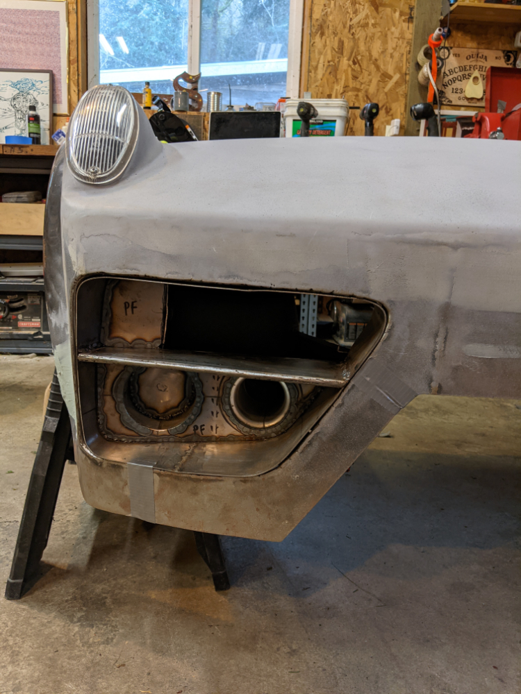

I flipped the nose over and started patching the holes between the original structure and the new bumper.
Made some templates for the inner surround of the main grill opening.
Welded in Steel for the intake surround.
Then finished the welds.
While the nose was upsidedown I also added some welds to the back side of the bumper seams and boxed in part of the back of the radiator opening.

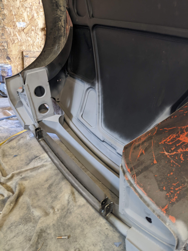

plymouth37

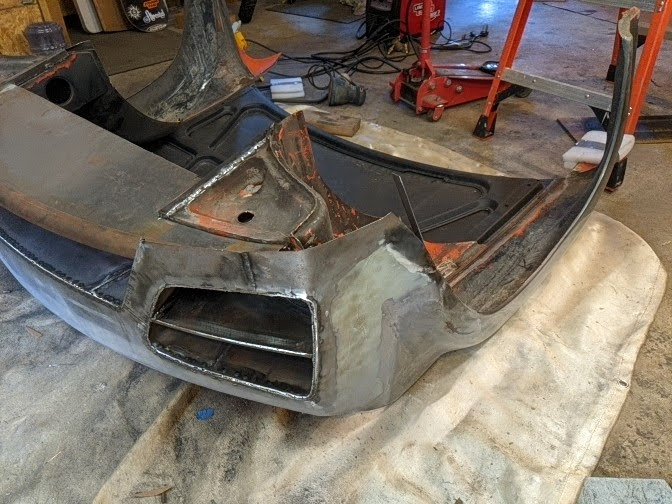

Did you know finger sanders are awesome? There were a ton of tight spaces I had to clean before I welded them up and it did a great job of getting into the tightest spots, definitely recommend.

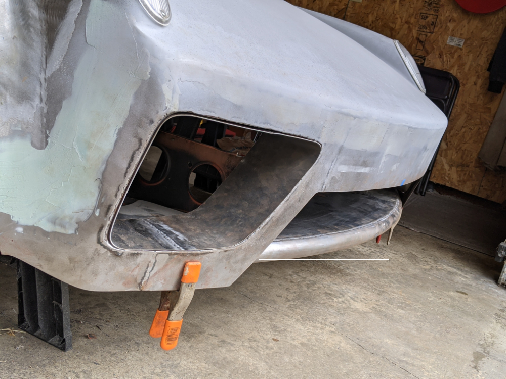

I trimmed and fit the lower lip bar into place.
I had to add some metal in the corner of the wheel opening to get that to look correct.
Then welded the lip in and boxed in the edges where it met the bumper.
Then made some templates to box in the bottom of the bumper.

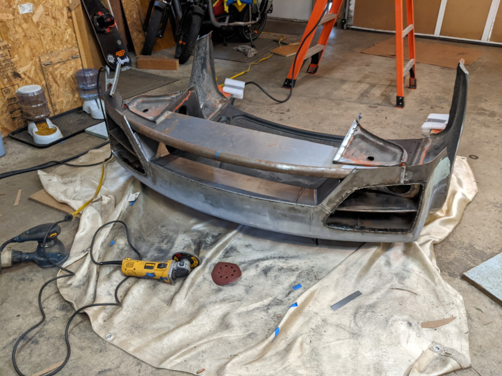

I capped the bottom of the bumper.
here is everything welded up.
Last step is to weld in mounting tabs for the front opening hinges.
Tune in next time where I flip it over and we see how it looks!

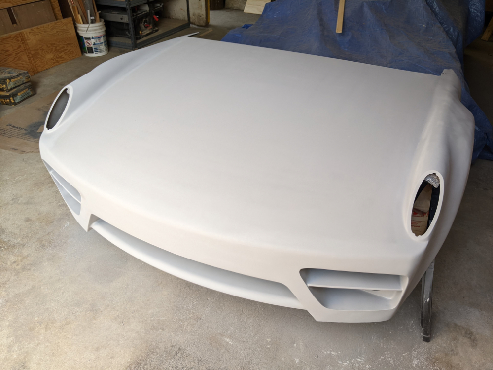

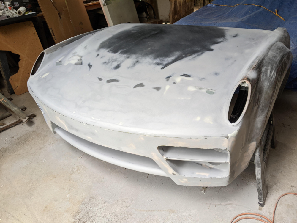

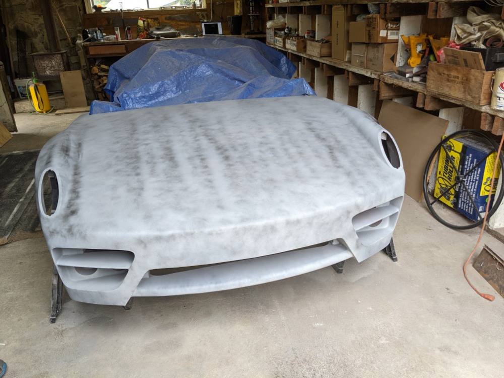

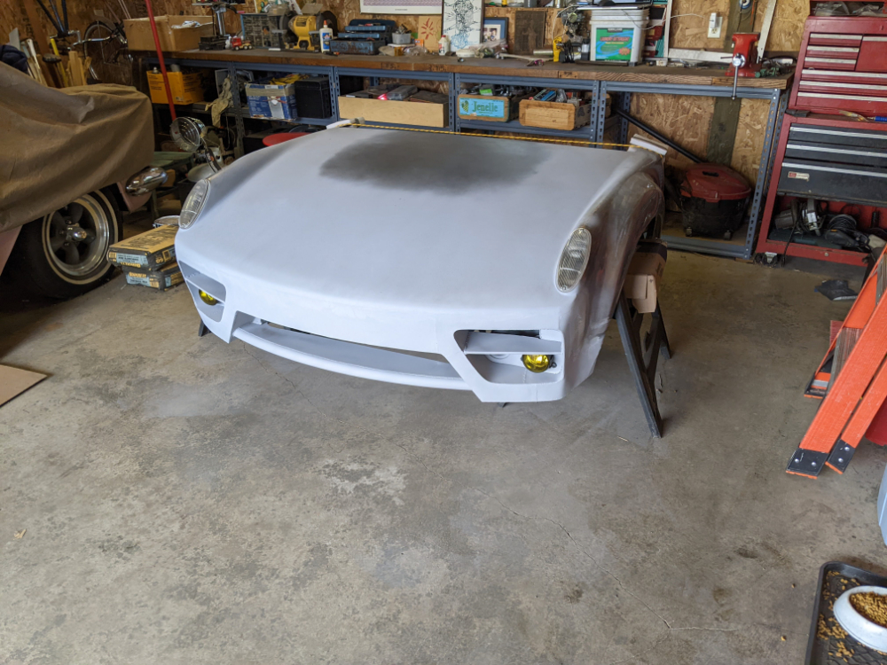

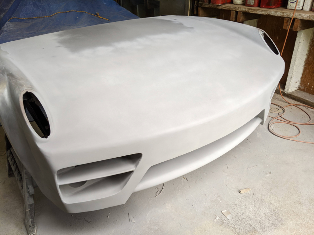

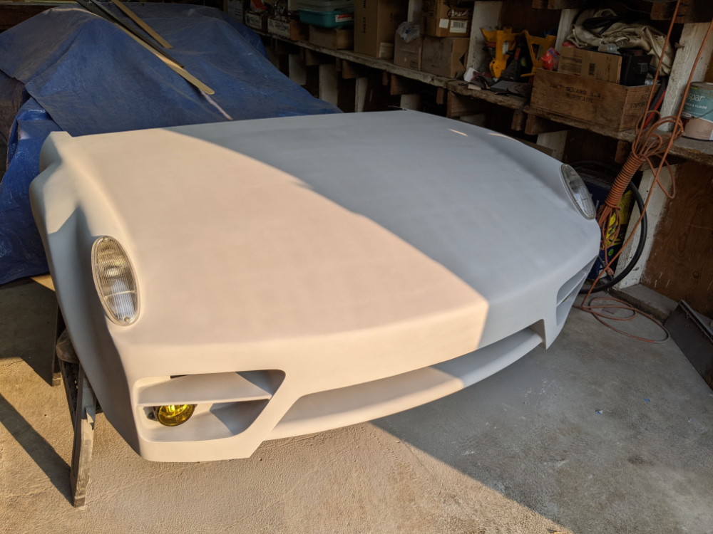

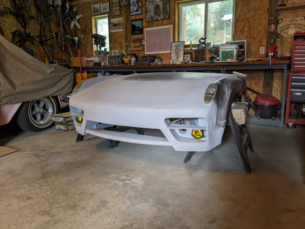

I flipped the nose over and hit it with some metal etch primer and some high build.
Still a lot of body work to do but here is the best look so far as to how it will look.
Next I will grind down offensive welds, hammer down some high spots and enter sanding land.

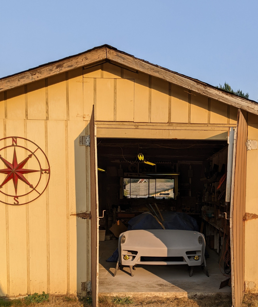

I turned that detached garage on my property that the car used to be in into a little house for my Mom over the pandemic (thanks work from home!). The car had to move to my Dad's house about 15 minutes from me, that is the newer garage with the Rambler. Now my Dad is moving to the house across the street from his old house and I moved into the detached shop on that property, I think this one will be home base for a while!

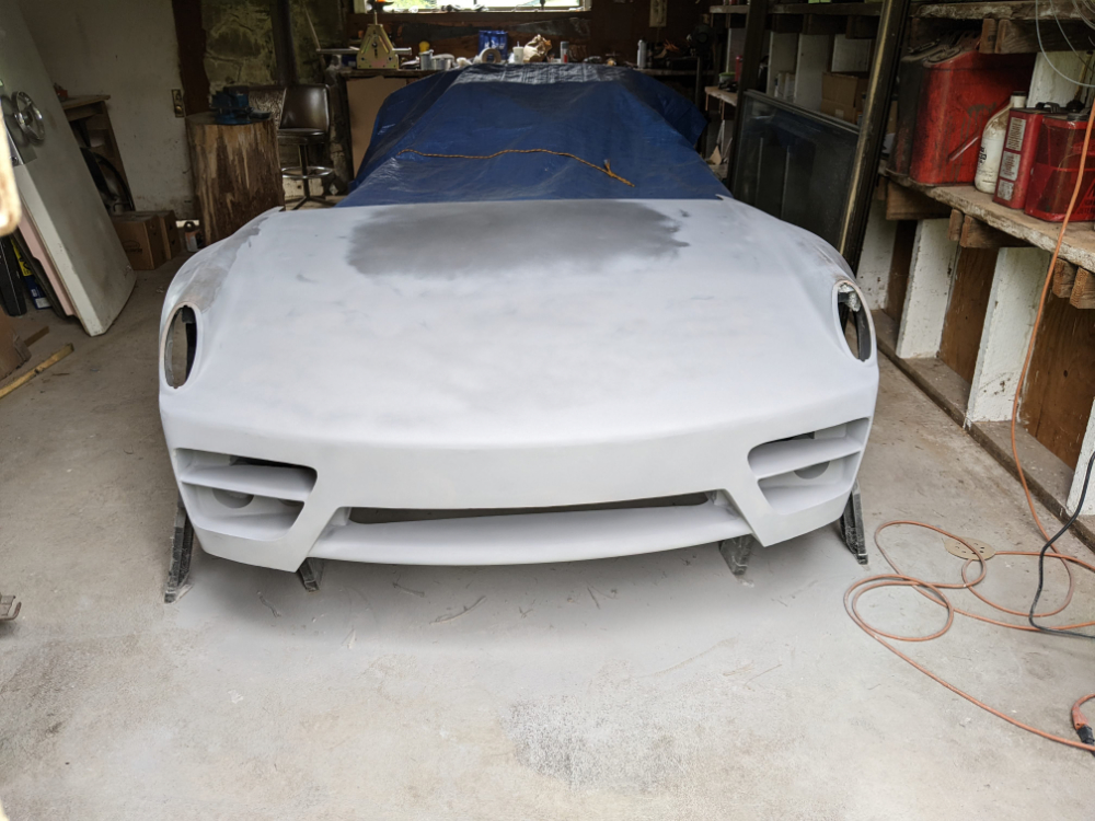

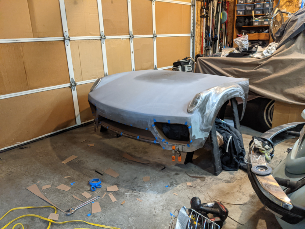

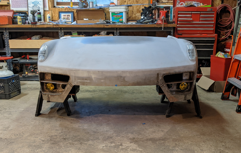

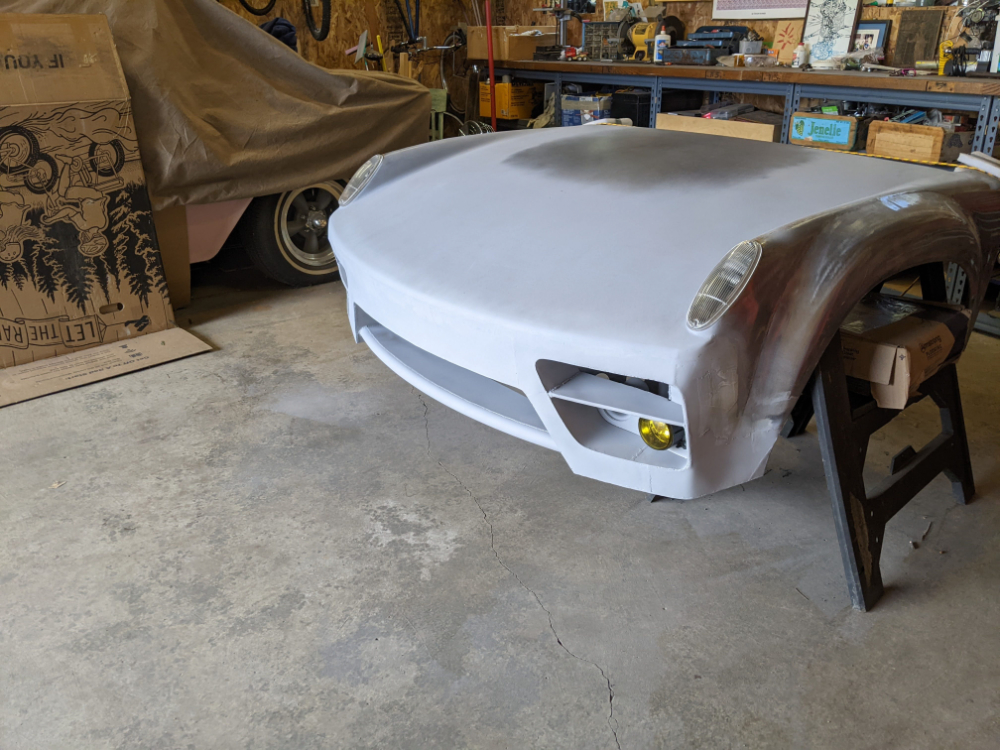

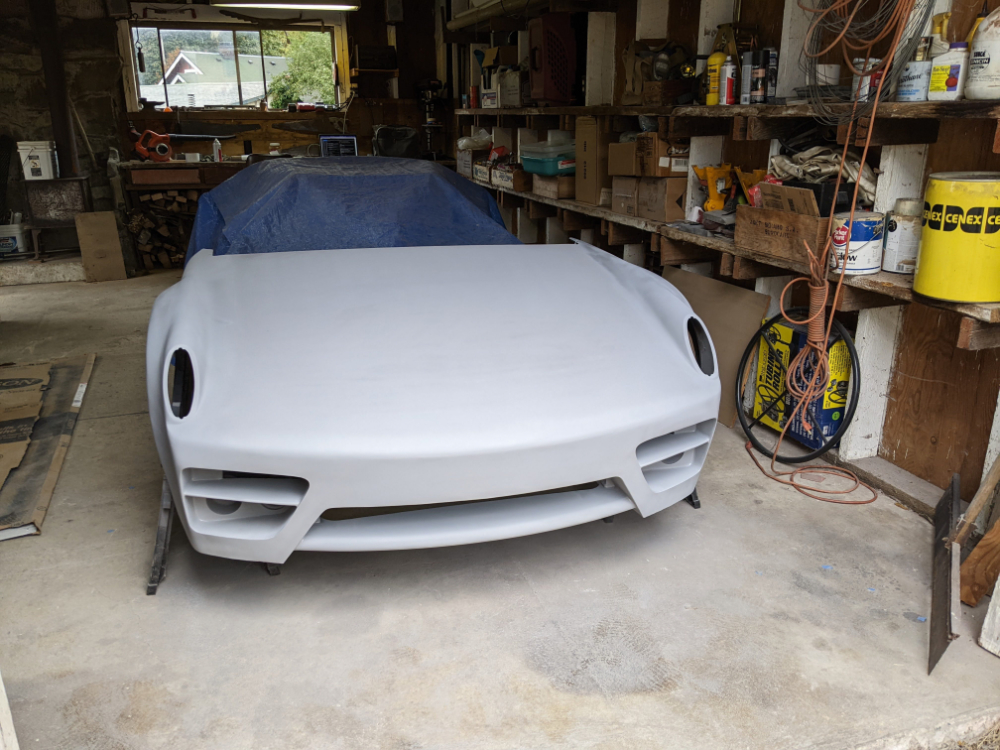

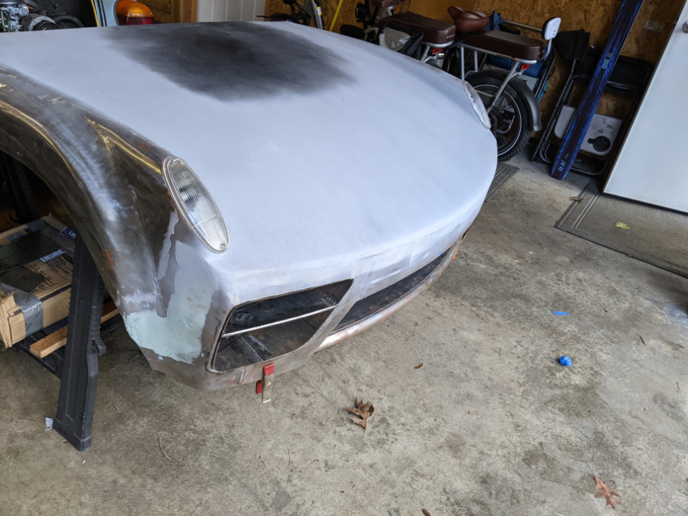

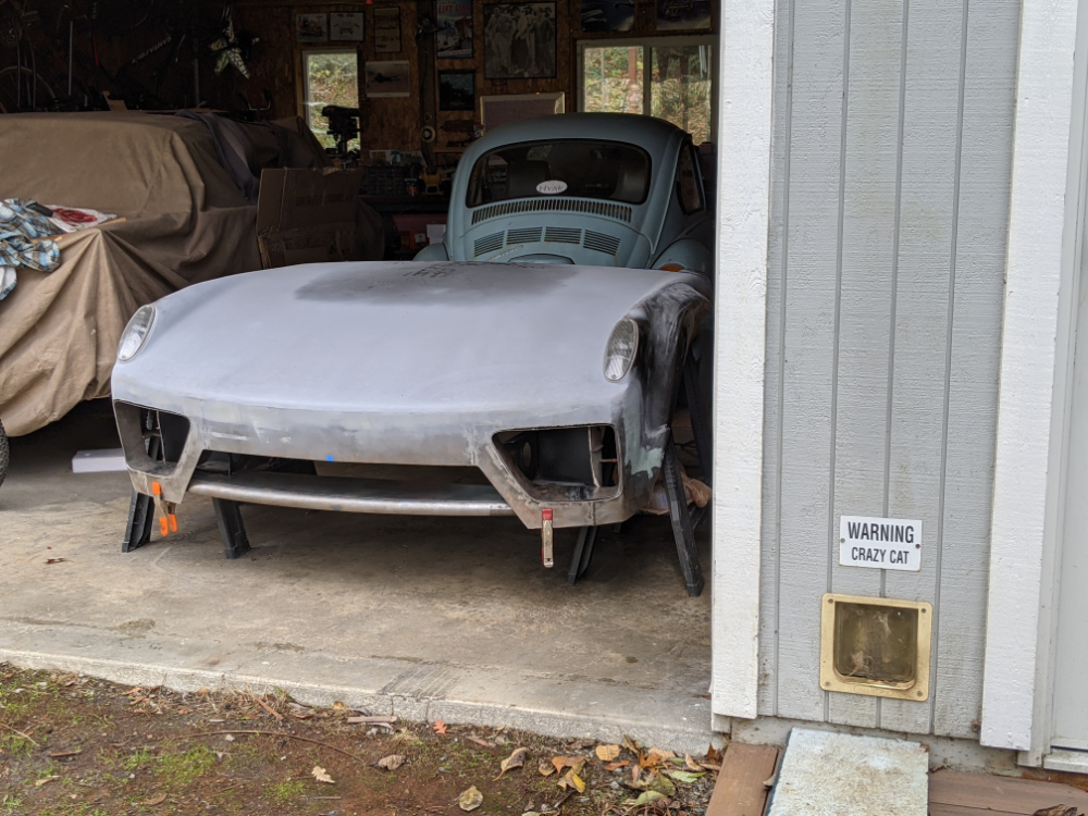

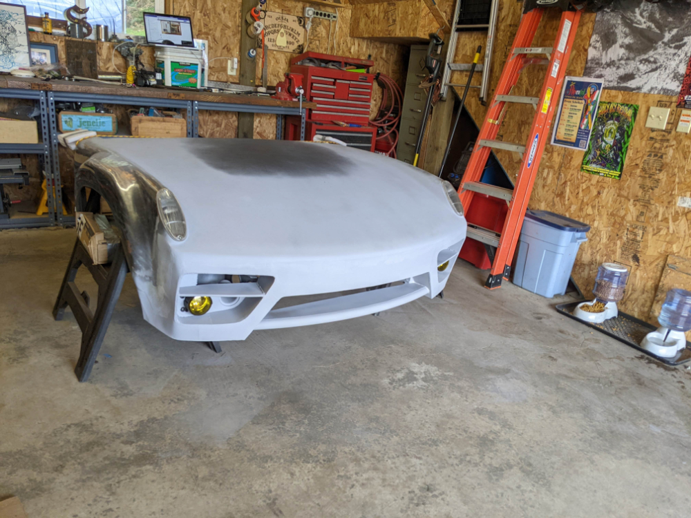

I have worked on the car quite a bit but it is just endless sanding.
My goal is to get the entire nose into Primer, filler primer is your friend when you need to smooth out Frankenstein bodywork...
The fender flares have been clear coated steel since the Vegas days and it is still hanging on pretty well, time to remove all of that.
I removed all of that clearcoat and filled and primed the rest of the fenders
More sanding, more primer.
Getting somewhere now, bodywork is maybe 80% there, I need to focus on hinges and latches before I take it the rest of the way. Next time I'll put it on the car and see how it looks!

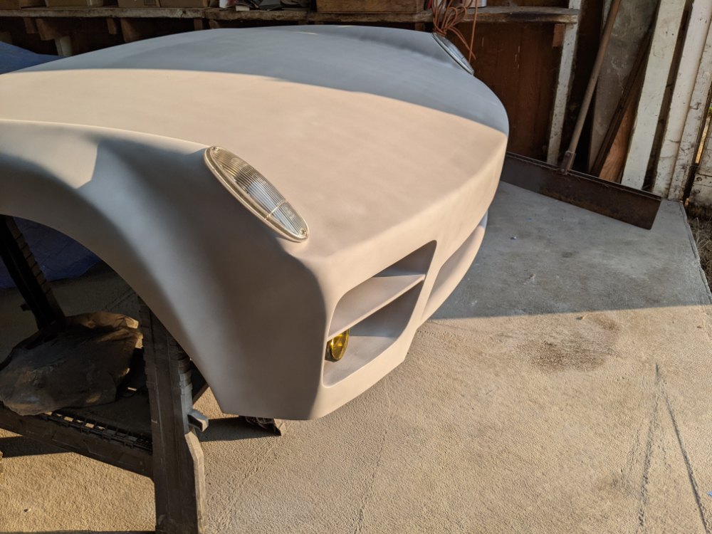

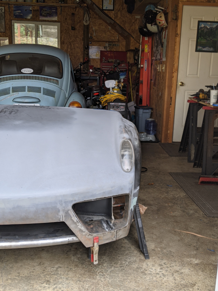

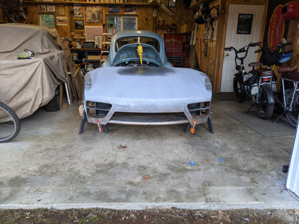

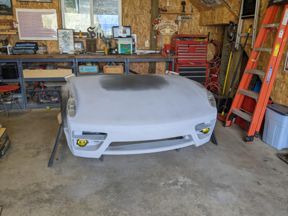

I am just about ready to get the nose on the car but first I couldn't resist mocking up the lights and seeing how it all looks.
Projector headlights in the turn signal buckets are down the road but for now I swapped in Yellow and White Drl/turn led lights behind the clear lenses and called it good for now.
Looks like a Porsche to me!
