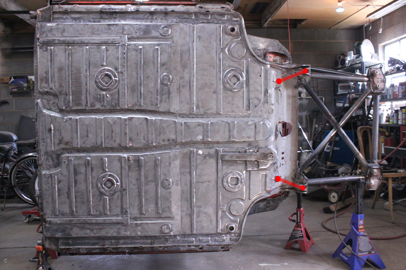

Yeah, that looks a little sketchy when the chassis is stripped. The suspension cross member bolts into that tab and a cross brace ties the whole assembly rearward to the tub, I tried to find a good picture in my photo archive but couldn't find one. Here is a shot of the bottom of the car, you can see the mounting points that the bolt in brace mounts to. With the suspension components directly behind this tab I feel like that is the most I can do to stabilize it, hopefully the brace along with the 1/8" plate I welded in there are sufficient. Click to view attachment

By my thinking, that's pretty much how the cars are from the factory. You didn't really change anything structurally, just made it see-through.

I totally agree, it is scary when you "make the car see-through" and expose how little is actually holding the front end together!

If you tie that 1/8" plated tab back into the chassis like the red line denotes that should help detune the constant vibration that will crack the chassis over time. I see it as a long term issue more than a point of weakness that would cause sag or cowl shake.

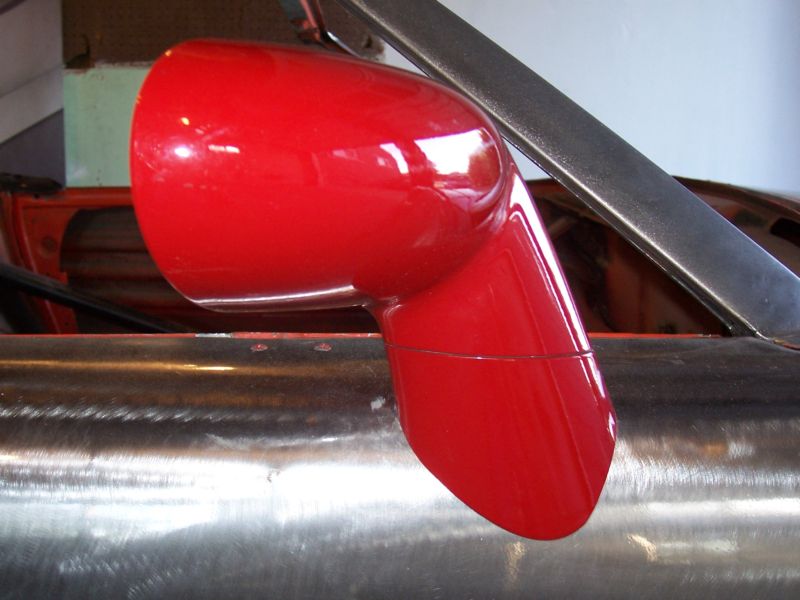

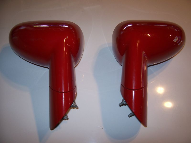

Since I am doing so much to update the the cars looks I couldn't just use the stock mirrors. There are a lot of choices out there but i finally settled on 2006 Pontiac Solstice mirrors, they are quite a bit smaller (and cheaper!) than the Porsche Aero mirrors and I think they fit the cars style pretty well. Click to view attachment

Here is a shot of how they fit, not an easy bolt on but not hard either, you need to re-contour the base of them to match the curvature of the door and drill 3 pretty huge holes. You can see the stock bolt holes in the door for reference. Glad I could help Tripps! Click to view attachment
