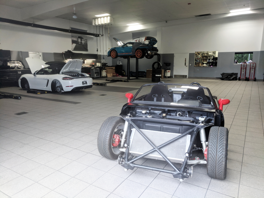

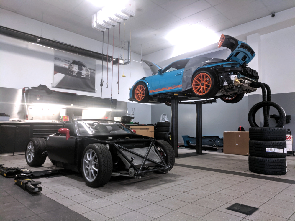

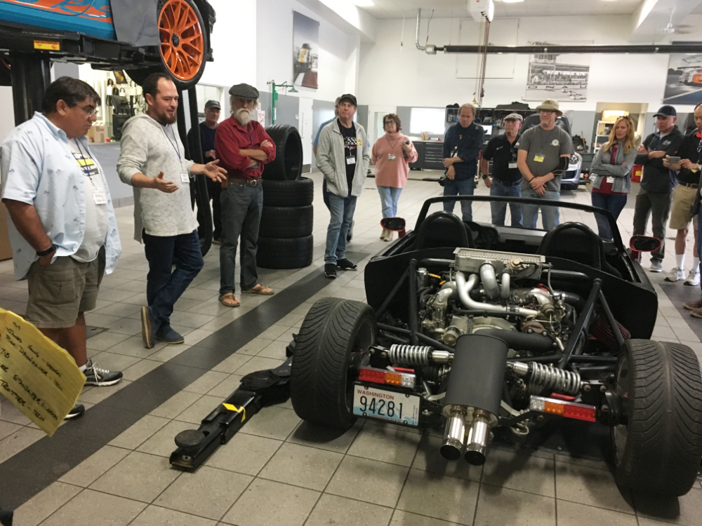

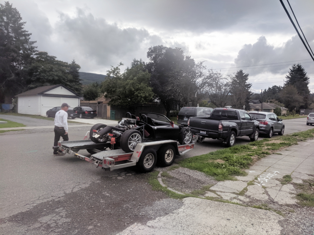

We took part in the PNW 914 turnout tech session, it took place at Porsche of Tacoma, about an hour from our place, loaded on a trailer, managed to dodge most of the rain!
Good turnout of all flavors of 914s. My dad and kiddo had a blast!
This is the first time my car has been in a dealership in about half a century!
GT3s make good backgrounds
Got a good chance to talk about the car and what is has taken to get to this point, as well as future goals, over all a great event, thanks to Billy for making this possible, it was a lot of fun!

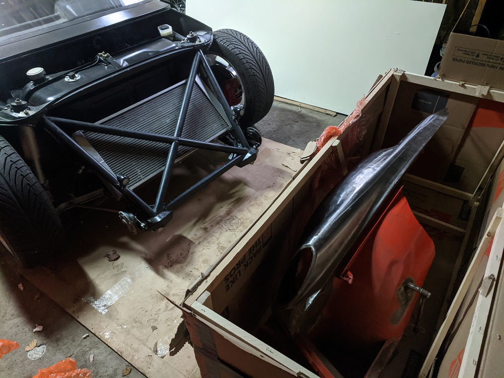

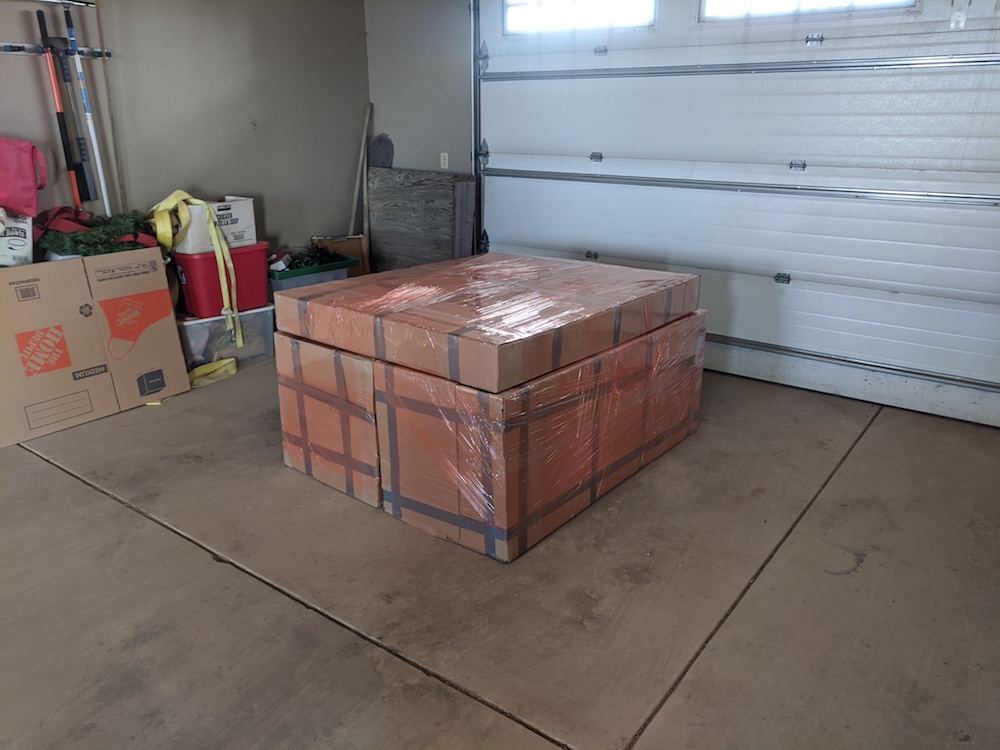

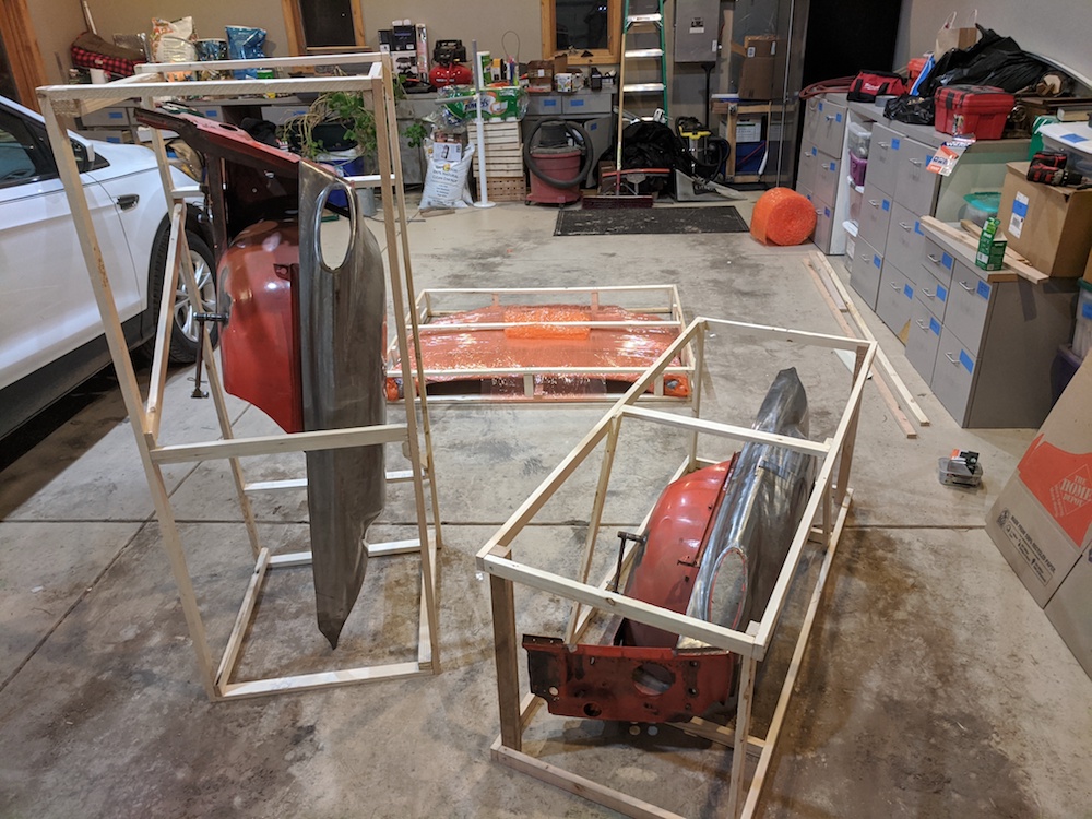

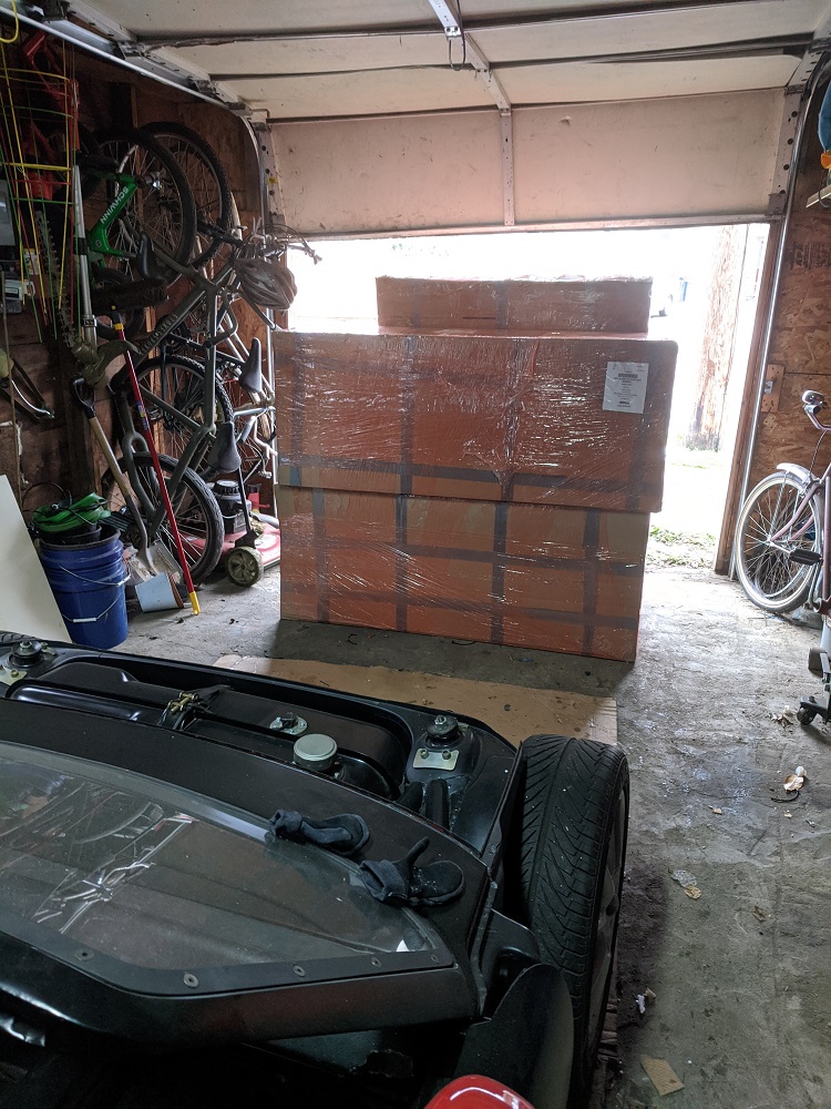

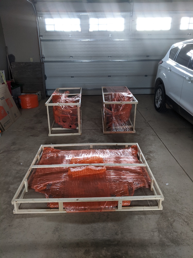

As those of you who have been watching this build for a while may know, the body for the car is still in Wyoming, I didn't have room on my trailer when I brought the chassis to Washington. Now that the chassis is fairly complete the next thing to work on is the nose of the car.
I have struggled to find a cheap way to get the body out west, but I think I found the answer, Greyhound Bus, or more specifically GPX freight, some discount shipping service that uses Greyhound. They only wanted $175 to ship the entire front end, what a deal! I am in Wyoming visiting family so I figured I should go for it and ship the nose home.

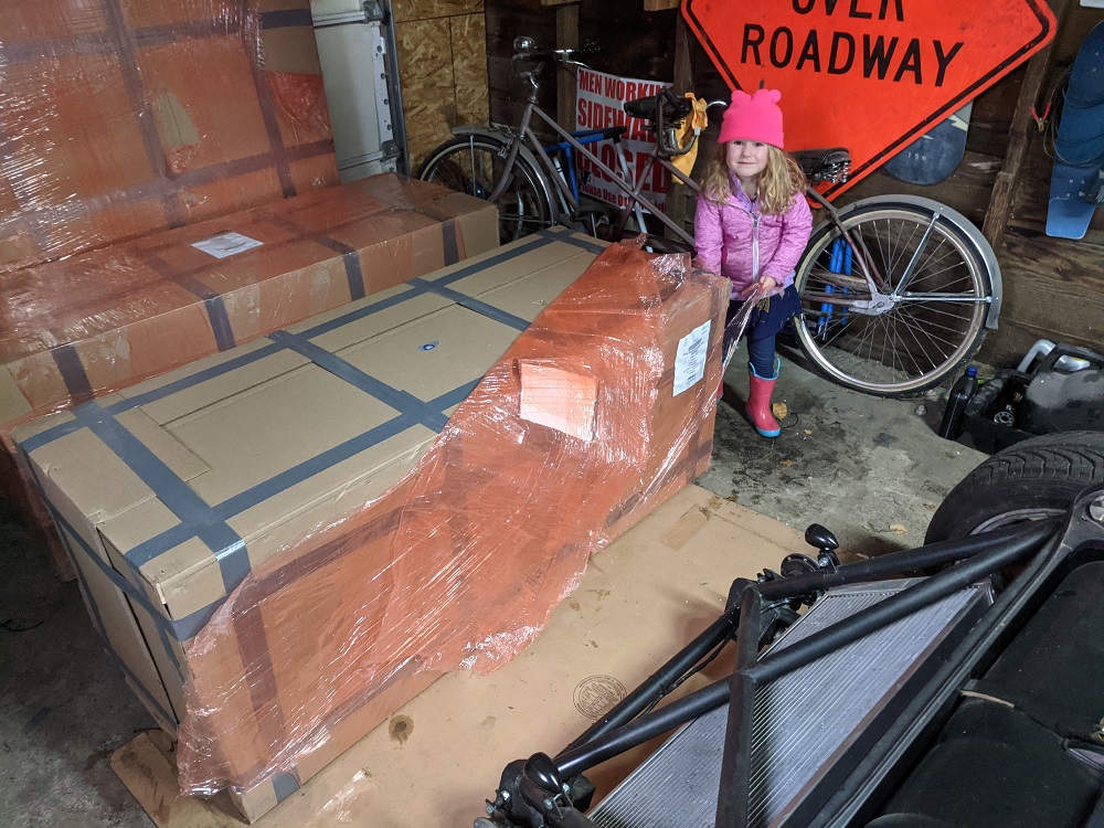

I had a feeling these things were not going to be handled with great care so I built crates that will hopefully keep everything safe, no bubble wrap spared here!
All ready to go!
Loaded it in the truck and dropped it off at the Greyhound Station in Laramie, here goes nothing!

plymouth37

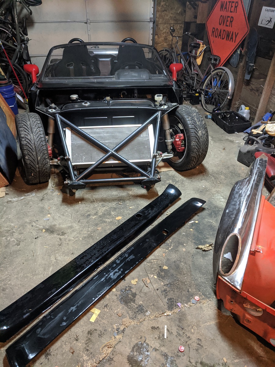

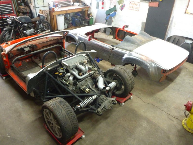

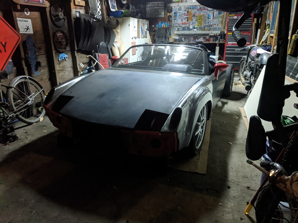

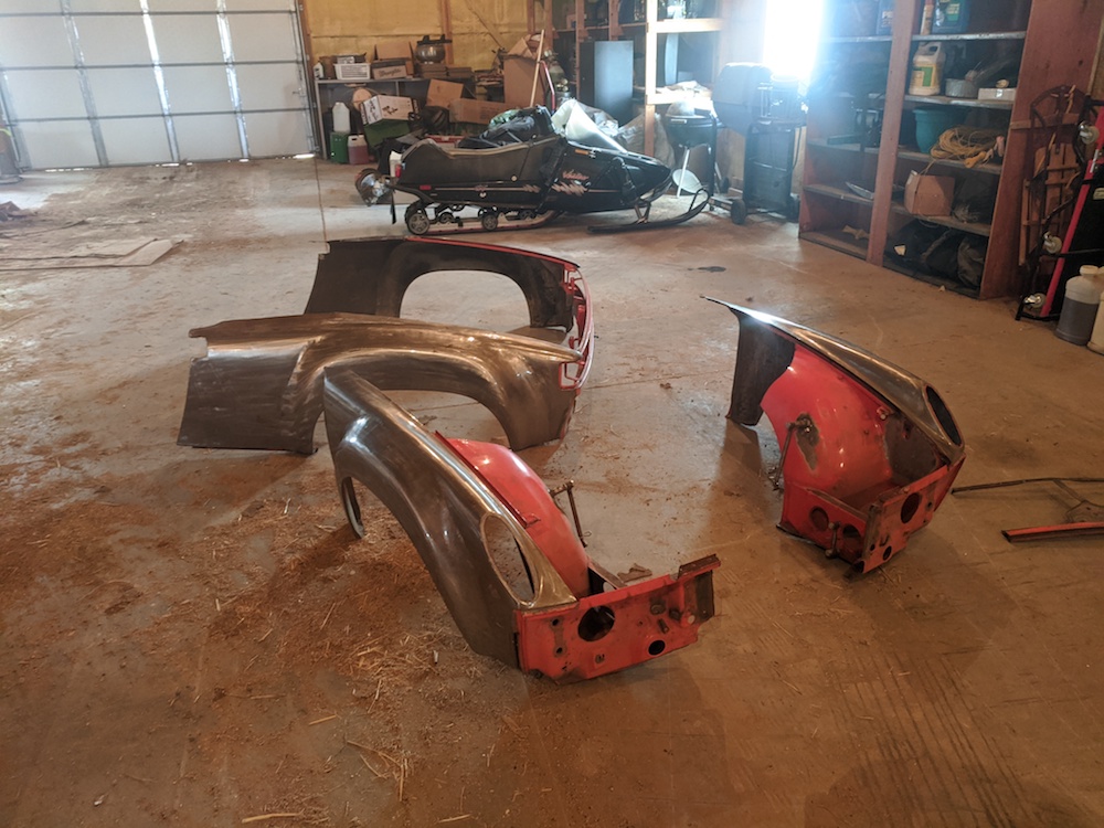

Look what made it out west!
Let the unboxing begin!
Reunited after about 7 years... time flies when you are busy doing other stuff!
Here is a quick mockup, more to come soon!

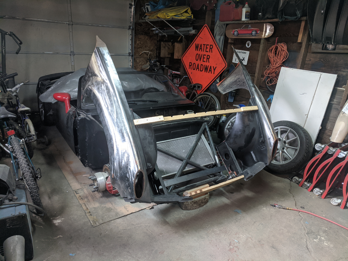

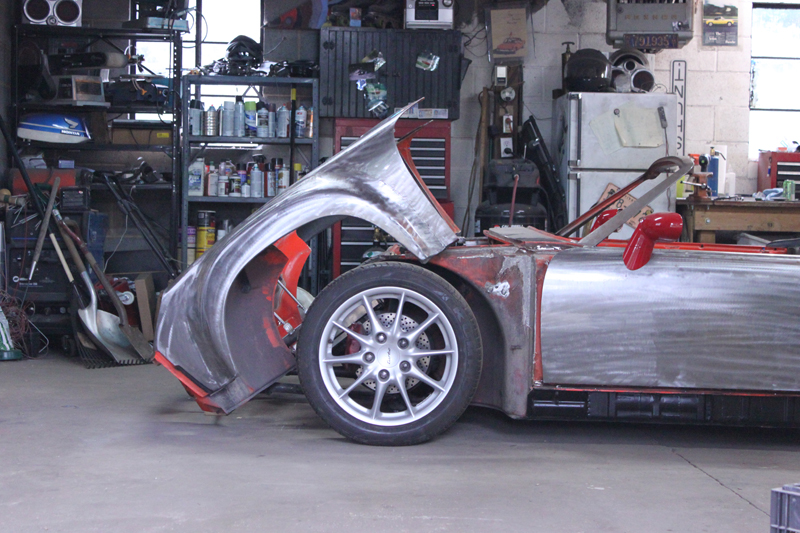

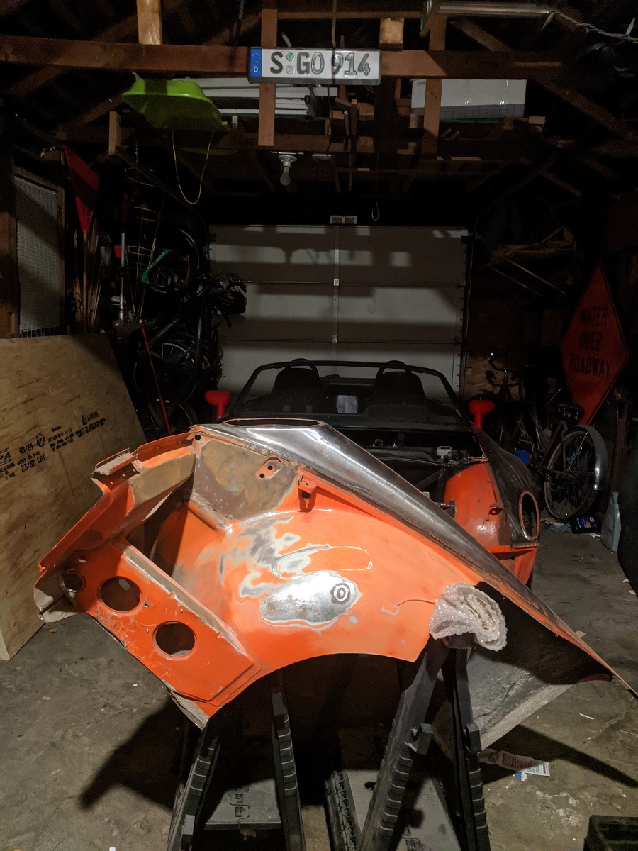

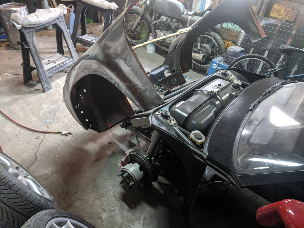

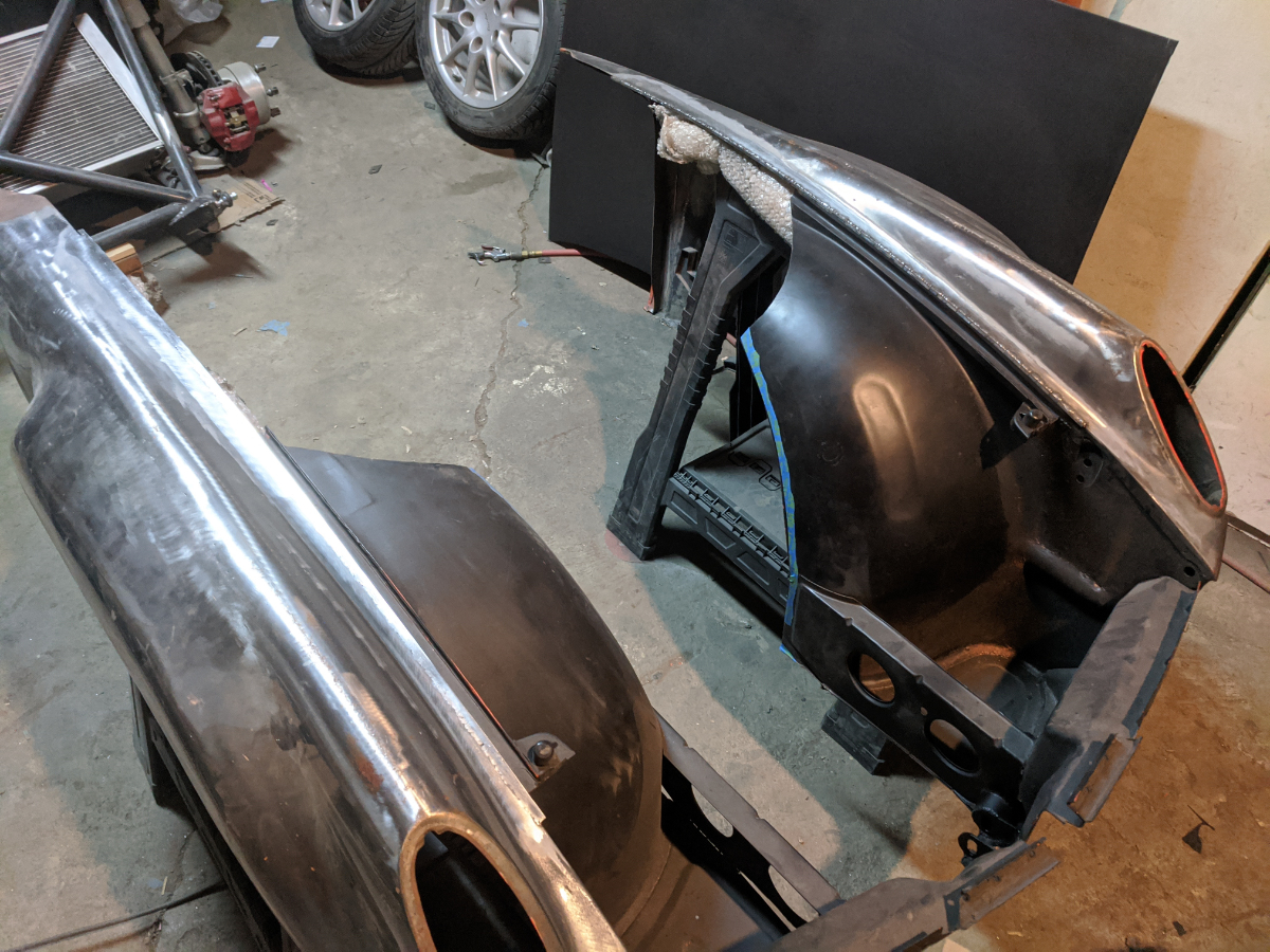

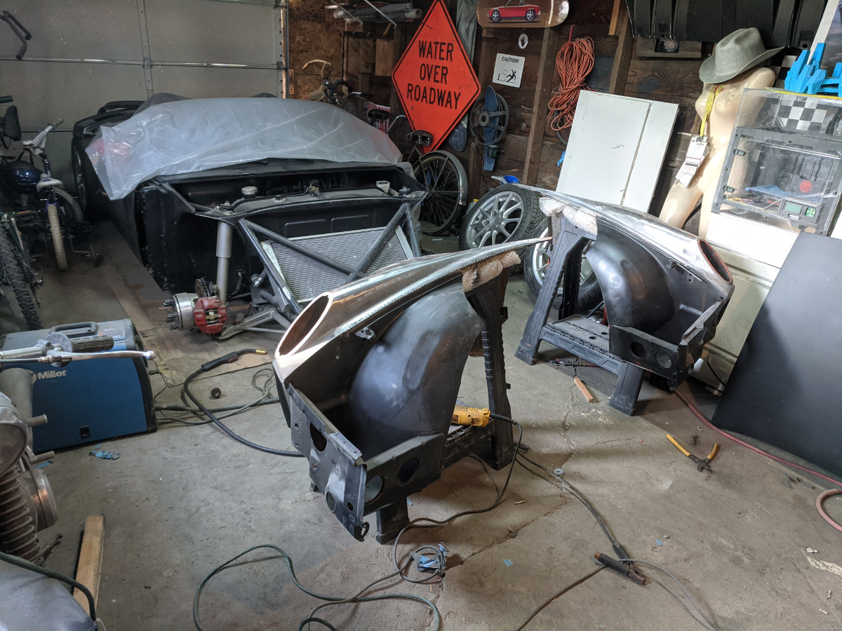

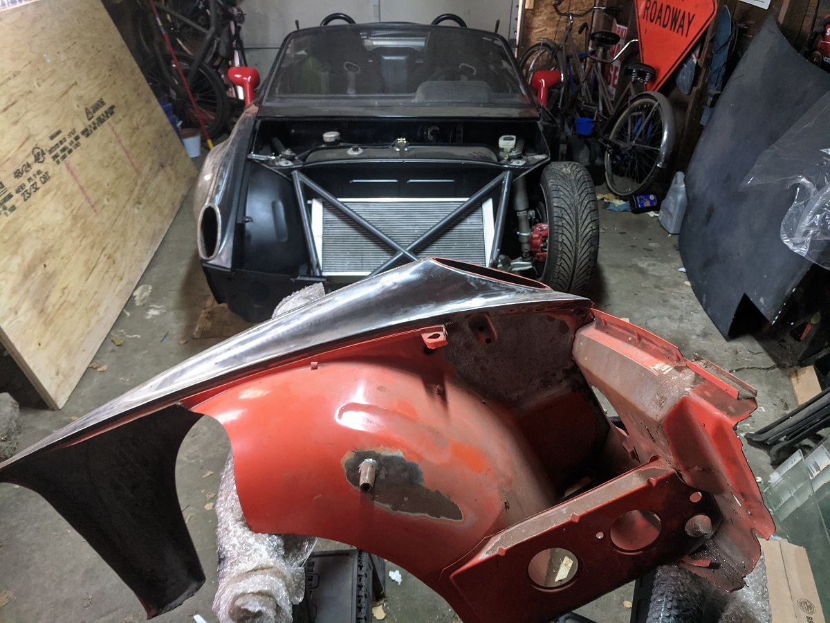

I mocked up and trimmed the rockers, aligned the doors and got everything relatively straight.
I got the fenders mocked up, got the gaps good, threw on the bumpers to generally test fitment.

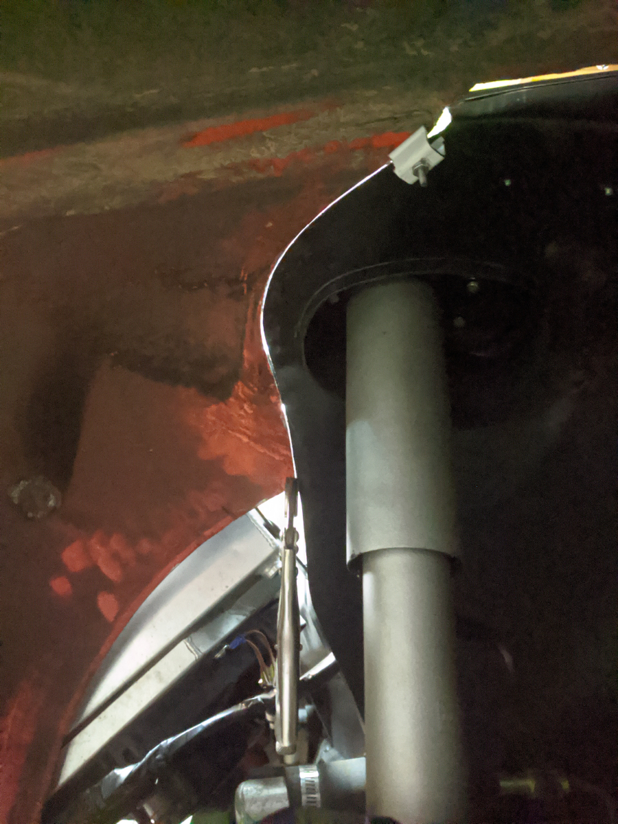

I am re-thinking the hinge system in the front, after mocking it up I can get away with a simple pivot point off of the front of the chassis.
I pulled off the fender and ground off the old hinge points and started stripping it.

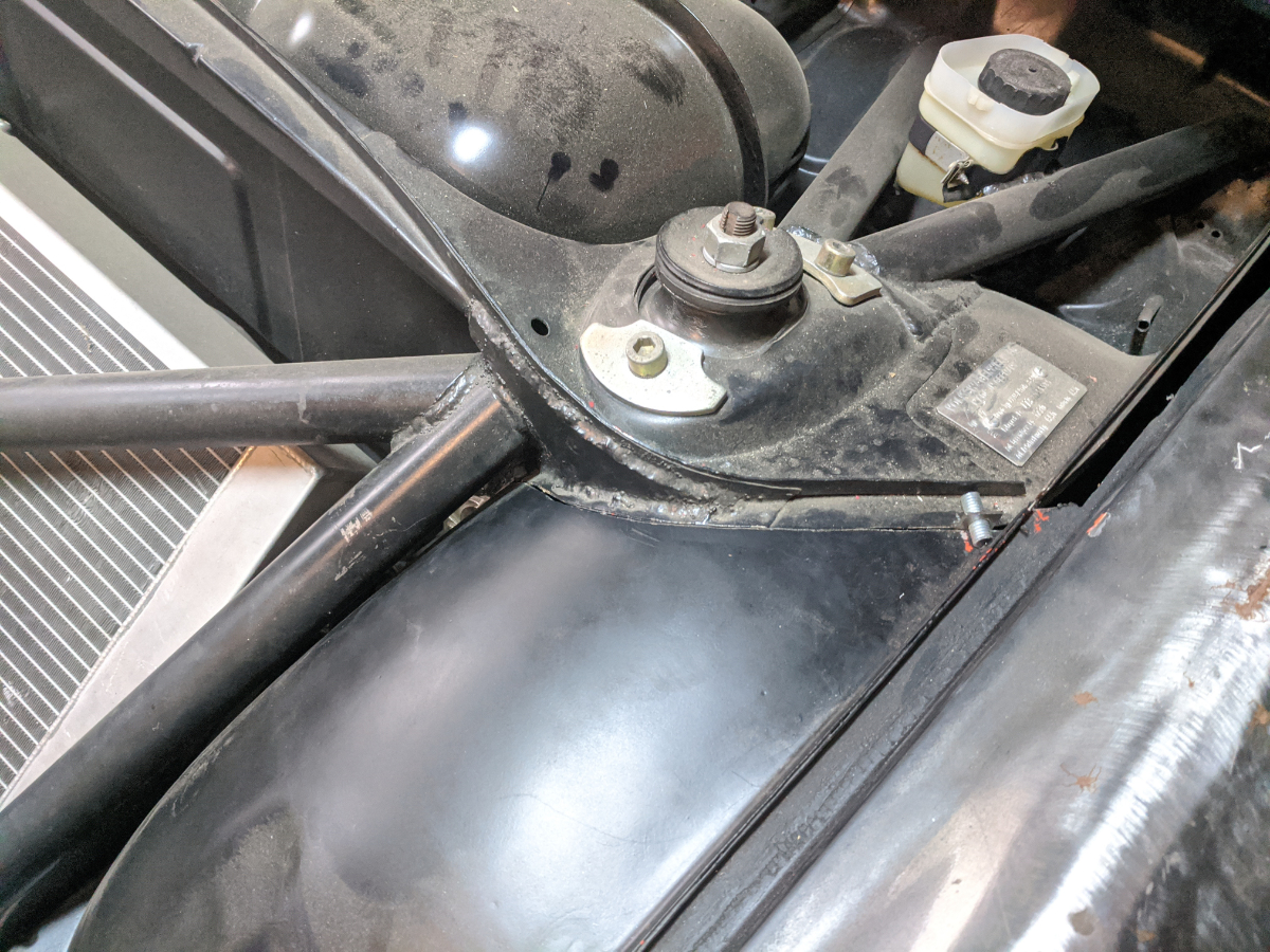

I threw some primer on the interior portions of the fenders after cleaning them up, whole new world doing metal work in the wet PNW, I used to be able to leave metal bare for years in Wyo/Co, not any more!

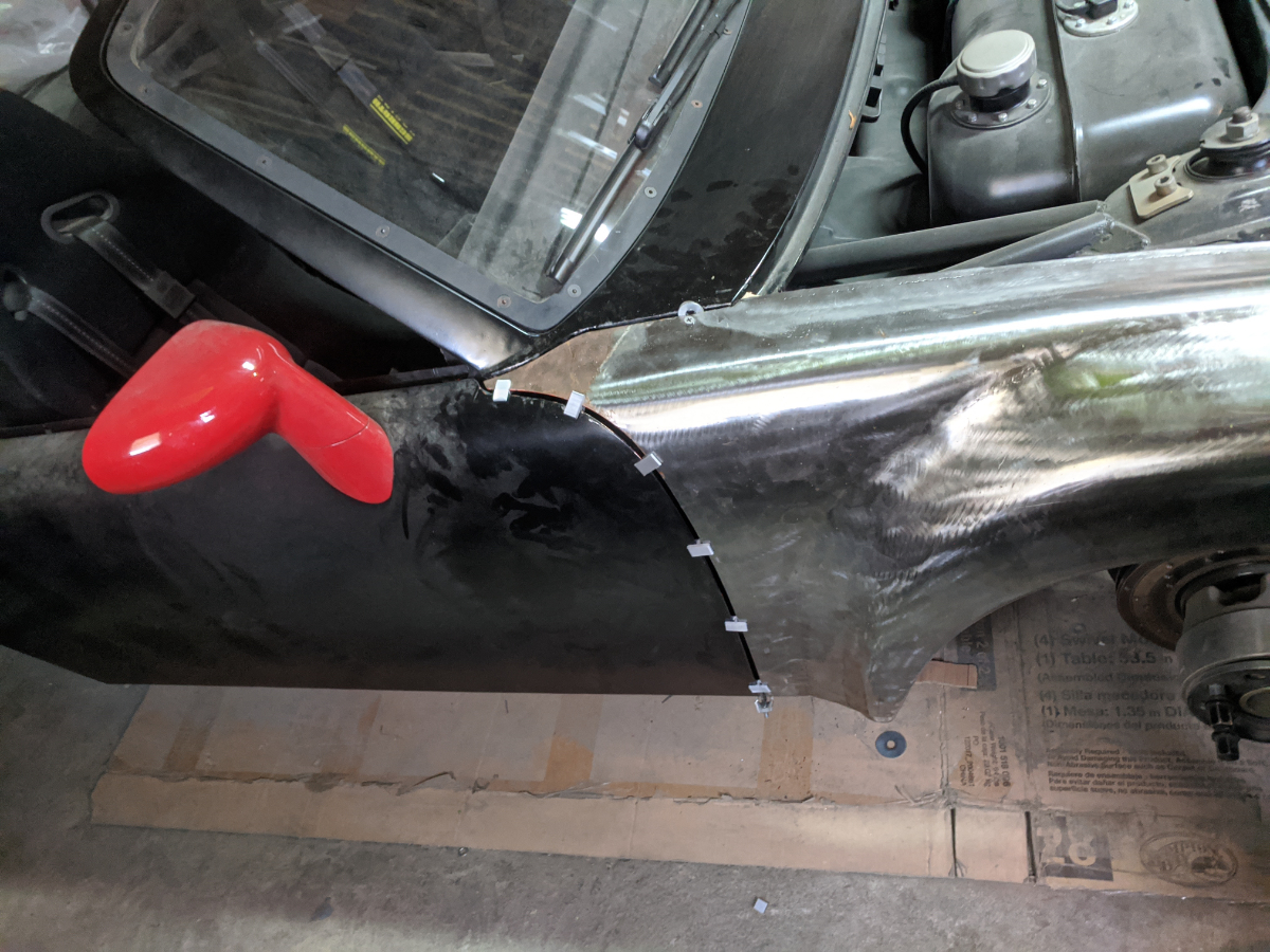

Took the front wheels off, then started getting the fenders aligned for real with good door gaps, forgot how fiddly body work is...
This is to set the exact location for the front pivot point, get the fenders in the right spot, mark it, add pivot points, then weld the hood on.
Had to do a bit of clearancing on the chassis but everything fits snug now.

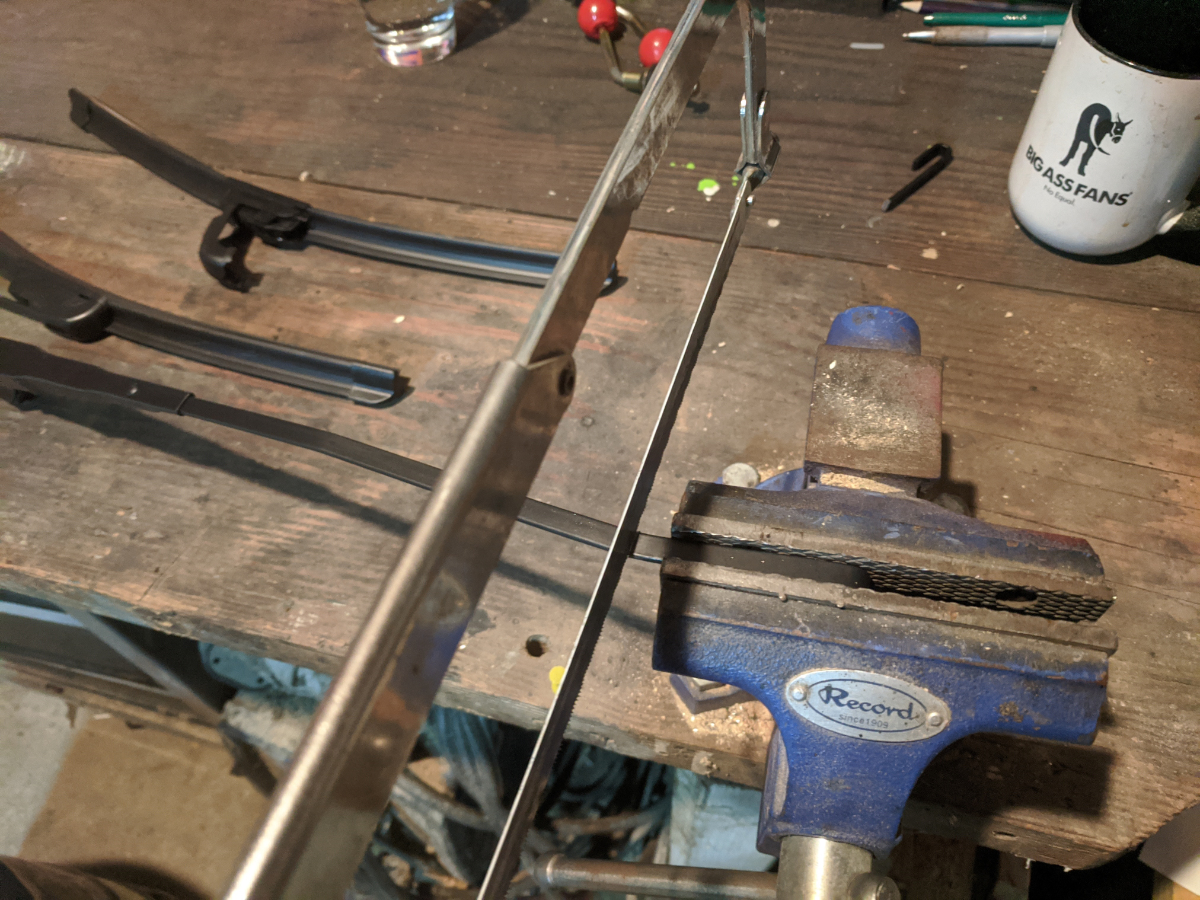

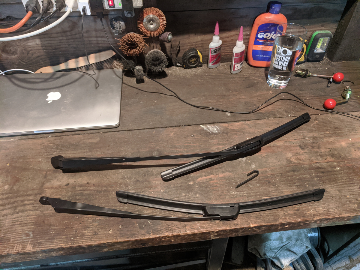

Quick little project to start off, I think the lack of wipers on the car is the only actual violation on the car, time to make that situation a little less obvious...
I bought some manual golf cart wipers, I like their blacked out minimal design.
Then modified them to be straight and short enough for the chopped windshield.
Then bolted them on....

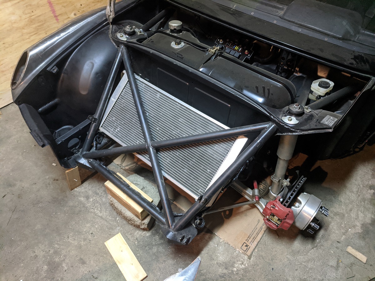

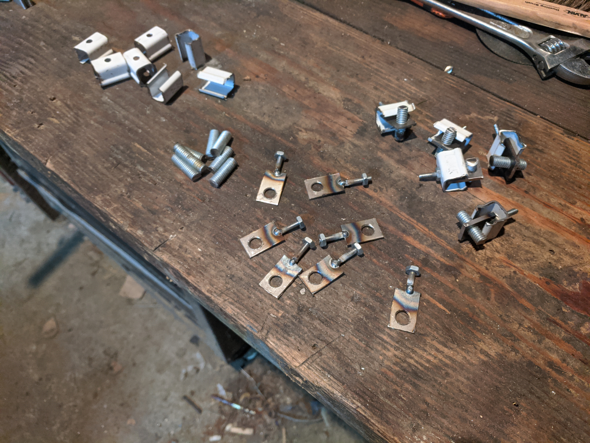

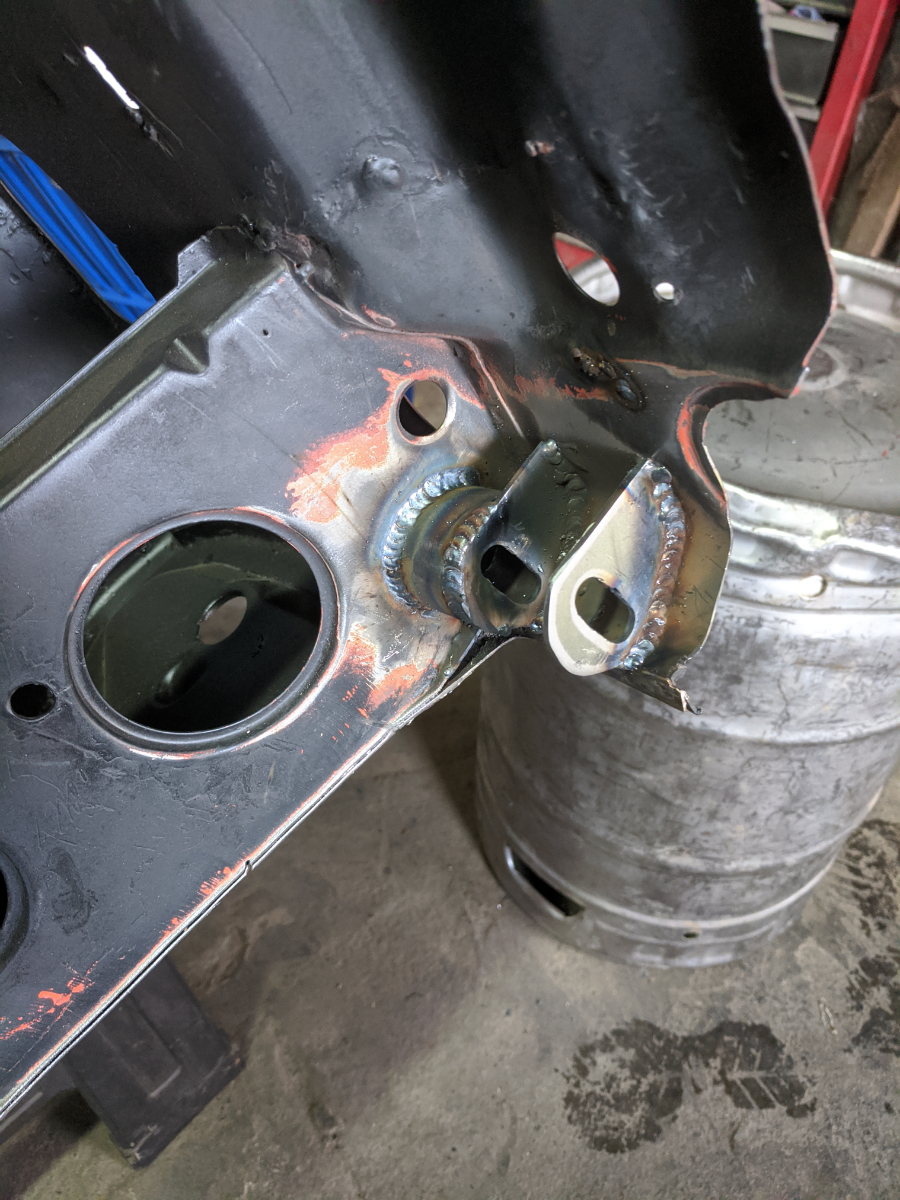

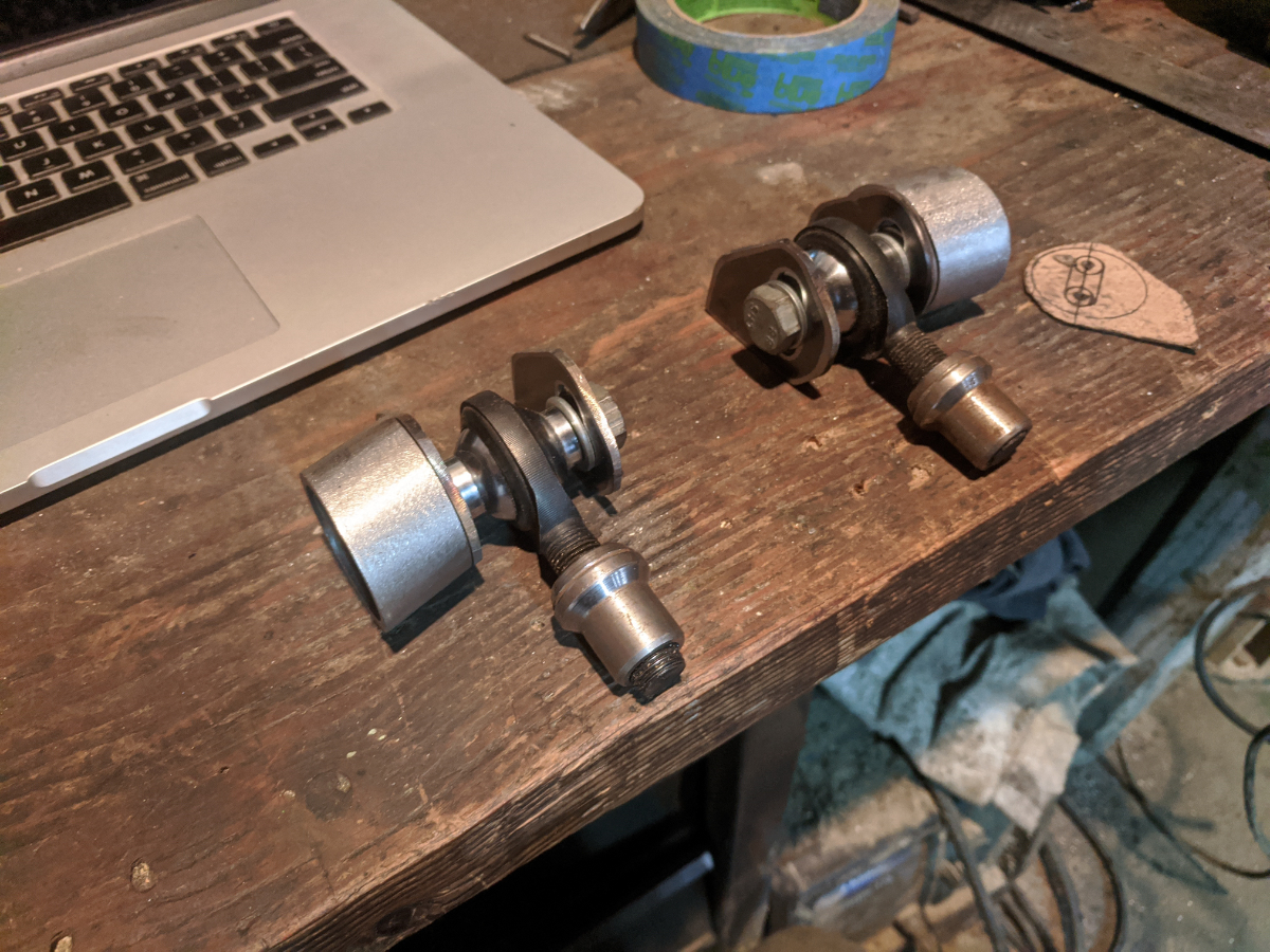

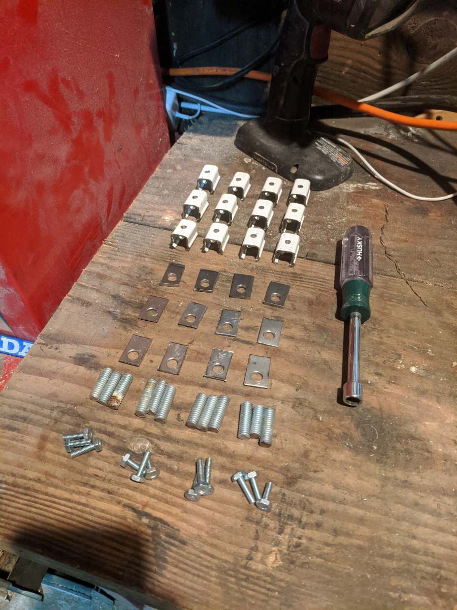

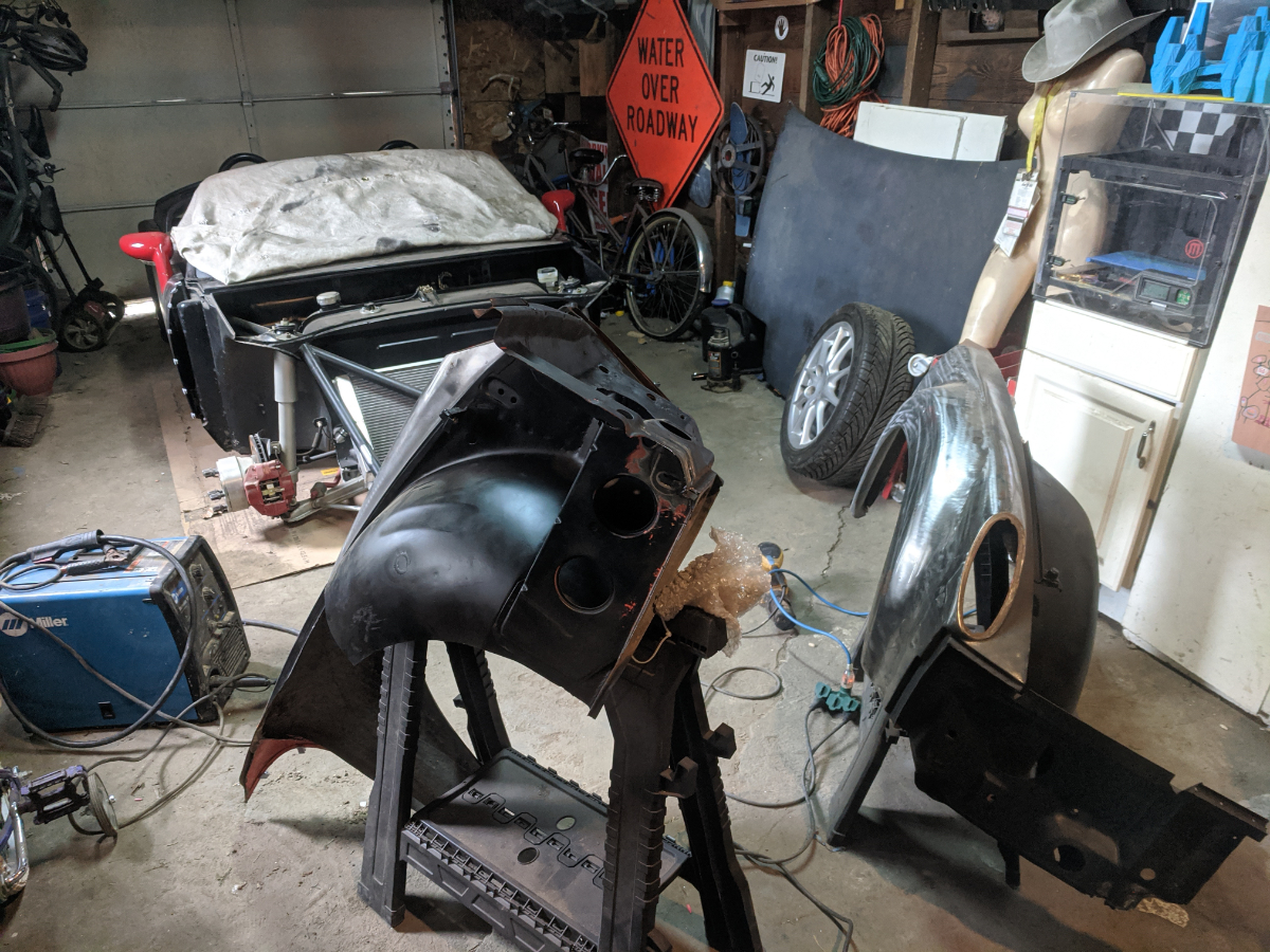

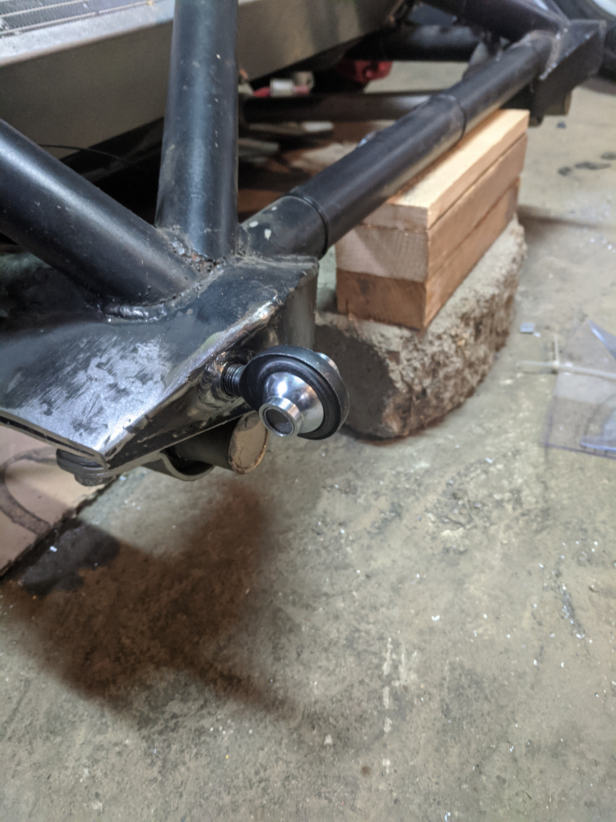

Now onto some real work, I am rethinking the front tilt hinges and going to a simple pivot in the front, this causes issues in other spots but that is a problem for another day.
I prepped the fenders for their new attachment points:
And welded them on:
plymouth37
plymouth37

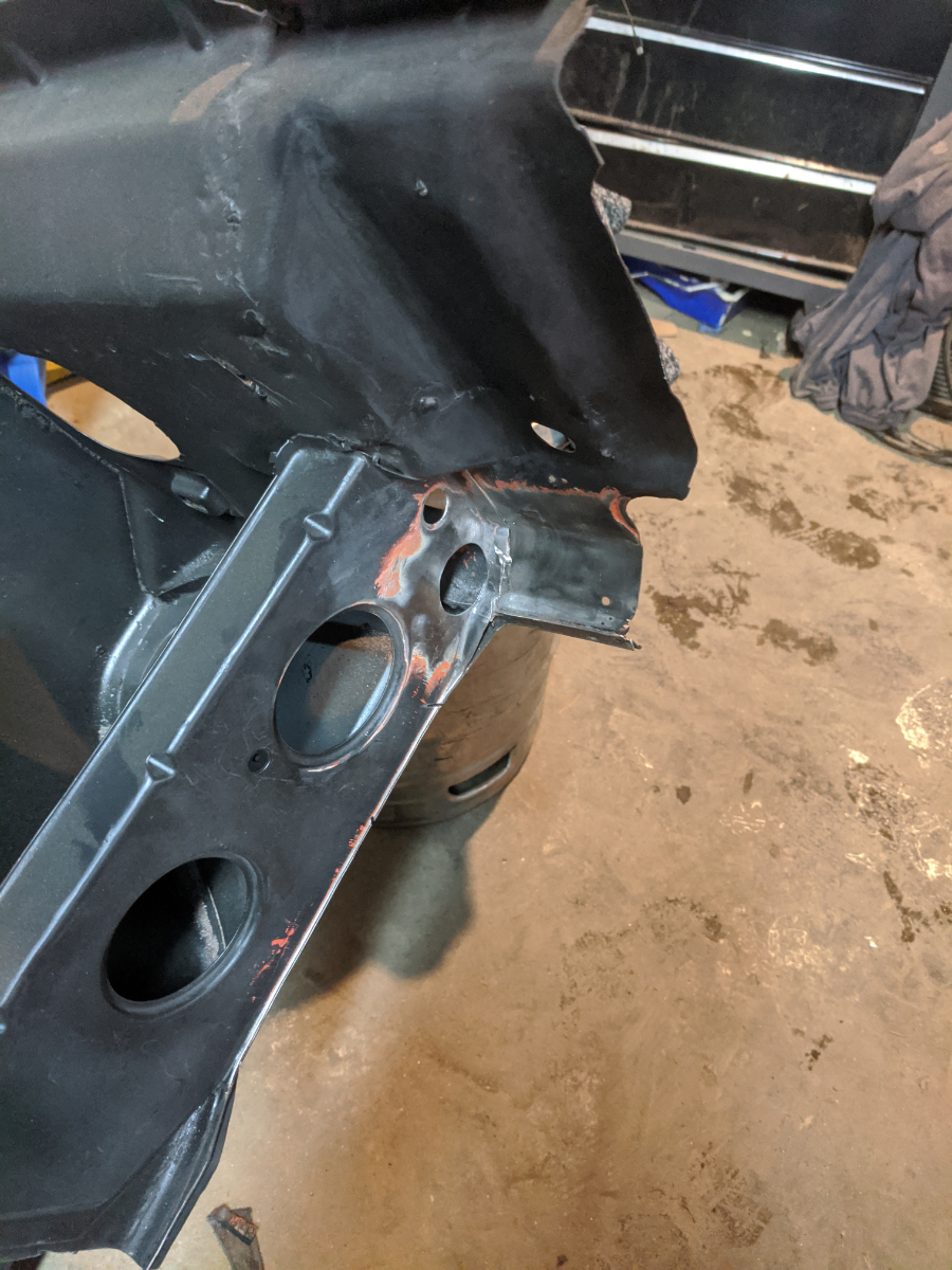

I cut off the old tilt front brackets, and cleaned up the front a little bit.
Welded in the mounts for the new front pivots.
Then mounted the fenders to the new mounts.

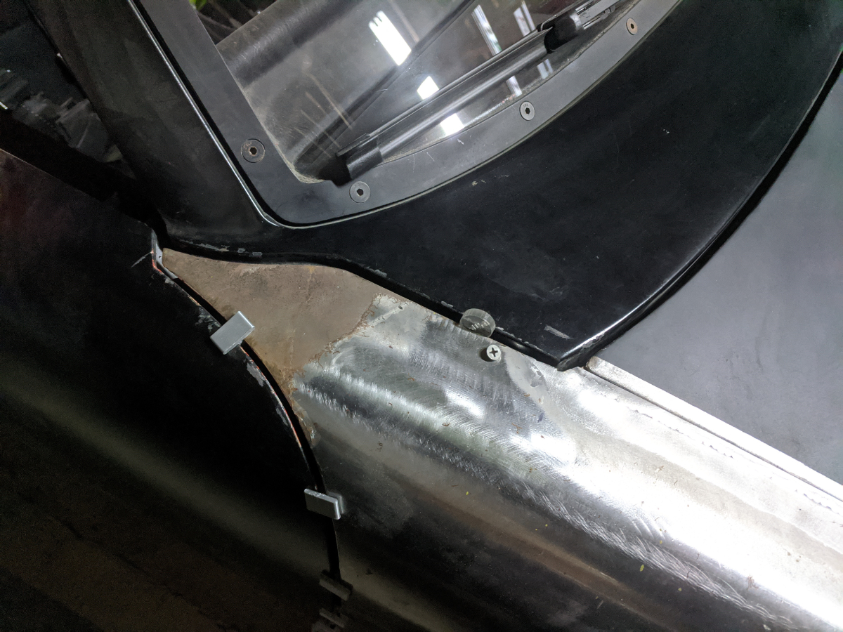

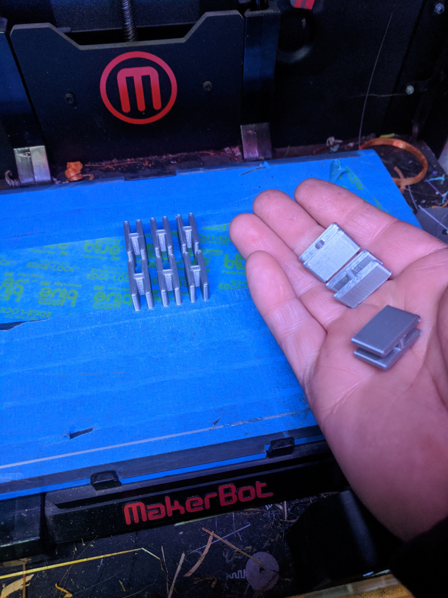

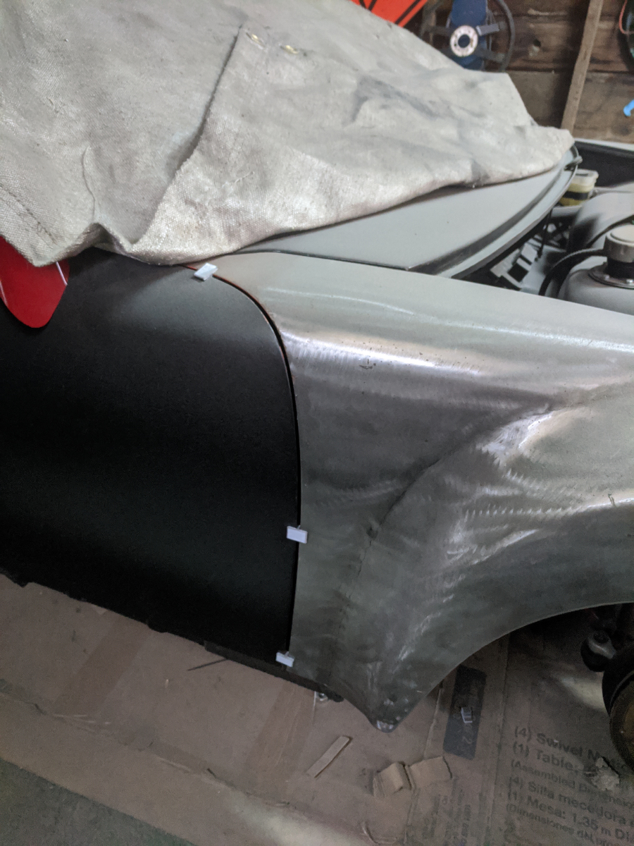

Now that I am setting panel gaps for real I need to make some tools to hold panels in the correct location. I cut out all the ingredients for some panel clamps.
Welded them up.
I also 3D printed some panel spacers.
plymouth37
i am pretty pleased with the 3D printed door spacers, they hold the gap perfect.
Other clamps are working well too.
Now the fenders really seem to be in the right spot and ready to meet the hood.

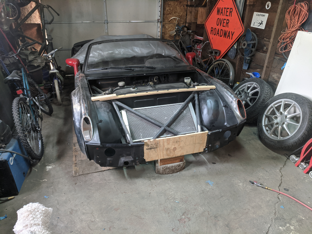

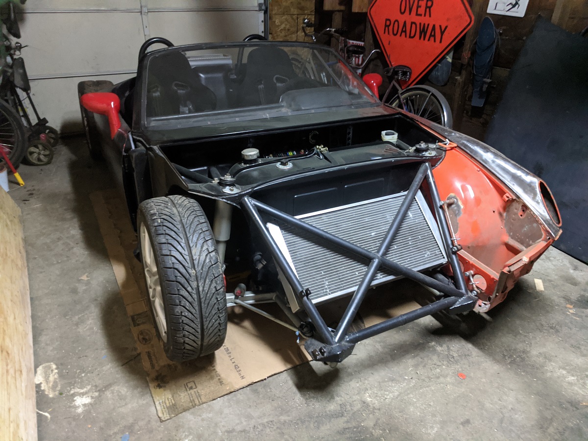

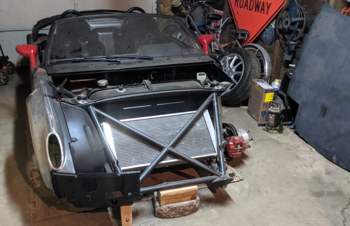

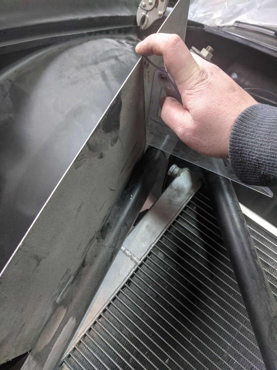

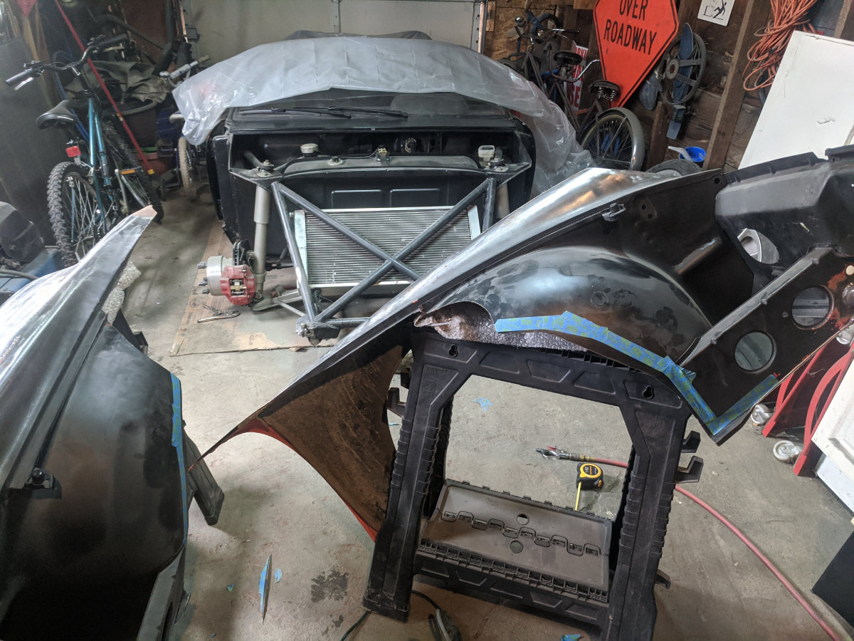

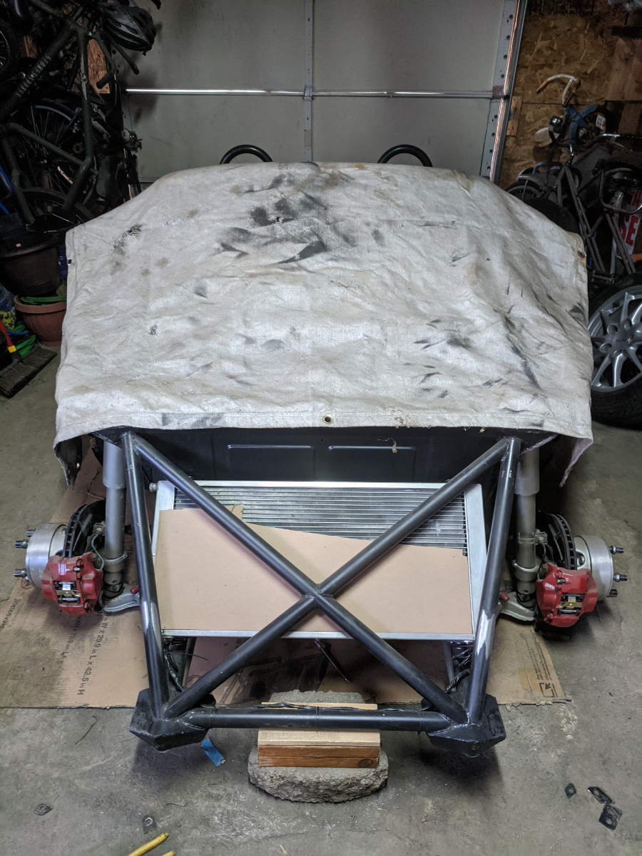

I used a flat sheet held against the cage to mark the inner wheelwell that needed to be clearanced.
Then marked and cut out the excess material.

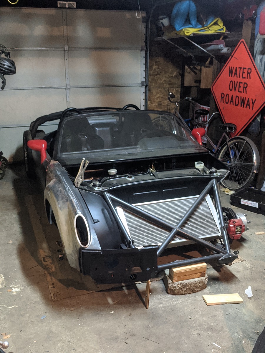

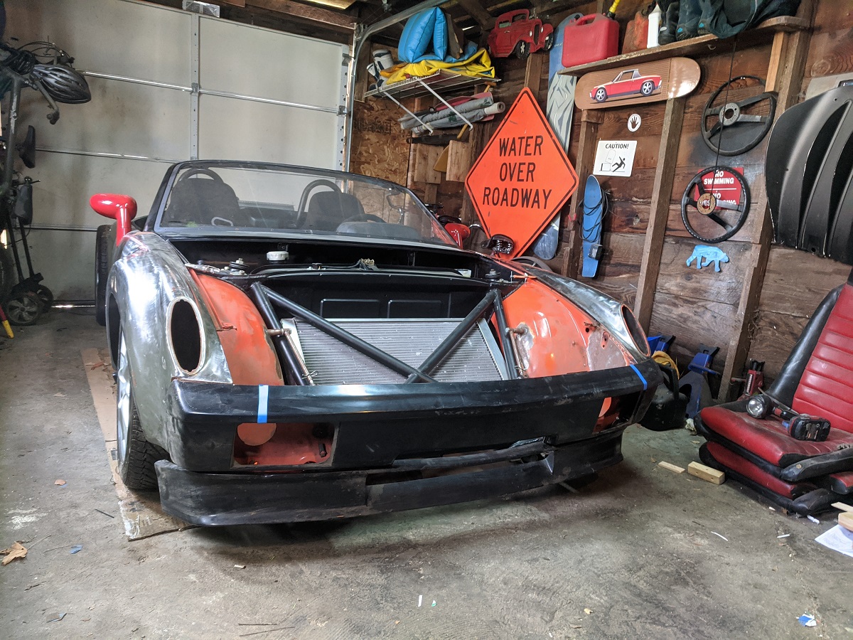

Finally I mocked up the front end for the 100th time, this time though I bolted them onto the pivots, then temporarily reinforced with an appropriate amount of plywood sawzall-smiley.gif
plymouth37
Test tilt time!
Heck yeah! Hood prep is next!

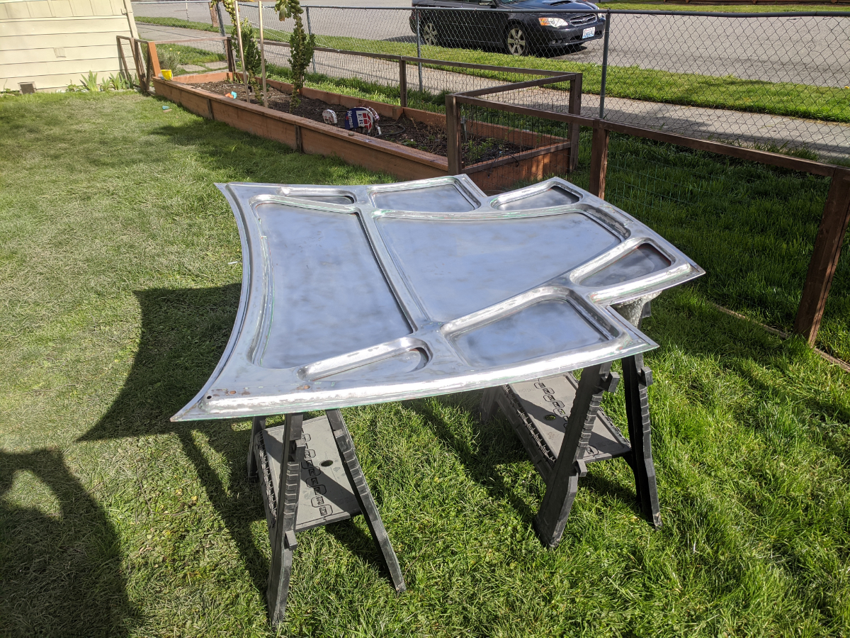

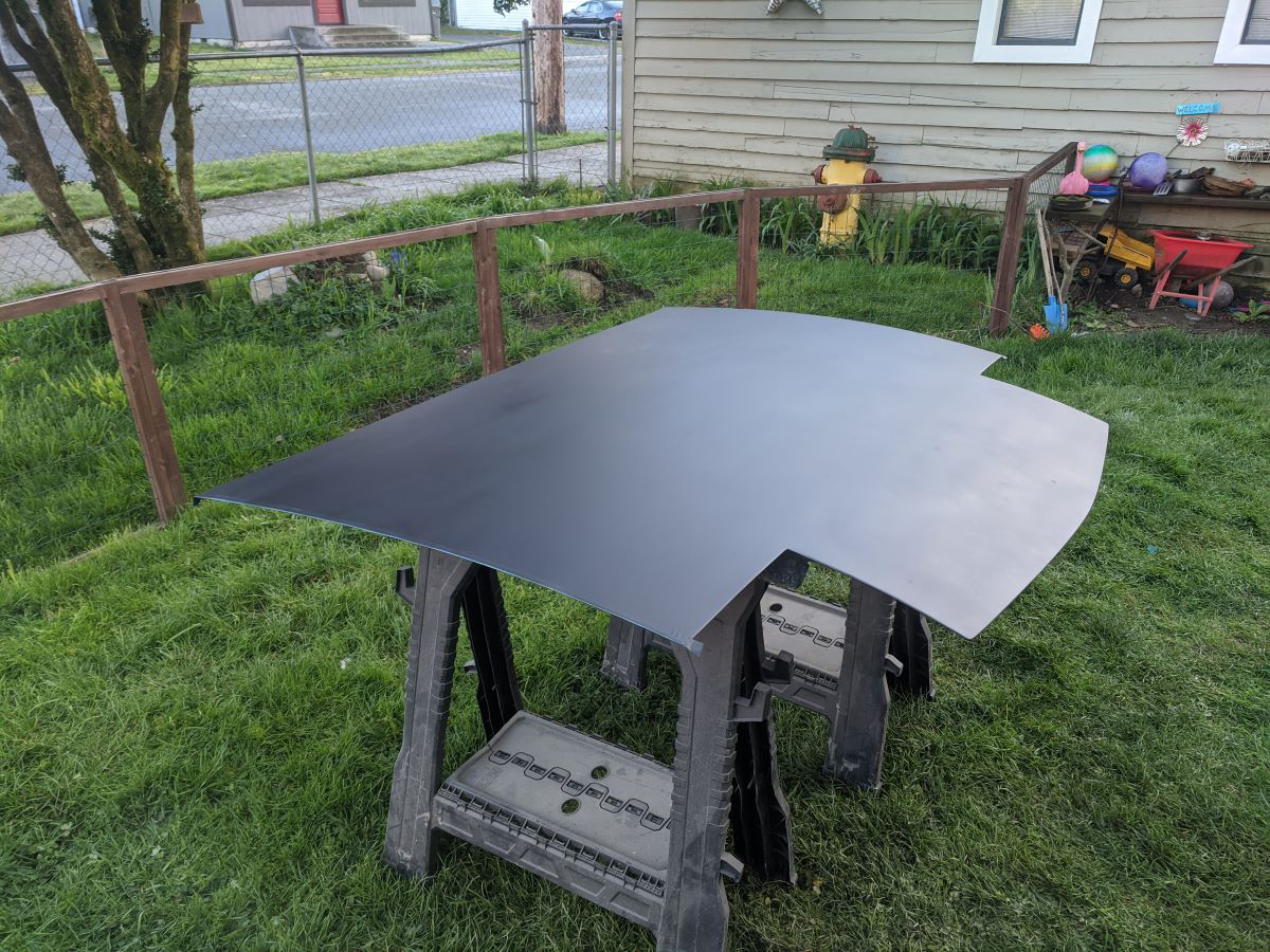

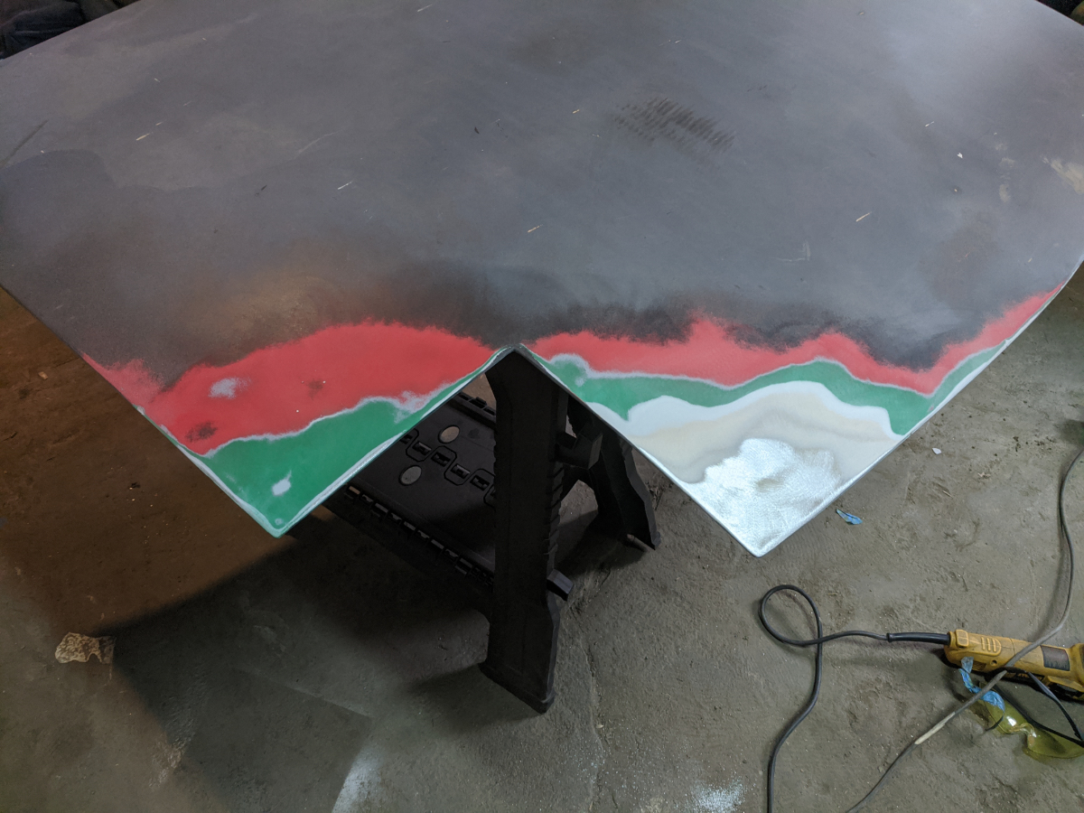

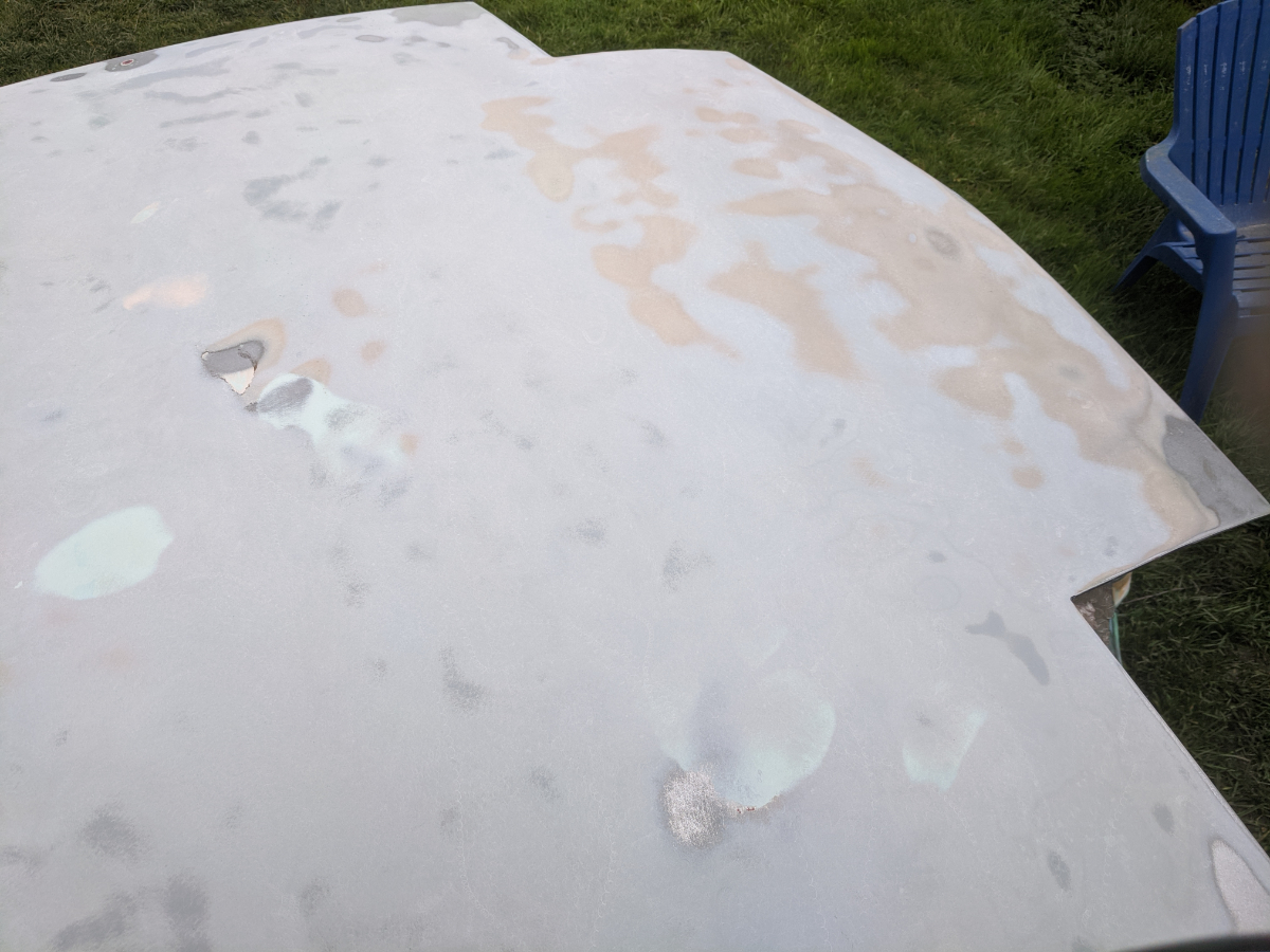

Now onto the hood, I got this lid in a trade and it has always felt a little heavy to me, lets see what is lurking under this paint!
Merry Christmas, your present is Bondo!
A lot of it!
After stripping away pounds of Bondo it looks like this lid is actually pretty clean, it just suffered from the two most common injuries that happen to these lids. The dent where you put your hand to close it, someone closed the lid on a strangely shaped, too big object, oh and there are a few rock dings.
I can totally work with this, an afternoon with a hammer and dolly will get this straight, I think the last person just added Bondo until the high points were hidden, yikes!

Cleaned up the back.
Oh the 220V to the garage is done too, trench is almost undetectable already!
Then shot the whole thing in primer again, looks about the same as before but about 10 pounds lighter!

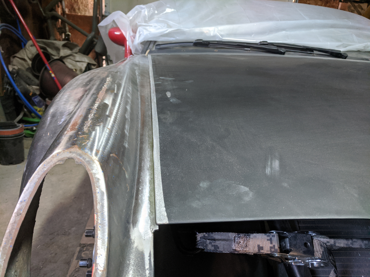

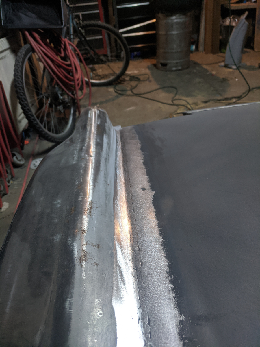

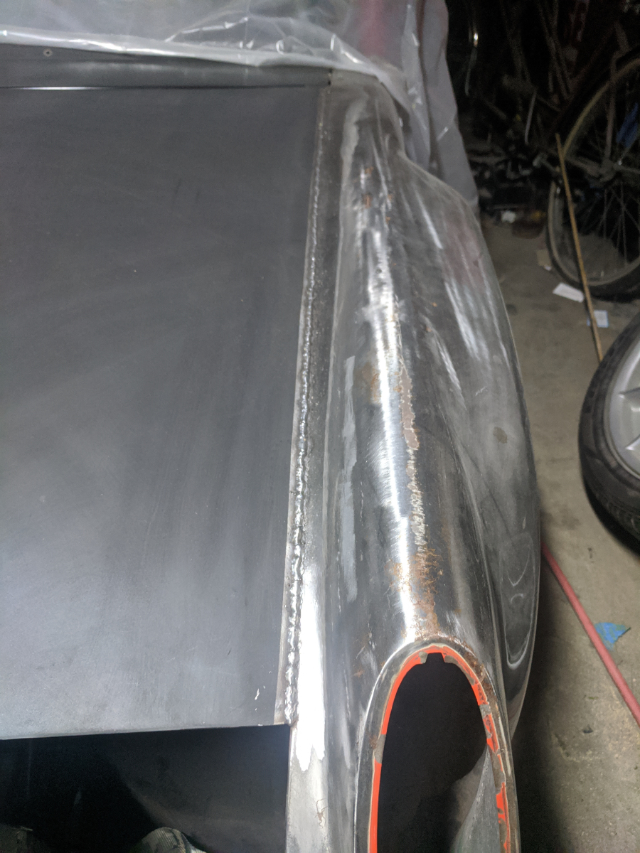

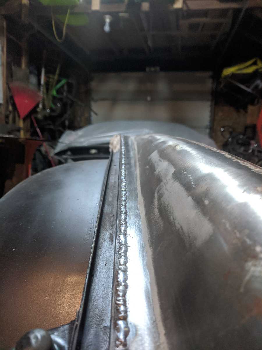

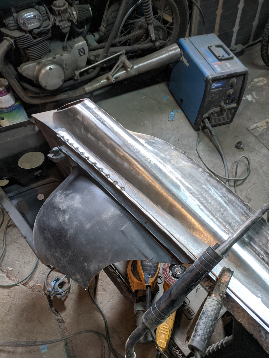

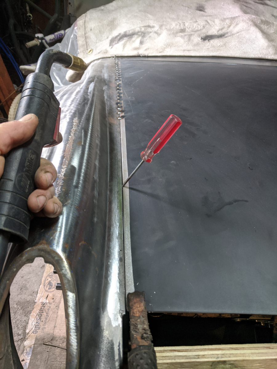

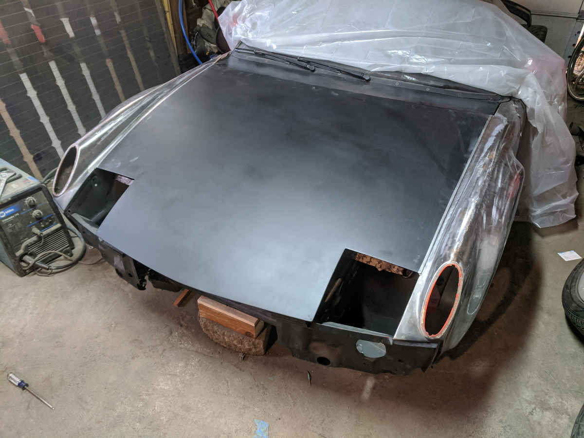

I am going to need to do 2 welds on each side of the hood to attach it to fill the panel gap. I cut a 1/4" wide strip of 1/8' steel and tacked it on.
Between the fold in the fender and the 1/8" material I could sink some good heat into the tacks, but went slow and tacked every inch or so, then every 1/2" then slowly filled in the gaps.
3 feet of weld down, 9 more to go!

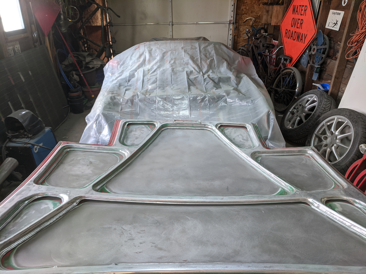

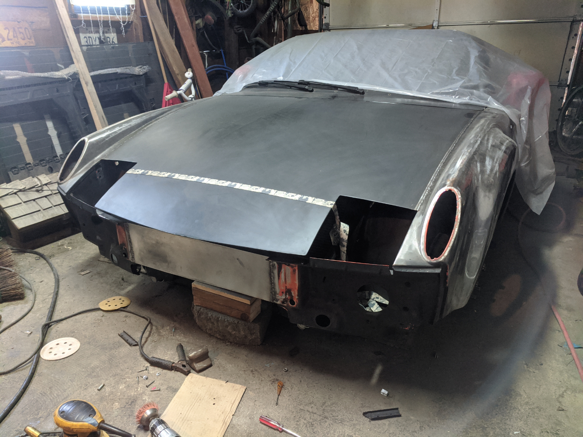

I got both filler strips welded on
Ground the weld down 75% of the way or so, filler strips are also still wide.
You can see I also masked the edges of the hood when I primered it so I have a clean edge to weld to, forethought? What's that?

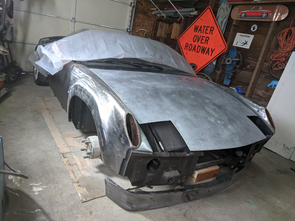

I mounted the fenders, laid the lid on them, now I will mark and cut the hood opening, then weld it in.
plymouth37
QUOTE(Asheikh @ May 4 2020, 05:23 AM) *
QUOTE(plymouth37 @ Apr 23 2020, 01:47 PM) *
QUOTE(Asheikh @ Apr 16 2020, 11:02 AM) *
do u still have your break active spoiler....? can you please share more information on it
I may make another one, that was a relay logic board (would use an arduino now) powering a couple linear actuators attached to a cut portion of the original trunk lid.
didn't have it for long, can't even find a pic!
aktion035.gif haha, forgot how cool that was! Damn I look young!
plymouth37

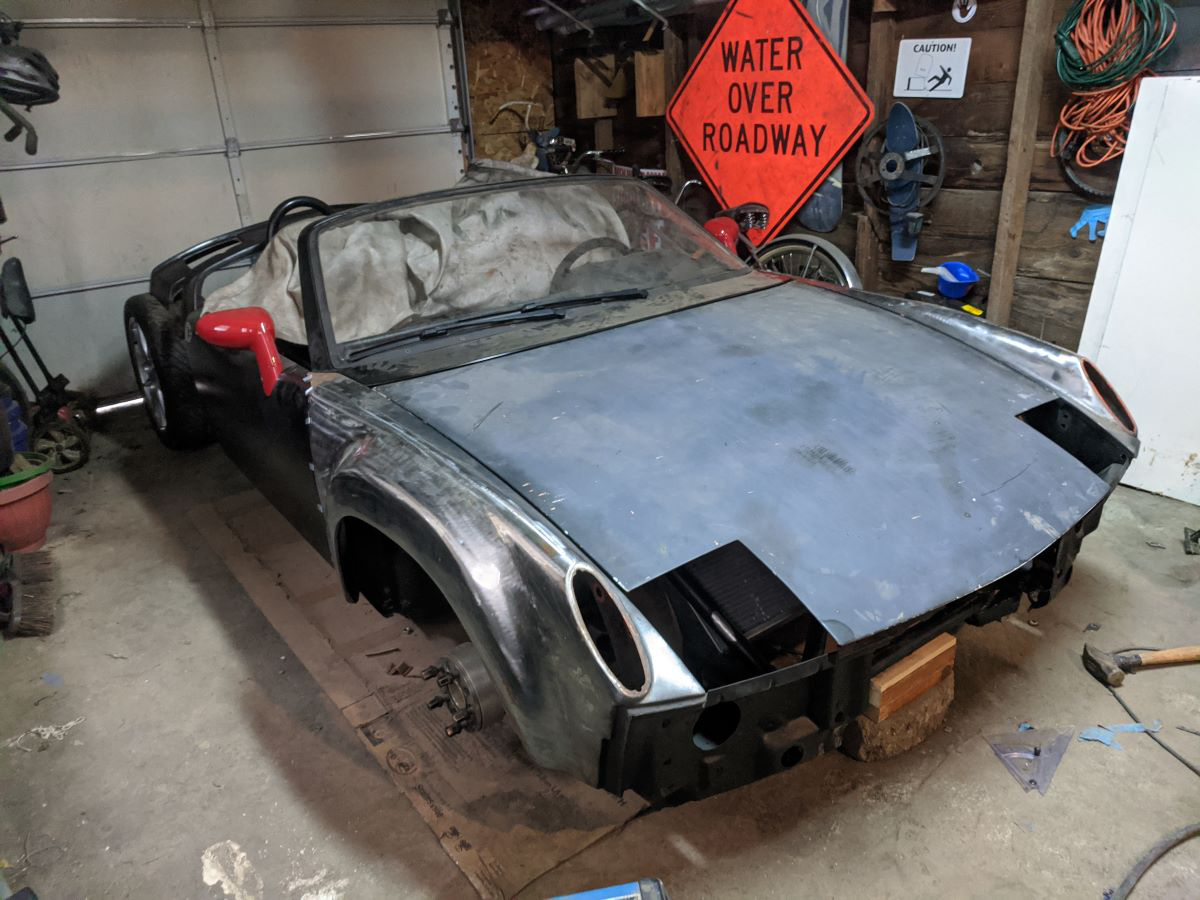

I got the fenders aligned and mounted.
Cut down my oversized fenders to fit the lid, (sheetmetal screw included for added accuracy).
Here we go!

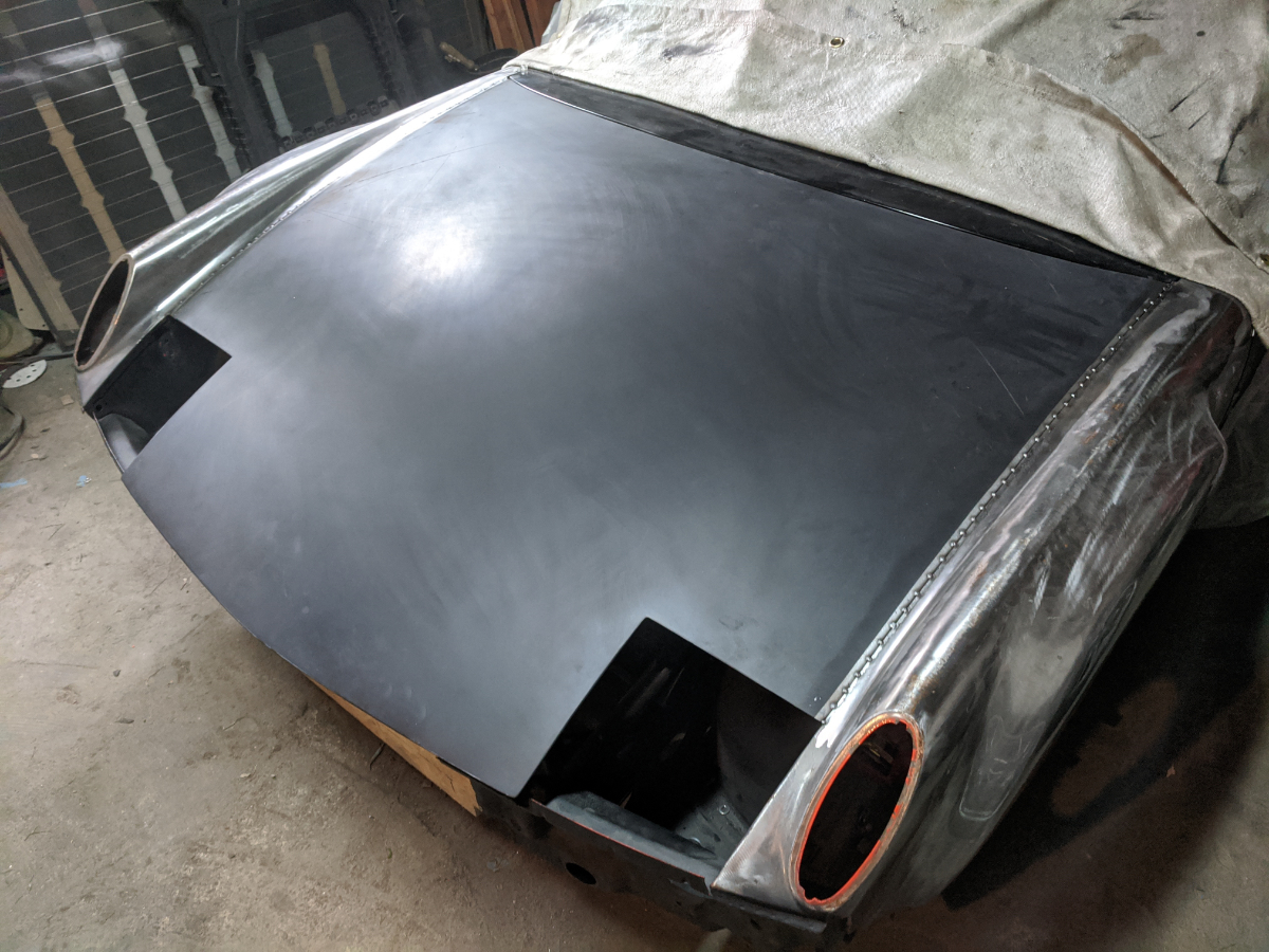

Hood is tacked on, gaps still look good, time to fully weld the lid on and move on to rebuilding the front inner sheet metal.

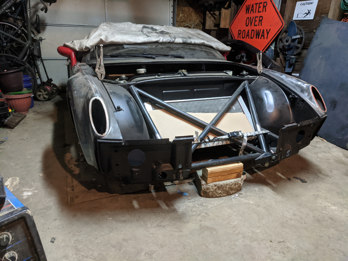

plymouth37
Finished welding the lid on, also welded in a filler panel for the old radiator opening.
I am going to re-cut the front opening once I get the bumper figured out but I really think the hole can be much smaller than it was before. We were just copying the design for the V8 cars at the time but I think that is way oversized now that I have lived with the car for a while.
Then I finished the welds, should be able to finish this seam with a light skim coat of filler.
(found another dent in the hood too biggrin.gif )
Next I am going to rebuild the structure that attaches the front hood structure to the nose of the car and make some headlight filler pieces.
