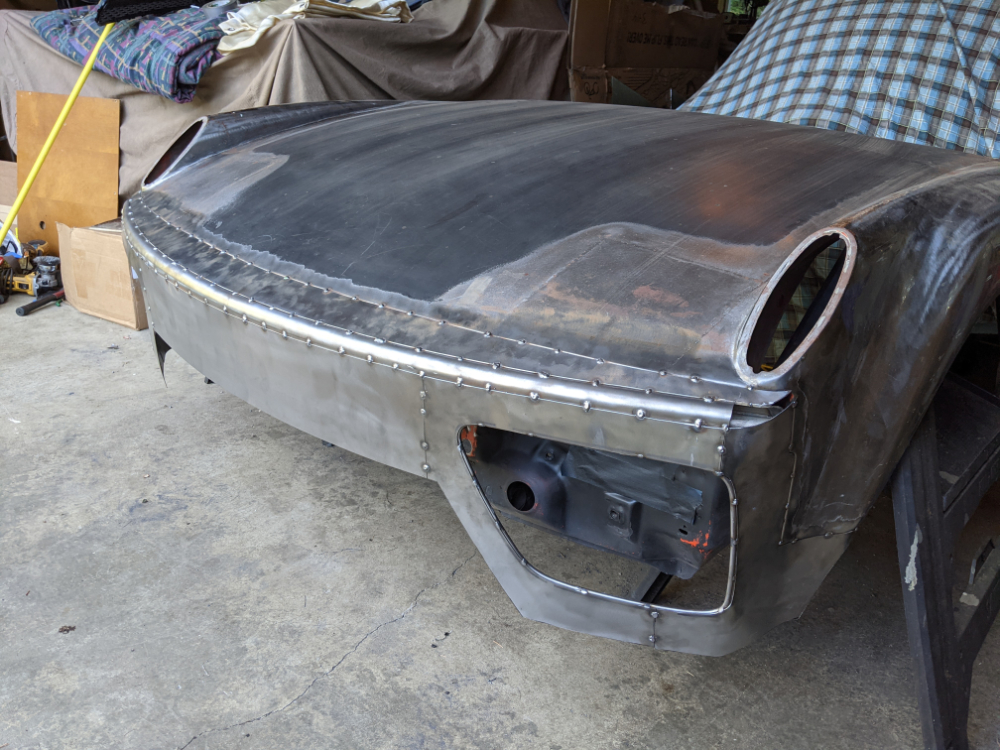

QUOTE(plymouth37 @ Jun 3 2020, 02:08 PM)
Next I am going to rebuild the structure that attaches the front hood structure to the nose of the car and make some headlight filler pieces.
Click to view attachmentAwesome work as usual. Such a cool build.
Pic above reminds me: Why does the 914's nose always look so good when the headlights and their trims are missing? There's just something right about those voids in relation to the other shapes of the front end.
Not that I know what to do with them...other than fill them or reinstall the headlights.

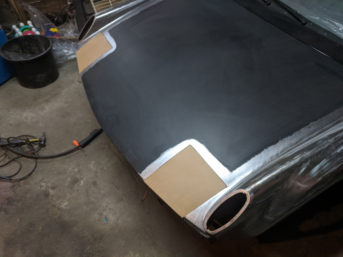

plymouth37
Jun 19 2020, 01:34 PM

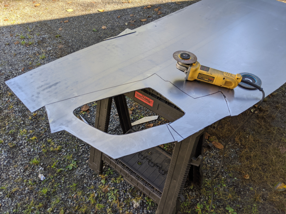

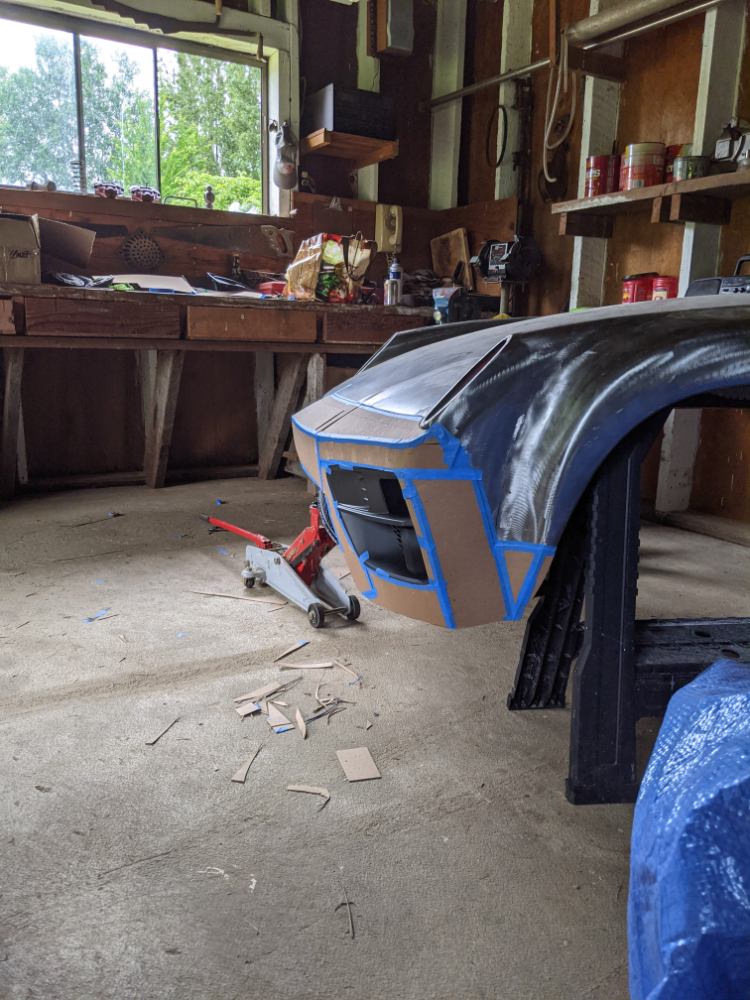

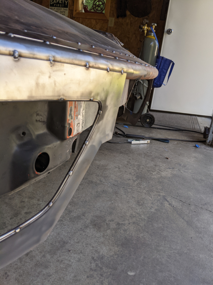

Whipped up some cad templates...
Click to view attachment Transferred them to steel.
Click to view attachmentTacked them in.
Click to view attachmentFinished the welds to about 90% and shaped the front edge, need to rethink the cowl separation line next then we can do a test tilt with the complete nose!

QUOTE(plymouth37 @ Jun 19 2020, 12:34 PM)
Tacked them in.
Click to view attachmentBuuuut, you are well on your way now. Suspect this will also look great.

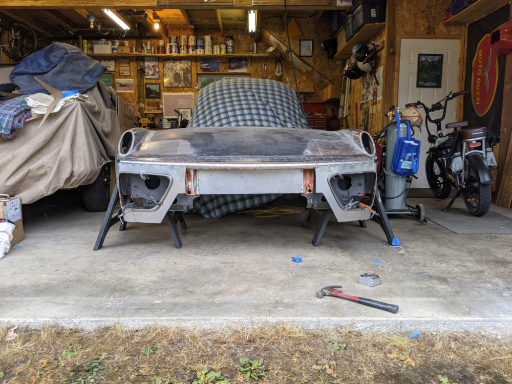

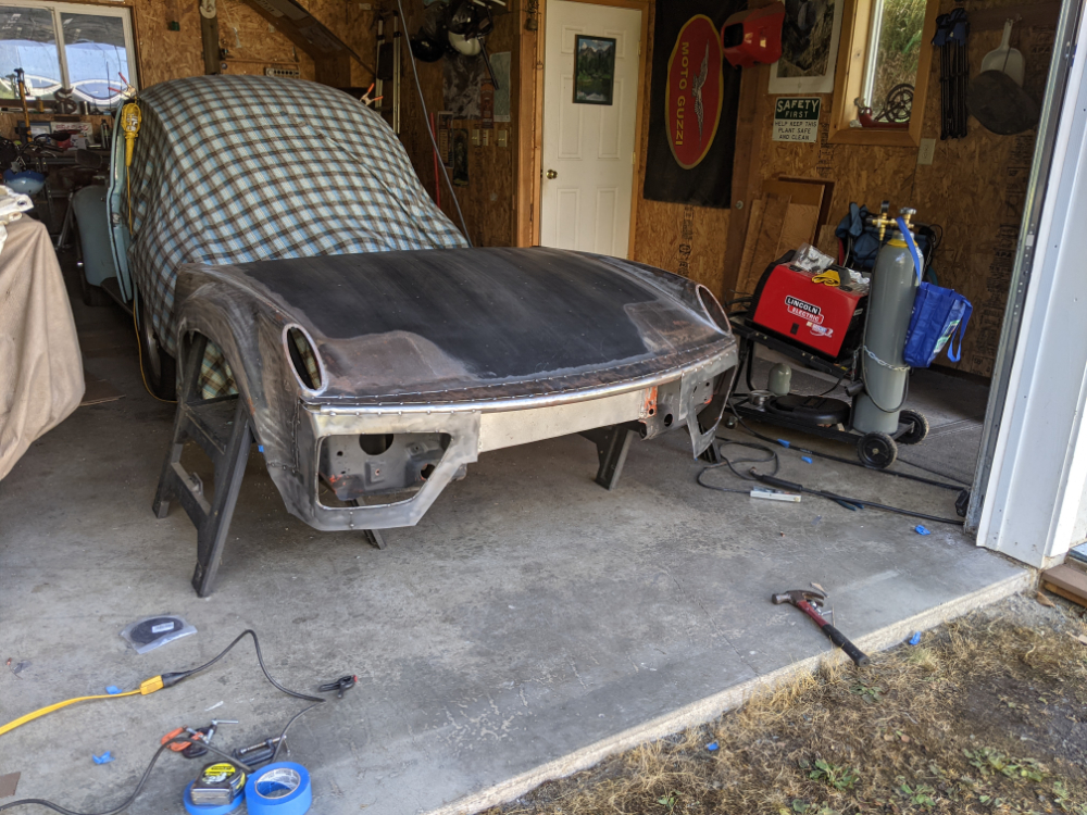

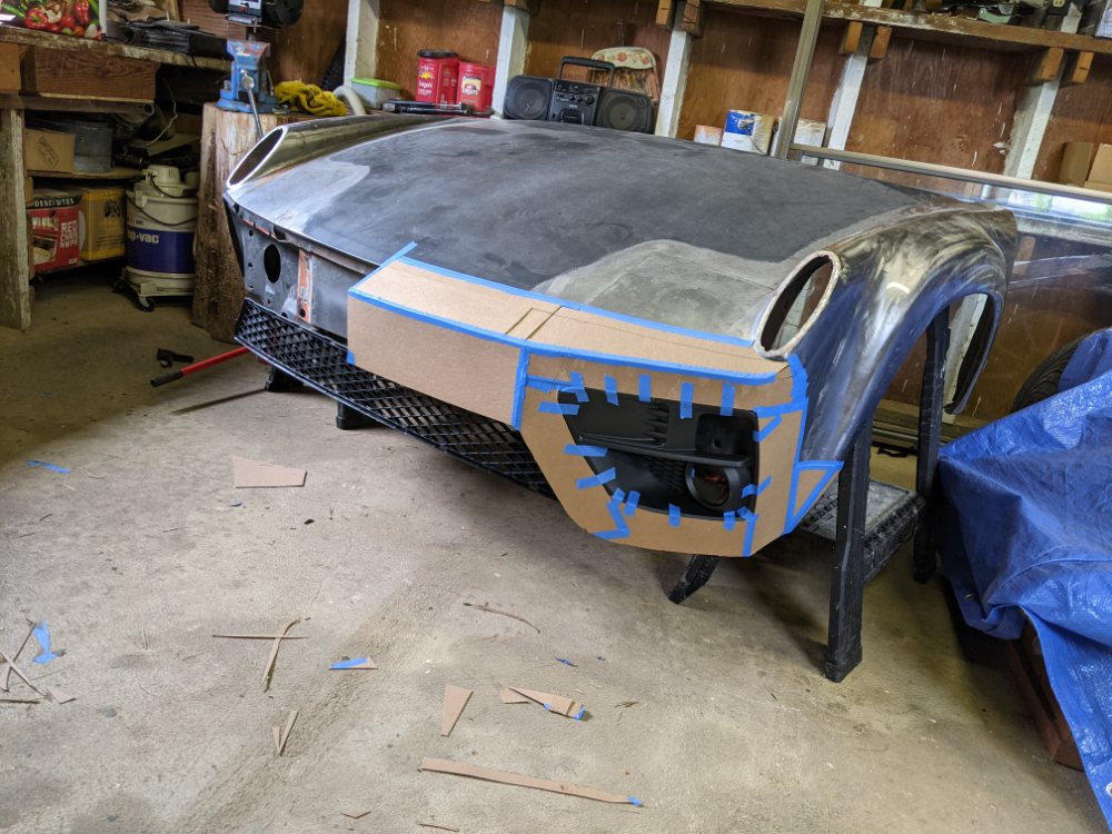

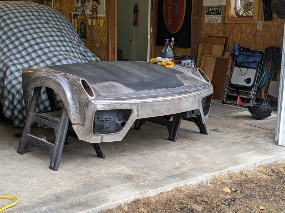

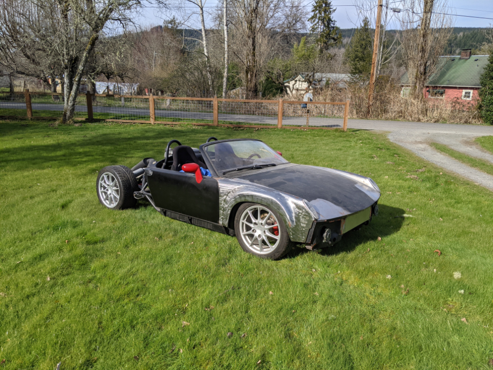

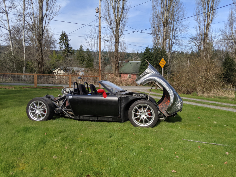

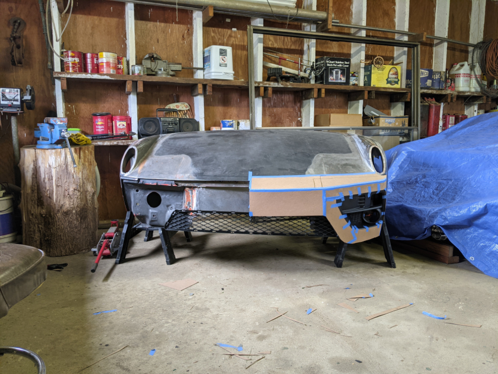

I'm BAAACK! Actually, I never really left, just did a couple other projects, built a house, took about a year off the car, but never fear, progress has been made, and now it is time to share the last year of work with you.
Here is where I left off, the front clamshell was just about together, just waiting for a bumper and some bodywork:
Click to view attachmentClick to view attachmentClick to view attachmentClick to view attachment

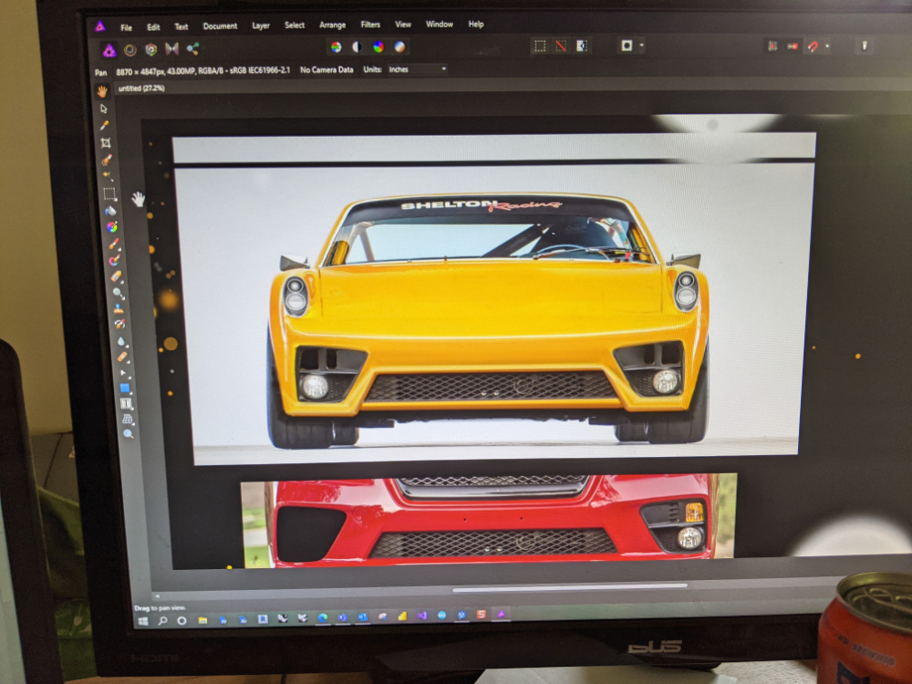

I went to bolt on my fiberglass stock-ish bumper and just could not talk myself into liking the look of it, I have just modified this car too much to bolt on something off the shelf. I started researching 916 bumpers and a post on 914 world resonated with me, someone complained that fiberglass 916 bumpers fit so bad that they might as well build one themselves, so that is what I planned to do. The new bumper will be made from steel and modeled after a new take on the 916/Porsche design aesthetic.
This is my design inspiration board, a hint of 916, some contemporary Porsche, and a hint of the similarly styled wrx.
Click to view attachmentUsing the wrx grills as a loose starting place I did some sketching in Photoshop to get in the ballpark

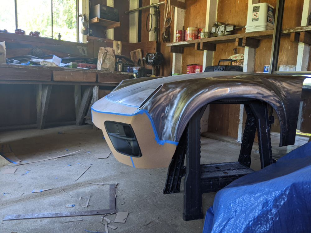

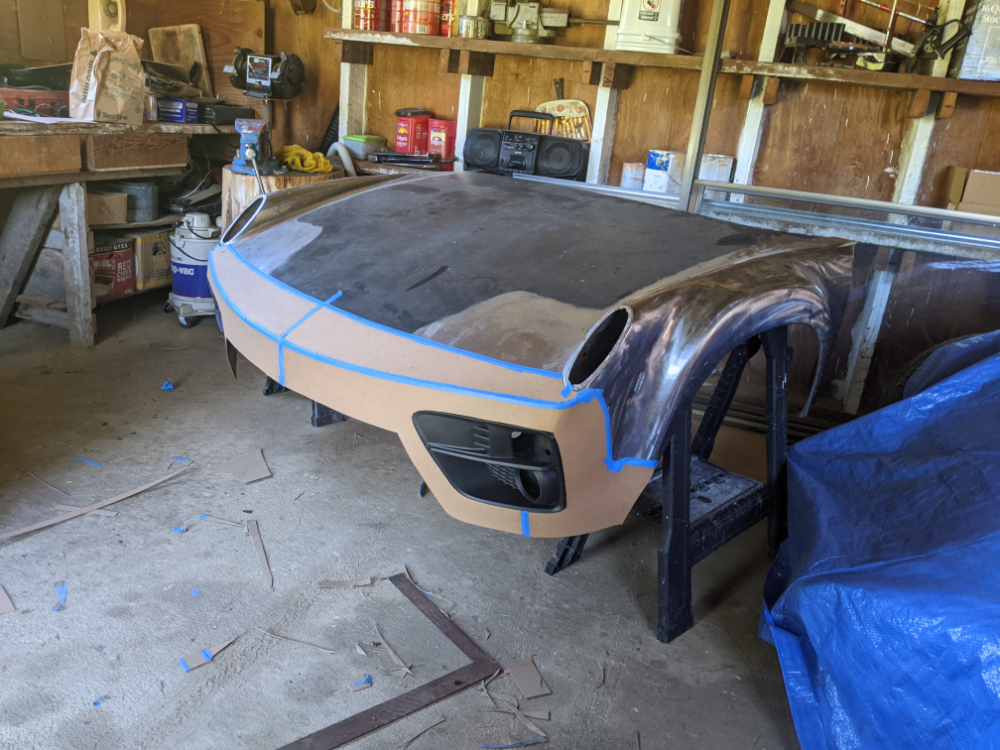

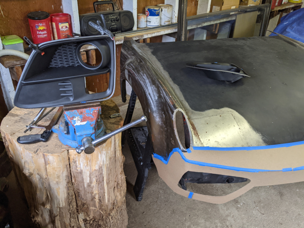

I started feeling out the shape by buying a 2014 wrx grill set and trying to integrate them into the 914 with chip board, still rough but I am starting to get a sense of the 3-dimensional shape that will be required to get everything to flow together.
plymouth37
Nov 9 2022, 05:44 PM
After I got that in the ballpark I remade my templates and mirrored them for the other side, there are still some waves in the template seams but I have a trick for that.
Stay tuned for next week where I get out the tubing roller and start welding in some structure!

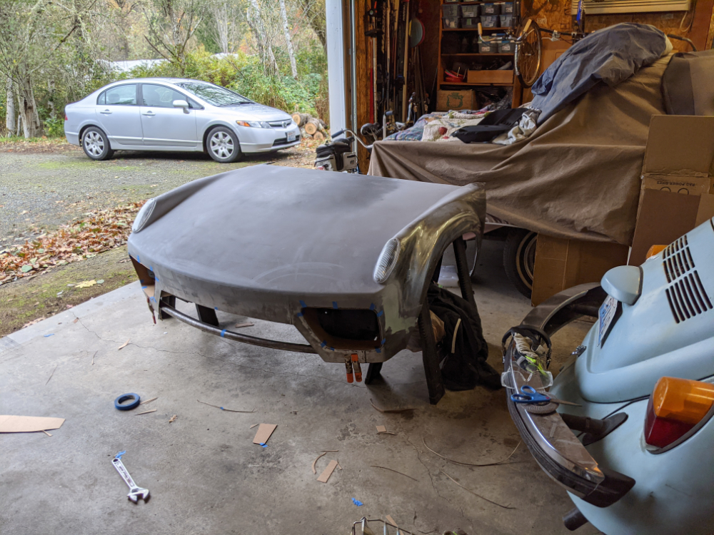

plymouth37
Nov 12 2022, 08:17 PM

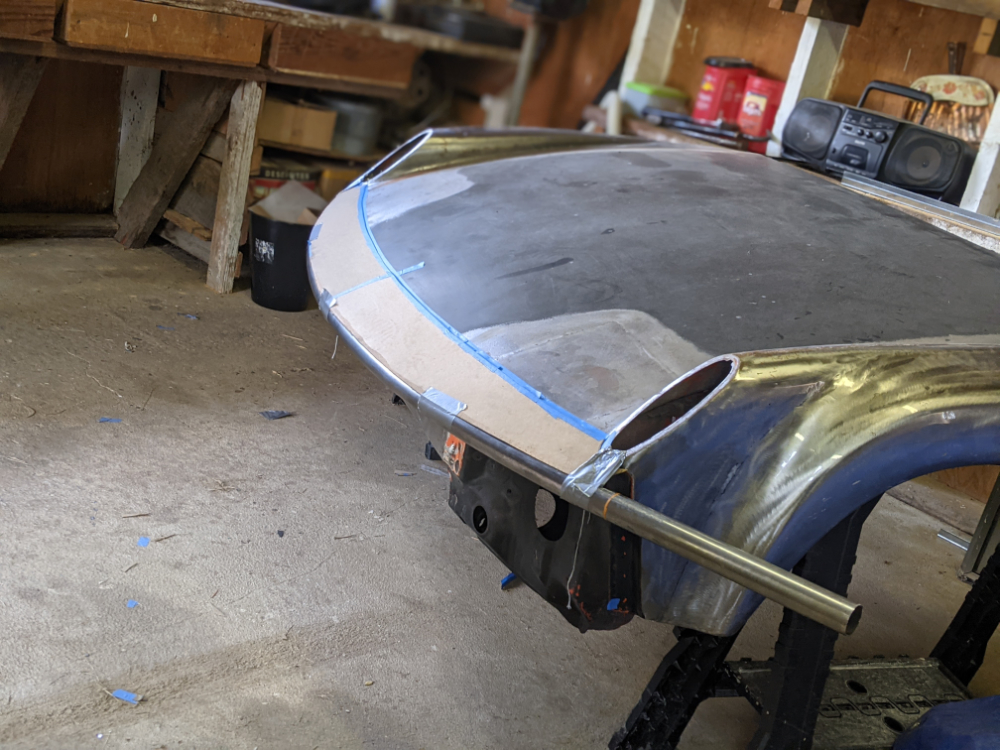

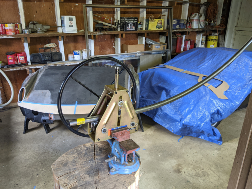

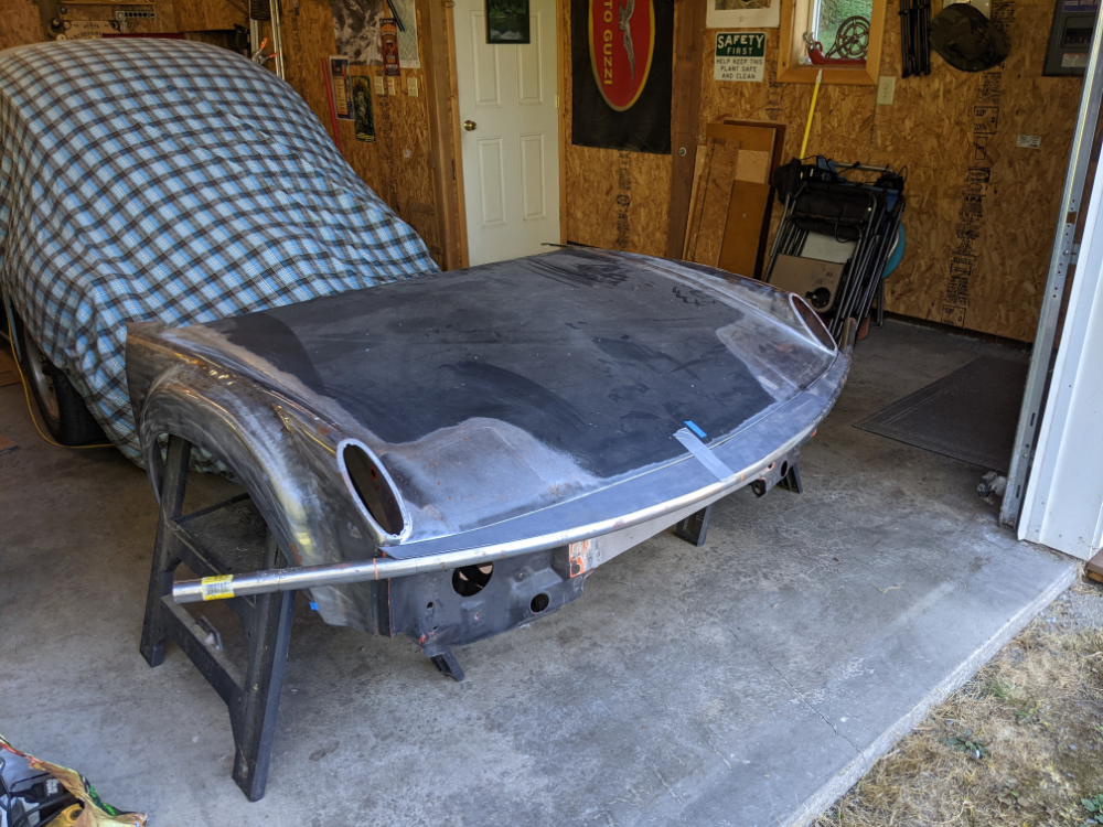

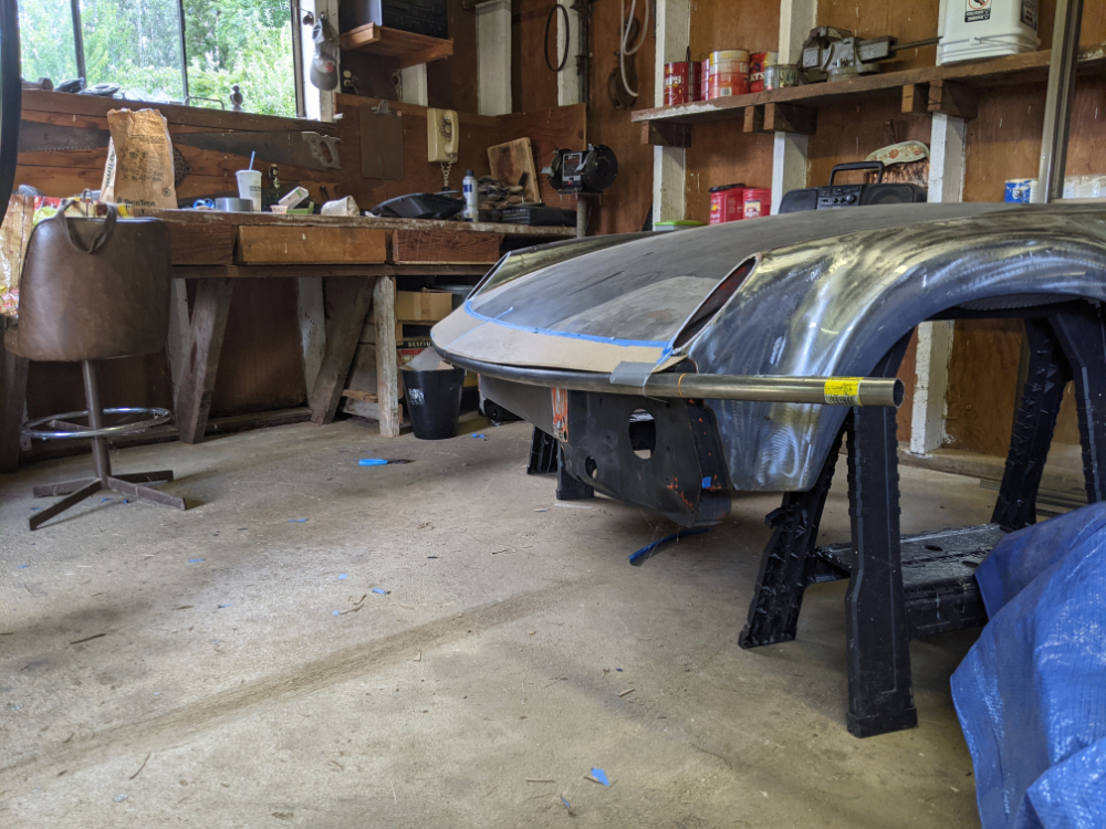

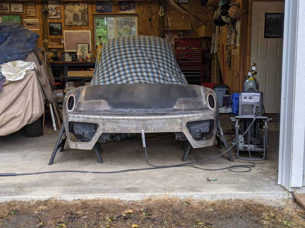

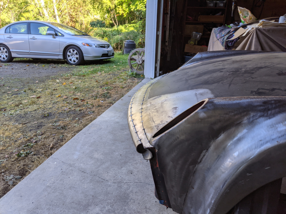

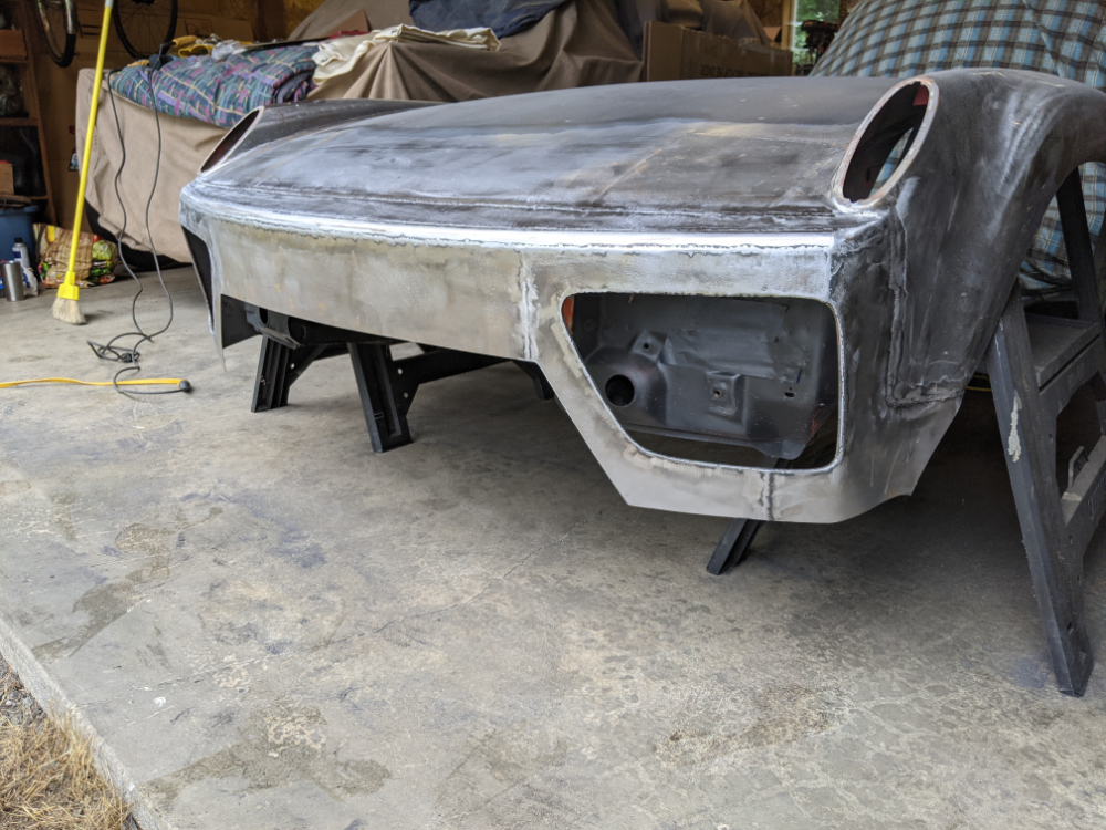

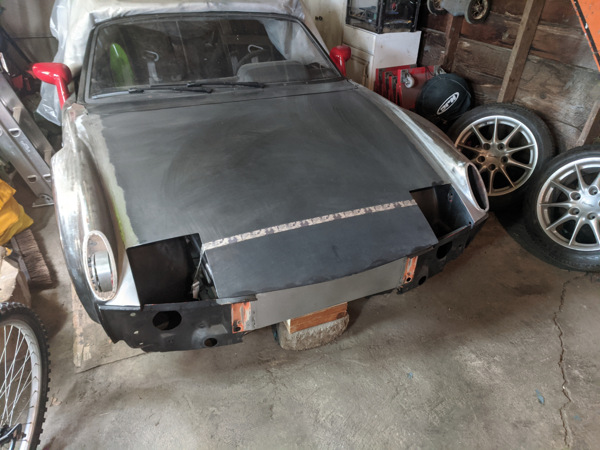

One of the most distinctive design characteristics of many Porsches new and old is the rounded transition from the hood surface to the vertical bumper surface, as you can see in this random assortment of Porsche bumpers:
Click to view attachment This would be a really hard dual curvature piece to fabricate so I figured out a hack, I bought a relatively cheap tubing roller at Harbor Freight and some .0625 wall 1.5" tubing and rolled the shape I wanted into it. It isn't a continuous curve, it is a little more rounded in the middle, and a hair flatter around the side grill areas
Click to view attachmentThen I duct taped it into place:
Click to view attachmentI had initially planned to cut out a quarter of this tube and butt weld it to the other sheet metal but it doesn't weigh much, and i kind of like the idea of an integrated bash bar in here so I think I will leave it whole and build the rest of the bumper around it.

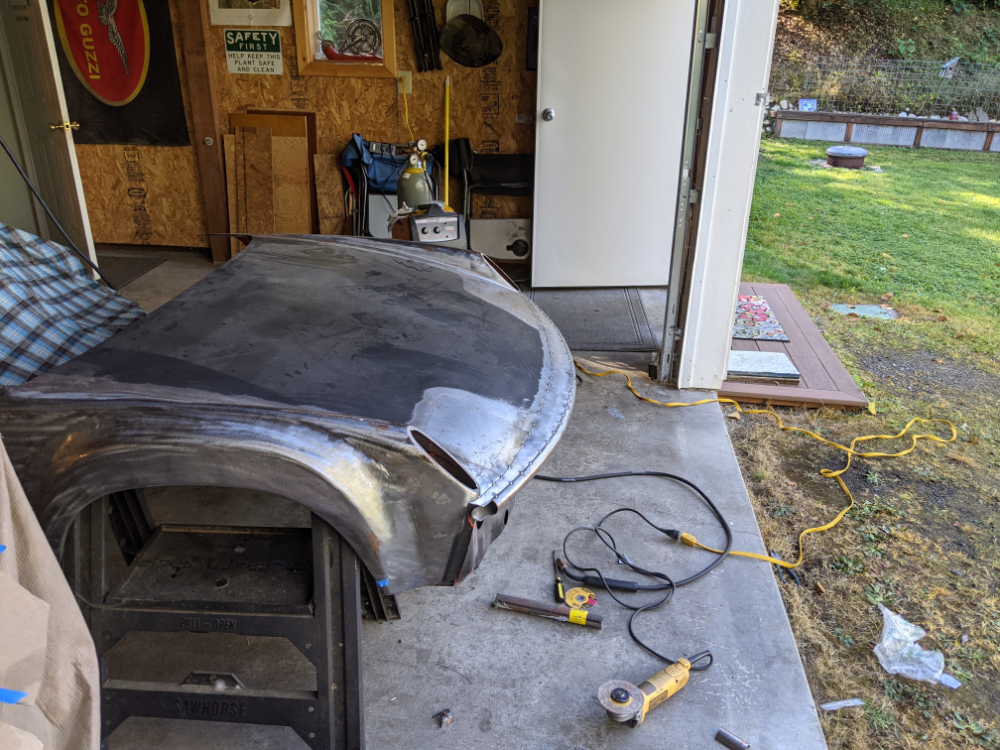

plymouth37

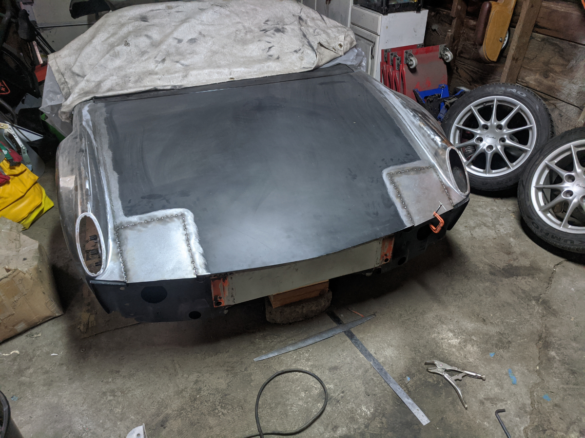

After rolling out the tube I cut out some sheet metal for the hood extension
Click to view attachment Then welded the tube to the inner structure of the nose, and tacked the hood metal into place:
Click to view attachmentClick to view attachmentNext I put the template back on and gave it a look, definitely getting there, don't worry about the plastic grills, they are only for reference, I have a better final piece planned for those spots

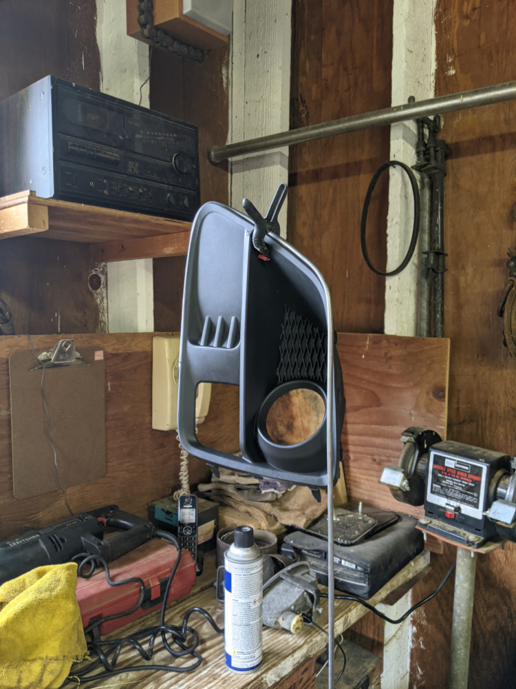

Dec 2 2022, 03:48 PM

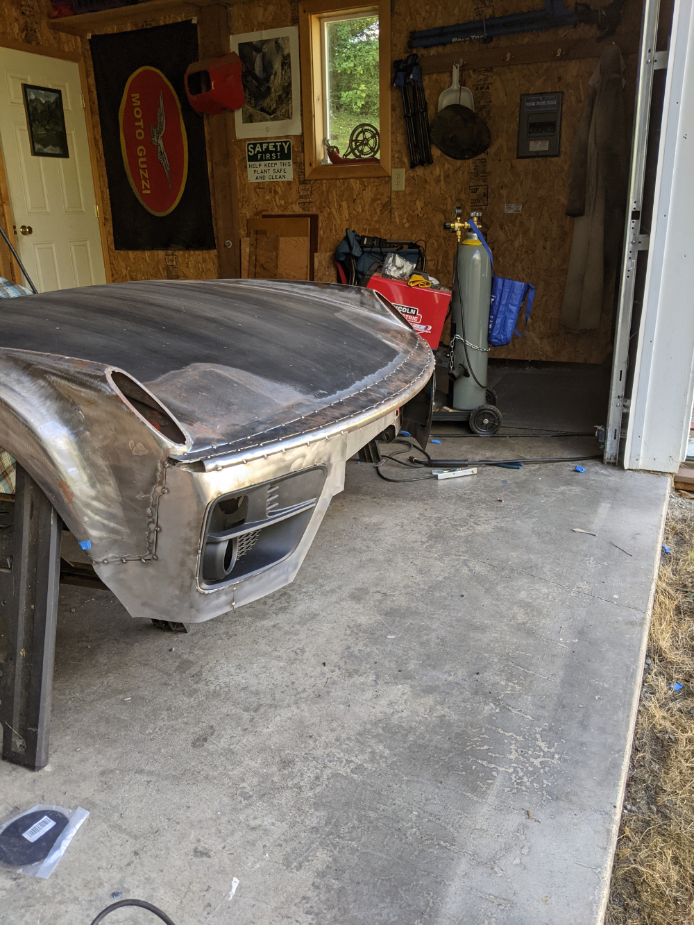

Time to fabricate the front of the bumper, I started by bending 1/8" steel round stock into frames for the fog light housing.
Click to view attachmentI am not going to use these plastic pieces but they make great mirrored templates for the opening shape that I need to integrate into the bumper.
Click to view attachment Then i transferred my chipboard template from the bumper to a sheet of steel, I decided to make the bumper out of 3 pieces, the 2 complex corner pieces and a simple middle rectangle between them.
Click to view attachmentI tacked the corners along their top to the curved tubing and folded them into shape, then clamped the fog light housing frames to them to find where everything needed to land.
plymouth37
After much fiddling and hammering I got the corner pieces tacked into place.
Click to view attachmentThe round stock I formed for the foglight housings is tacked inside the bumper opening to form a radiused transition.
Click to view attachmentHere it is lightly tacked in and with the temporary Foglight housings but I am pretty happy with the results, I will fill in the middle and the weird hole in the corners next time!

Tacked in the center piece:
Click to view attachmentFilled the little corner gaps around the tube ends and half welded everything together:
Click to view attachmentFinished welding:
Click to view attachmentWith a little light grinding it is starting to take shape!

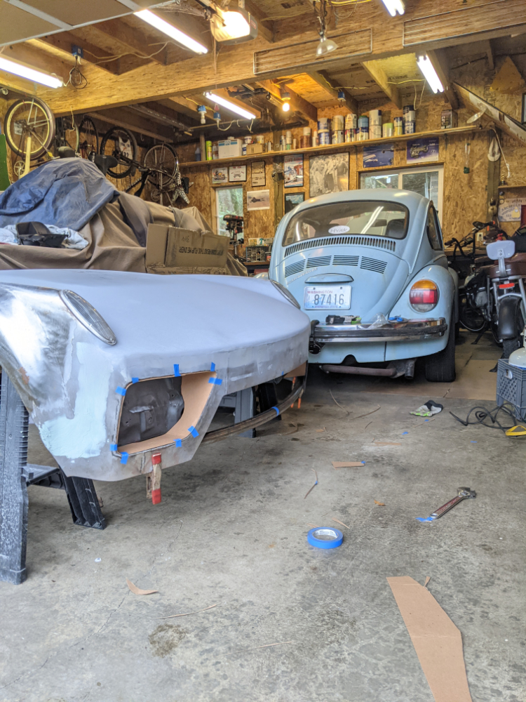

plymouth37
Dec 5 2022, 12:13 PM

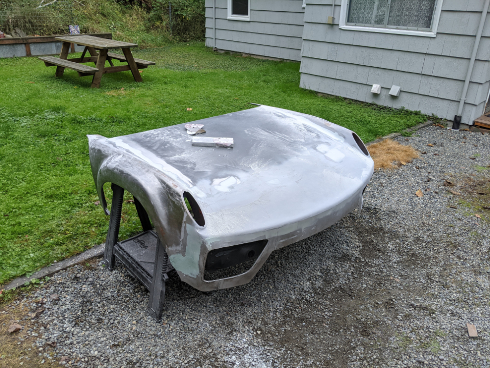

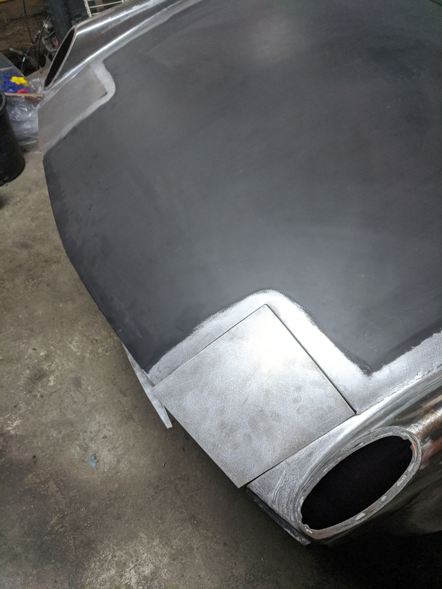

Before I moved on to the grills and lips I filled and primed the hood extension to cut down on the Frankenstien weld aesthetic I had going on there.
Click to view attachment I got it close to straight, good enough for now, now on to the front bumper fab:
Click to view attachmentI made some templates for the fog light housing buckets, and started mocking up the lip for the center grill opening:
Click to view attachmentThis lower bar will divide the air between the radiator and the active under tray that leads to the Ferrari diffuser at the back, as well as providing a sturdy mounting point for the new front tilt system. I like the look of the "pouty" 916 bumper and will try to have a bit of that going on here:
