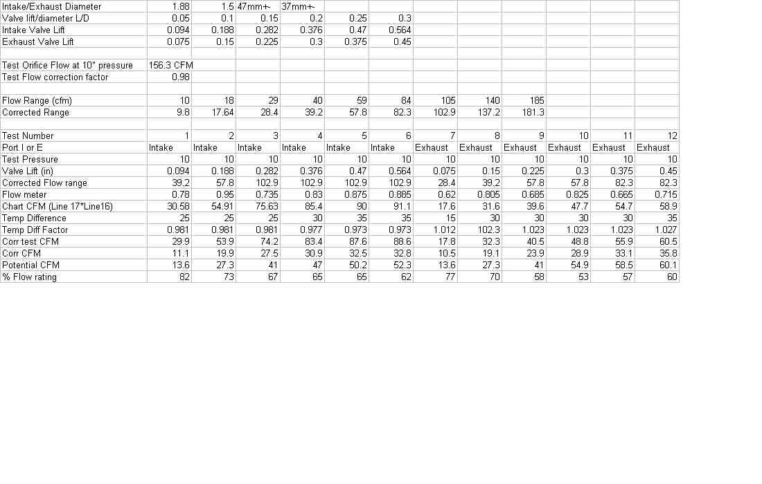

Cant seem to upload spreadsheets....... <_< <_<
Error message telling me no bad boy go away...
So try to decipher this
Intake/Exhaust Diameter 1.88 1.5 47mm+- 37mm+-
Valve lift/diameter L/D 0.05 0.1 0.15 0.2 0.25 0.3
Intake Valve Lift 0.094 0.188 0.282 0.376 0.47 0.564
Exhaust Valve Lift 0.075 0.15 0.225 0.3 0.375 0.45
Test Orifice Flow at 10" pressure 156.3 CFM
Test Flow correction factor 0.98
Flow Range (cfm) 10 18 29 40 59 84 105 140 185
Corrected Range 9.8 17.64 28.4 39.2 57.8 82.3 102.9 137.2 181.3
Test Number 1 2 3 4 5 6 7 8 9 10 11 12
Port I or E Intake Intake Intake Intake Intake Intake Exhaust Exhaust Exhaust Exhaust Exhaust Exhaust
Test Pressure 10 10 10 10 10 10 10 10 10 10 10 10
Valve Lift (in) 0.094 0.188 0.282 0.376 0.47 0.564 0.075 0.15 0.225 0.3 0.375 0.45
Corrected Flow range 39.2 57.8 102.9 102.9 102.9 102.9 28.4 39.2 57.8 57.8 82.3 82.3
Flow meter 0.78 0.95 0.735 0.83 0.875 0.885 0.62 0.805 0.685 0.825 0.665 0.715
Chart CFM (Line 17*Line16) 30.58 54.91 75.63 85.4 90 91.1 17.6 31.6 39.6 47.7 54.7 58.9
Temp Difference 25 25 25 30 35 35 15 30 30 30 30 35
Temp Diff Factor 0.981 0.981 0.981 0.977 0.973 0.973 1.012 102.3 1.023 1.023 1.023 1.027
Corr test CFM 29.9 53.9 74.2 83.4 87.6 88.6 17.8 32.3 40.5 48.8 55.9 60.5
Corr CFM 11.1 19.9 27.5 30.9 32.5 32.8 10.5 19.1 23.9 28.9 33.1 35.8
Potential CFM 13.6 27.3 41 47 50.2 52.3 13.6 27.3 41 54.9 58.5 60.1
% Flow rating 82 73 67 65 65 62 77 70 58 53 57 60

Looks like if you copy all of it and put it in a spread sheet it will make sense...
Sorry, not my board...
XLS files are not permitted...
(IMG:style_emoticons/default/headbang.gif)

Do it as a screen shot then we can look at it.
Geoff
r_towle
post Jan 28 2004, 04:32 PM
Custom Member
Posts: 24,705
Joined: 9-January 03
From: Taxachusetts
Member No.: 124
try this

Thanks R_Towle
Am I reading this right. 74mm intake at .564 lift has a corrected flow of 88.6CFM?
Can you provide the amount of head preperation done?
Valves 47 x 37mm
Was the exhaust boss removed?
Is the head port matched to 2.0L or 35mm intake 30mm exhaust?
How much bowl porting done?
Was the intakes cleaned to 60 grit?
Thanks for the informaiton.
L. McChesney
