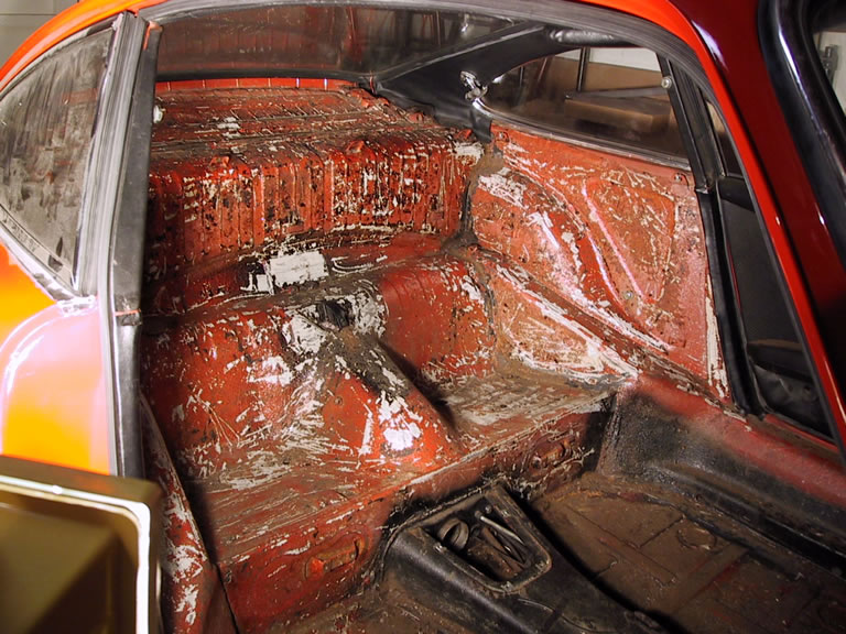

Well...have a couple of days scrapping away at the interior of my car, I have completely removed all the factory tar paper and sound deadening. Now I have to start stripping the paint out and grinding away the seam sealer.
I know that Brad thinks highly of this procedure to both 911 chassis and 914 chassis and after doing this I would have to agree. I thought I had a rust free tub, but I was mistaken...I found some areas of surface rust in the corners of rear deck and some on the floor boards. I also straightened out the floorboards from people jacking the car up incorrectly. Its getting there.

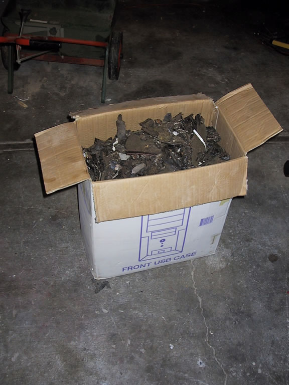

For the weight freaks here...all the tar paper and sound deadening stuff weighed 30 lbs!!
-Britain

Britain Smith
post Jan 29 2004, 04:57 PM
Nano Member
Posts: 2,354
Joined: 27-February 03
From: Hillsboro, OR
Member No.: 364
After...
Britain Smith
Nano Member
Posts: 2,354
From: Hillsboro, OR
Member No.: 364
30lbs!!

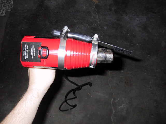

This is one of the tools that I used to strip it. I will be using a hand grinder and chemical stripper to remove the rest of the paint.
redshift
post Jan 29 2004, 06:17 PM
Bless the Hell out of you!
Posts: 10,926
Joined: 29-June 03
Member No.: 869
It looks prosthetic. Robo-Strip.
If you hit it with a little kerosene, and a wire brush, things will move along a lil faster, at that point.
Since you are stripping paint too, may want to nix the kero, and go right to the chemical strip, and a wire brush.
If you can get the room temp up around 75-80, should be a cakewalk.
M
