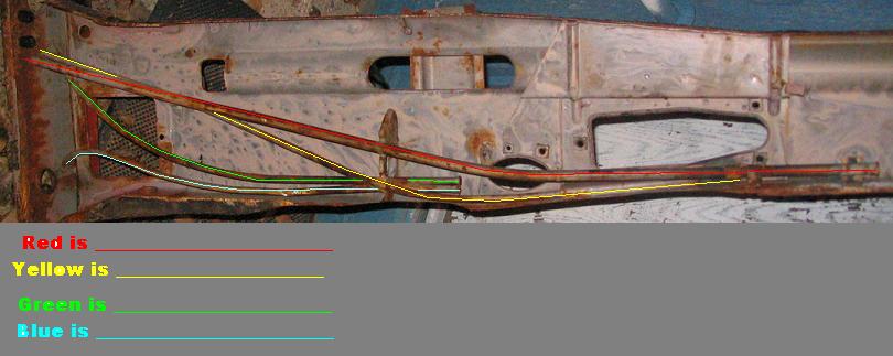

So I found this picture in the classics
what am I looking at??
Clutch tube is the yellow one??
And it is trying to straighten out??
That would make sense as to why the cable keeps getting longer. If it does straighten out, why does it need to be re attached, at that point it wont matter right??

I believe the red is clutch, yellow is accel, the others are for you heat.
