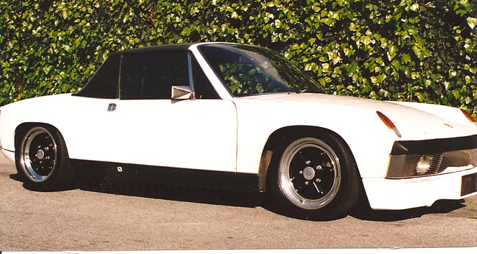

I ran 7" custom steelies on the Puttputt. IIRC the back spacing was either 5 or 5.5" and I ran a 1/2" spacer on the rear and 3/4" spacer on the front. Ran 205x50x15 Kumho V710s (very fat tire). My fenders lips were rolled and the fenders were massaged to accept the wheel/tire combination.
Yes 7s will fit if you do your homework and work on the fenders a bit.
I used to run 7x15 fuchs with 225s on the rear of my 914-6.
Here are a couple of pics.
white 914-6 is wearing 7x16s in this pic with 205s up front and 225s in the rear.
DanT

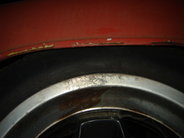

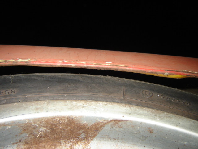

Way back when I Auto-x'd my 914 (it ran back then). I had a195/60 15's on 6" & 7" cookie cutters as street tires. The rears just barly cleared and the fender lips were rolled and I maxed the neg camber. I ran 205/50 15's on 5.5" gas burners for auto-x.
Not so good pics of a 195/60 on 7" cookie cutter on the rear.
From the side:
Looking up:
Jim

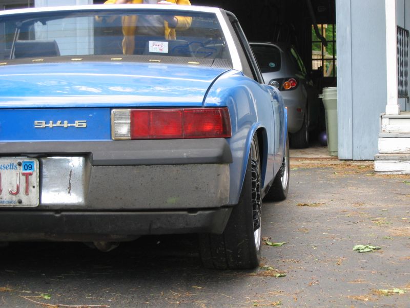

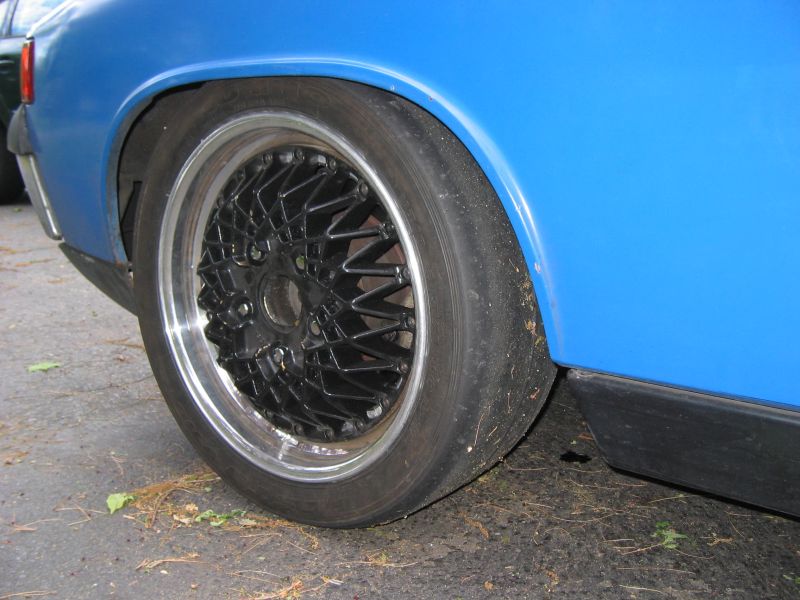

mskala
post Aug 11 2008, 09:26 PM
R
Posts: 1,967
Joined: 2-January 03
From: Massachusetts
Member No.: 79
If you have decent negative camber, you may be able to fit
215/40/16 Kumho V710, which are 8.6" wide, if you have offset
of 35mm on 7x16 wheel.
