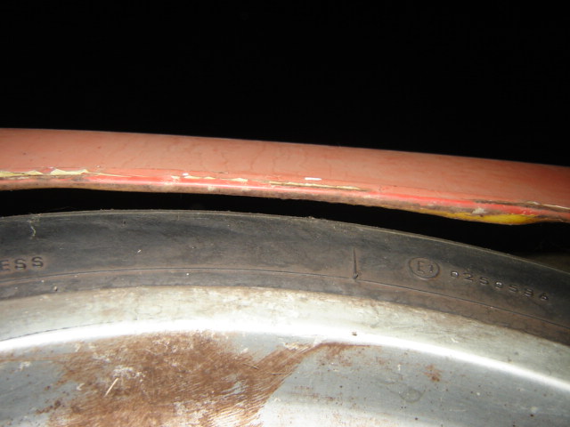

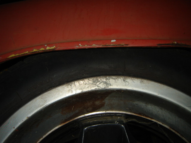

Way back when I Auto-x'd my 914 (it ran back then). I had a195/60 15's on 6" & 7" cookie cutters as street tires. The rears just barly cleared and the fender lips were rolled and I maxed the neg camber. I ran 205/50 15's on 5.5" gas burners for auto-x.
Not so good pics of a 195/60 on 7" cookie cutter on the rear.
From the side:
Click to view attachmentLooking up:
Click to view attachmentJim

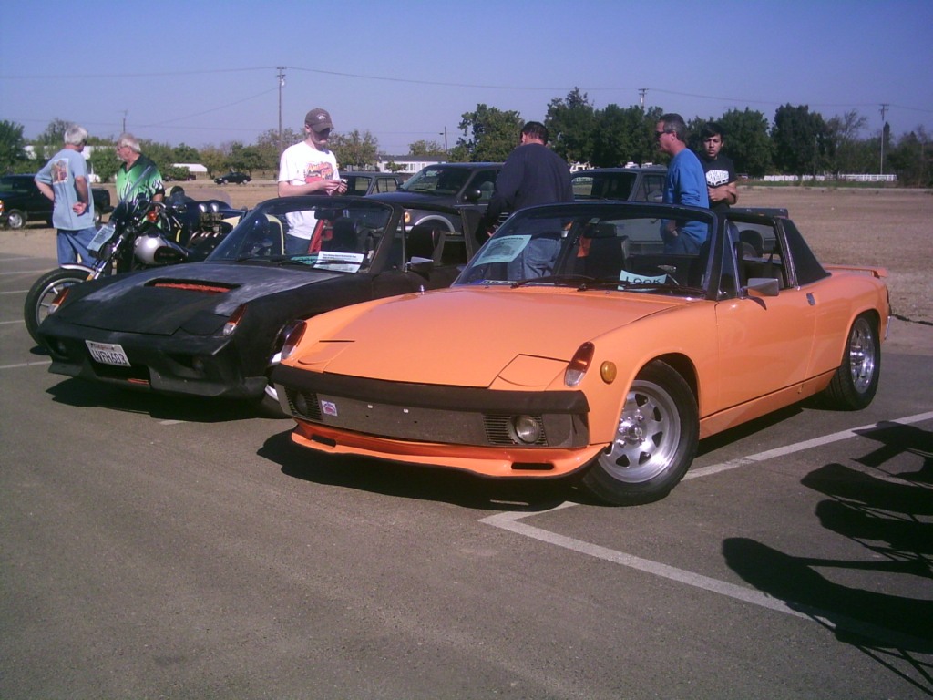

mskala
Aug 11 2008, 09:26 PM
pic #2
