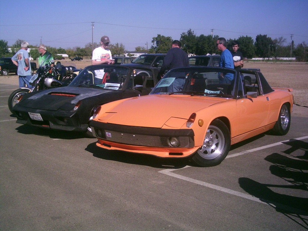

I ran 7" custom steelies on the Puttputt. IIRC the back spacing was either 5 or 5.5" and I ran a 1/2" spacer on the rear and 3/4" spacer on the front. Ran 205x50x15 Kumho V710s (very fat tire). My fenders lips were rolled and the fenders were massaged to accept the wheel/tire combination.
Yes 7s will fit if you do your homework and work on the fenders a bit.
I used to run 7x15 fuchs with 225s on the rear of my 914-6.
Here are a couple of pics.
white 914-6 is wearing 7x16s in this pic with 205s up front and 225s in the rear.
DanT
