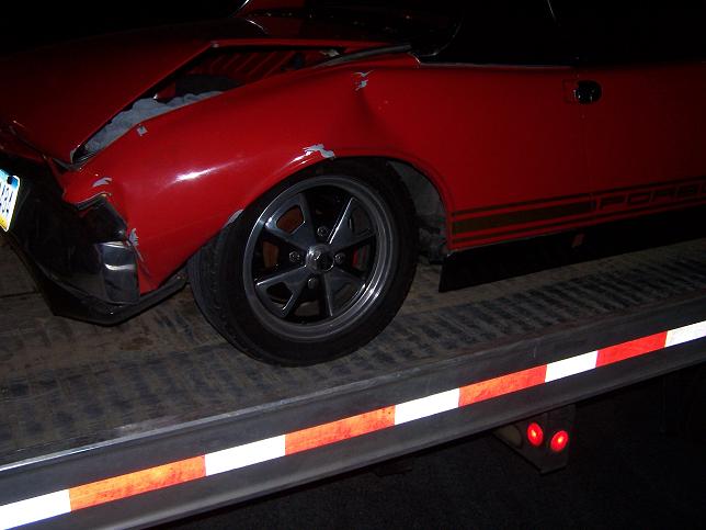

Spoke
post Aug 12 2008, 10:37 PM
Jerry
Posts: 7,185
Joined: 29-October 04
From: Allentown, PA
Member No.: 3,031
Bang.
Pound pound pound paint
