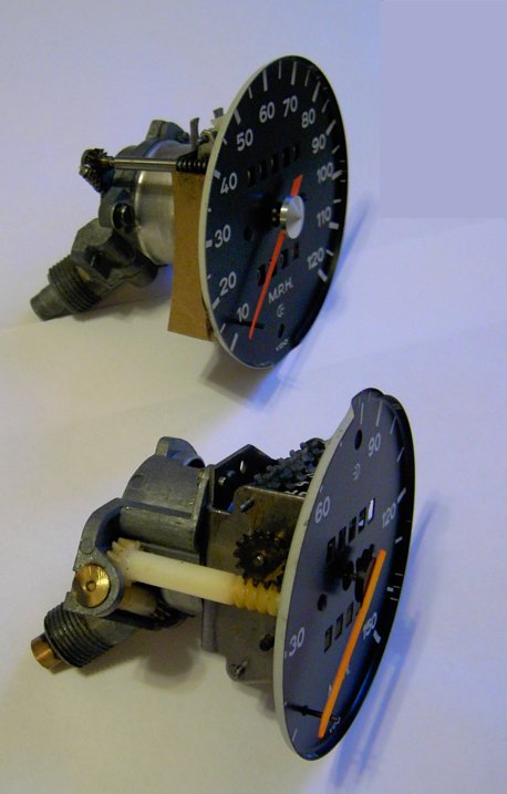

by the way my 150mph odometer doesn't work. from what i've experianced on other vehicles and what i've heard about the 914 the "plastic" gear strips. if so is the metal 120mph gears swapable to repair the 150mph gauge? the picture is obvious these 2 won't but are there some w/ steel gears that are interchangable?
mike
Mike,
Although plastic gear stripping may be your problem, it is likely that your 914 odometer failure is just a case of a specific gear coming loose. Pelican Parts has an excellent gauge repair article that may be of assistance. Check it out. Good luck!

I have done the PP fix for the ODO, it was easy and took about 1 hour on the dining room table. While i was in there i cleaned the guage gace and the glass on the inside, and now it looks better than new, AND works!
