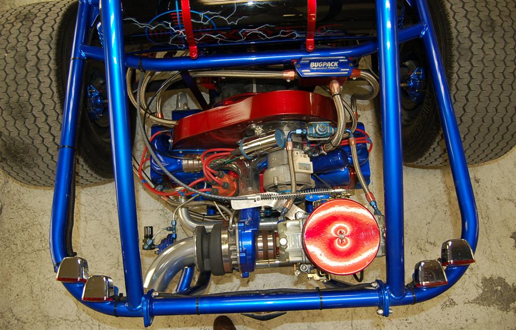

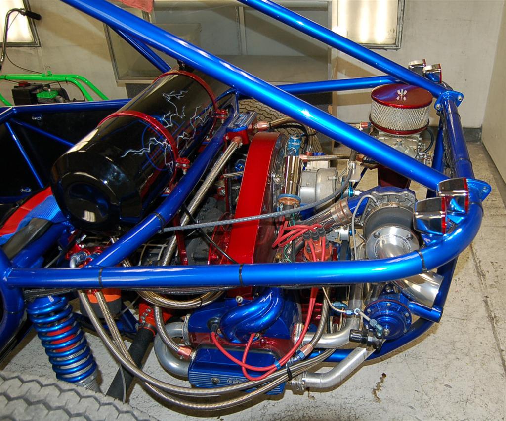

Hi All,
Had a surprise when I went to pickup some of my 914 powder coated parts at Exotic Coatings in Romulus, MI. Exotic Coatings is owned by Joe Williams who's dad is my long time childhood friend. My good friend Fred started the business & turned it over to the son, but Fred is still in charge. They give me good prices & quality work because of our long time friendship. It's great to have friends in high places. (IMG:style_emoticons/default/popcorn[1].gif)
Anyway, I didn't know they built this beautiful (4) passanger street buggy with a Turbo fired Type-1 motor. Because they own a powder coating shop you can see why it's a beauty. The motor was built by Pete, a local personal buddy of Fred (free) for some (free) powder coating on his street buggy. Joe told me they ran it at the Woodward Cruise at 10-lbs boast putting out about 350-hp. He said it will put out close to 400-hp with a boast of 13-14-lbs. My question, is this true hp or were they BSing me?? (IMG:style_emoticons/default/huh.gif)
I'll get a ride in it sometime soon. Here's some photo's to drool over. It's a Type-1 motor so I'll only post a few pics. unless you want more. Speak up please.

Turboing isn't uncommon with the T1 motors. CB Performance (www.cbperformance.com, formerly Claude's Buggies) has sold turbo kits for years. Nobody who has a turbo motor seems to be able to resist turning up the boost, easy power is too seductive, so they do tend to pop the motors after a while. But unless you go crazy they work fine. A big well built 2332 turbo could easily do that horsepower. How long it will last depends on what's inside the engine and how well it was put together. No secrets, though, it's a T1.

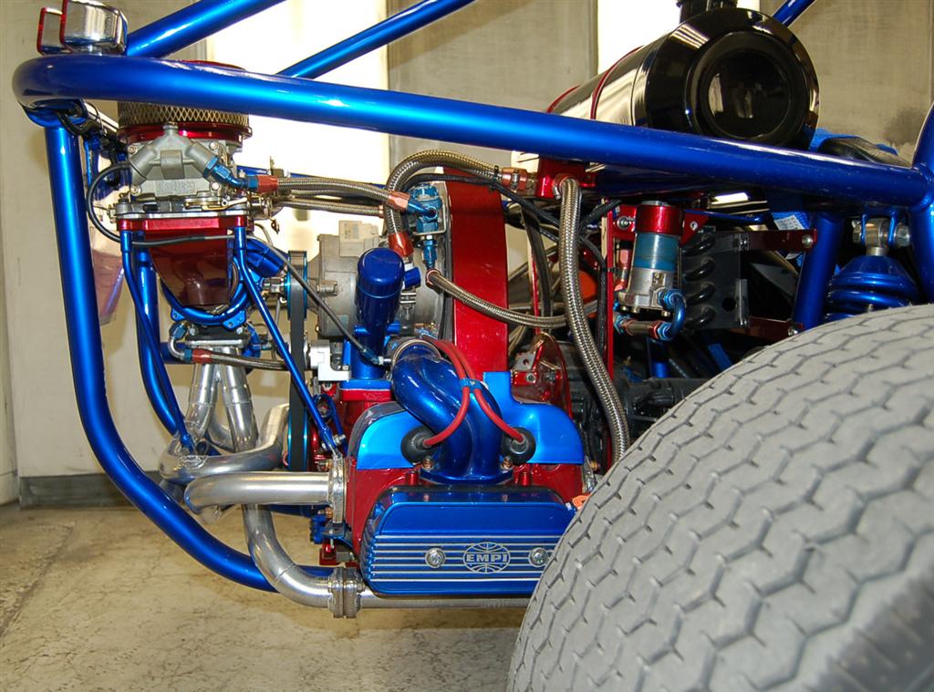

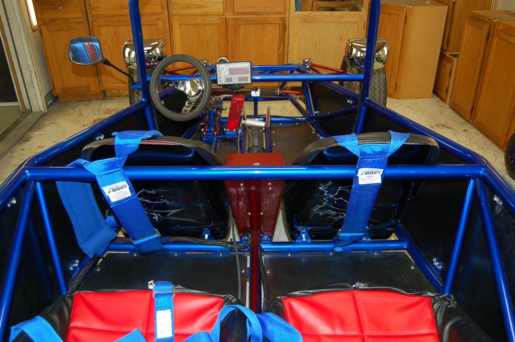

That's my understanding about boost. At 14 your living dangerous & the thrill of power is addictive.
Here's a few more pics.

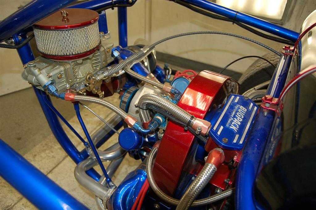

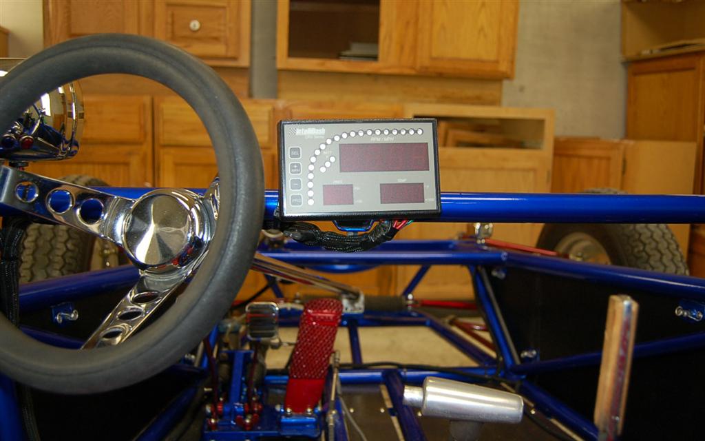

Last of the pics. (IMG:style_emoticons/default/bye1.gif)

If they would get some proper fuel management on there it would last a lot longer.

(IMG:style_emoticons/default/agree.gif) Thats quite a bit of boost to run draw-through with. Real PEFI and a nice intercooler would really help that engine out.

I was thinking the same thing- not that an engine that big with the right parts couldn't support that level of HP, but the draw thru carb system is 60's vintage stuff. Get some SDS on that thing ASAP! Still, highly cool ride, and I'd have it in my garage in a heartbeat.

I'm curious on draw-through... what's to stop the air and fuel from getting so hot that it starts to burn before passing the intake valves?

It looks to me he's got it somewhat detuned because of the fan belt and the 009 dizzy. He does have a big 4-bolt turbo and delta wastegate so maybe slap on a locked-out magneto and turn up the boost with VP c-16 and he'll see 400. A few years ago I saw a bolt on side draft throttle body using a stand alone system and thought that might be the way to go to modernize the draw through carb delivery. Less cost and less complexity if it could feed the fuel when off or on boost, just what a daily driven 914 needs. I think the Mallory box has a ignition retard......
