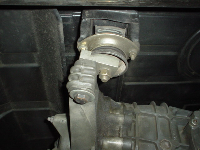

I found this from an old thread by John2kx, as they say "A picture is worth a thousand words" (IMG:style_emoticons/default/biggrin.gif)
Thanks
Paul

You'll need to mod your front mounts as well, but this will get you the firewall clearance you need.
