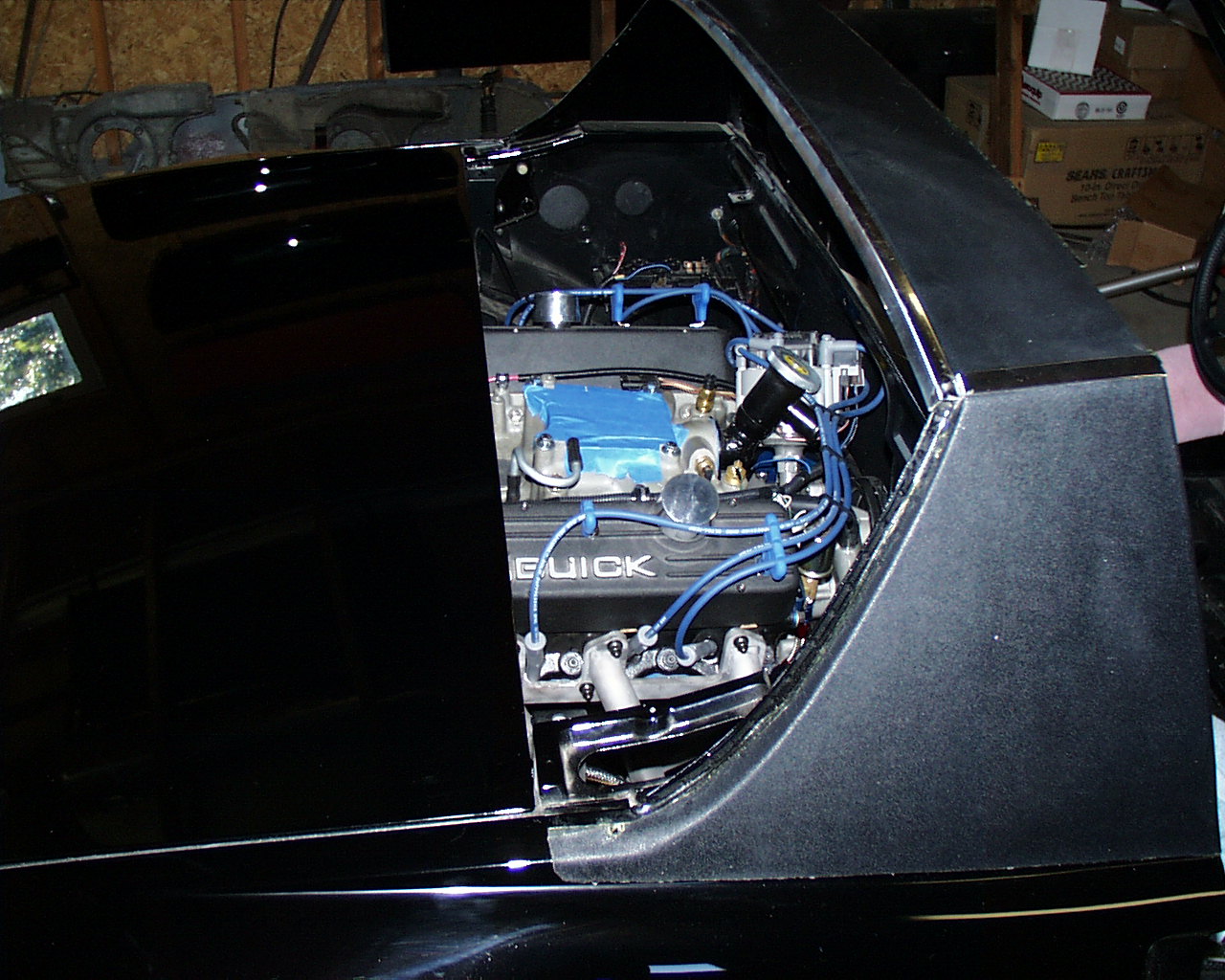

Got the engine/transmission installed in the car today piratenanner.gif and it seems to fit real nice except the distributor sits a little too close to the firwall for my liking.
So, for the Buick V6 guys out there how close is your distributor to the firewall and does it cause any problems?

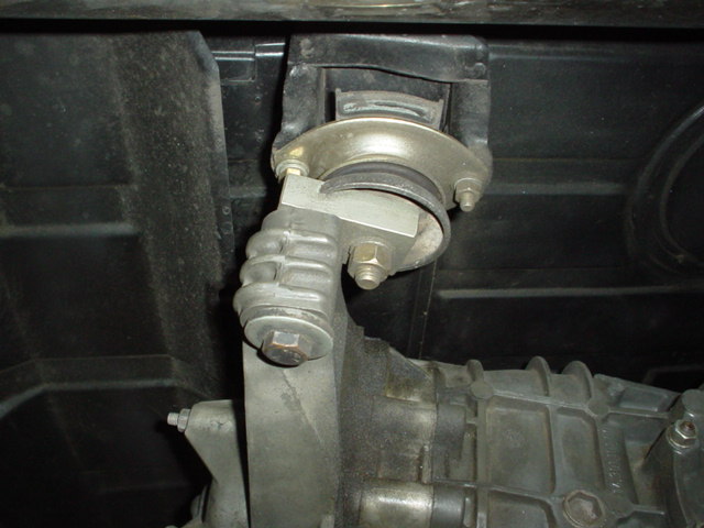

I found this from an old thread by John2kx, as they say "A picture is worth a thousand words" biggrin.gif
Thanks
Paul
rick 918-S
You'll need to mod your front mounts as well, but this will get you the firewall clearance you need.
