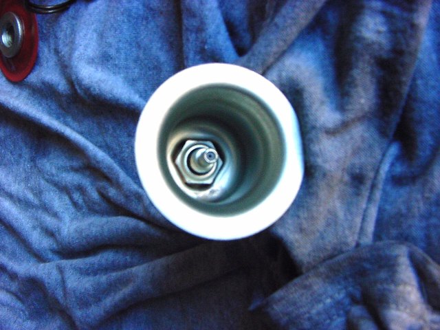

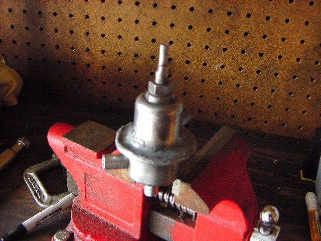

I got off from work early today and thought I would finish up my alluminum sunvisor mounts, I was wrong. I picked up an extra decel valve and decided to open it up. I plugged mine because It was all jacked up. I know most dont use their decel valve anymore, but thought if nobody had opened one up and posted it here before, this might help the ones that still have them.

In pieces:

Top portion with the adjustment tube

and back together again after a really good cleaning, some crimping and JB Weld.

See how far you can throw it.
Just kidding. Interesting that they used a diaphram almost identical to a carb accelerator pump diaphram.
