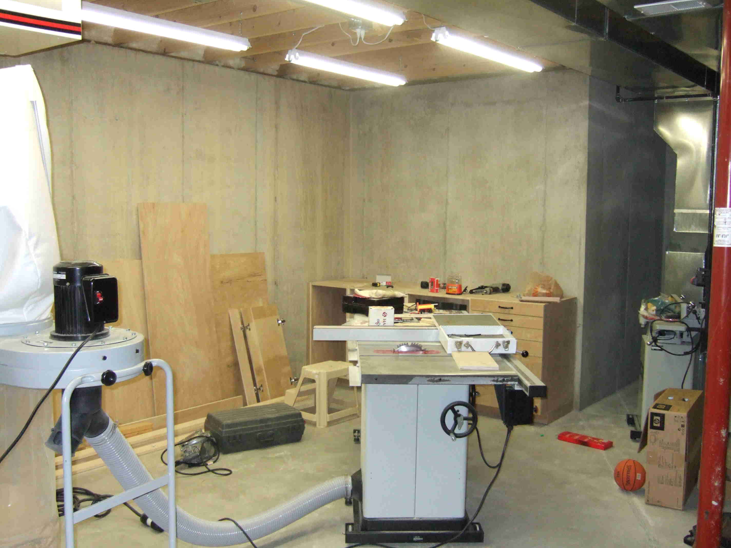

BTW nice wood shop. I was thinking of buying a router table for my saw too. How do you like it? I wasn't sure if I wanted to do it because you have to drop the router bit everytime you cut with the saw. I figured it would be a pain to adjust the router height again.

jmill - The router table is great on the table saw, but i really don't use it all that much because my grandfather has a seperate router already plus two other portable routers(this workshop is LOADED for woodworking, not so much metalworking), don't know why he bought the table saw that way, but he did. I love the workshop you have, tons of space, mines a little small but as long as i don't build large items like furniture down there im good. A lot of great tools are in the shop right now, but like i said its small so things get cramped and put in corners, then you gotta move stuff out of the way to use one tool, works for me and my little projects but for larger undertakings it may not be the best.
