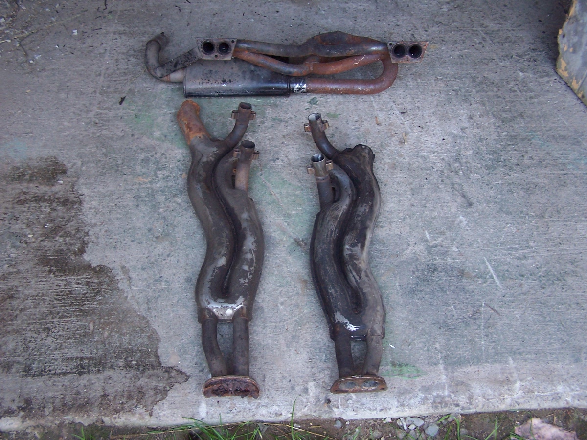

well not actually backwards, but on the wrong side. i reinsalled the h.e on the passenger side and in went in without a hitch, now the driver side wont line up with the studs. could i have put them on the wrong side/ does anyone have a good pic of a completey installed system for a 2.0? with all the tubes and hoses. i am trully lost (IMG:style_emoticons/default/sad.gif)

r_towle
post Oct 10 2008, 05:22 PM
Custom Member
Posts: 24,705
Joined: 9-January 03
From: Taxachusetts
Member No.: 124
here is a pic.
r_towle
post Oct 10 2008, 05:23 PM
Custom Member
Posts: 24,705
From: Taxachusetts
Member No.: 124
Forget looking at the muffler in this picture.
Look at the HE;s
From the back of the car these HE's in the pic above are on the correct side. See the bend in the front pipes>
Rich

thanks rich i'm just losing it. i got them on the right side just have to check if a stud is bent
