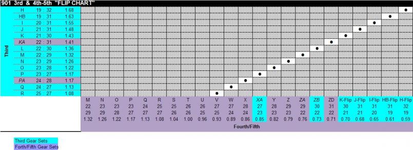

Here's the '901 gear flip chart'
This chart, along with the gear ratio worksheet is available here:
http://www.914world.com/bbs2/index.php?showtopic=79893
Coincidentally, the Re-gearing tech article includes an example auto-cross setup that shows flipping 3rd & 5th making a A-F-Ka-V-Z (IMG:style_emoticons/default/smile.gif)
