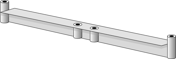

I wonder is a T bar would make it lighter. Four tubes for bolt passthrough, flat plate on top parallel to the ground, flat plate vertical.
I bet that would do it, and weight a lot less. (IMG:style_emoticons/default/idea.gif)
I have a mount bar laying around here. I could whip up a prototype... (IMG:style_emoticons/default/welder.gif)

McMark
post Jan 23 2009, 01:22 PM
914 Freak!
Posts: 20,180
Joined: 13-March 03
From: Grand Rapids, MI
Member No.: 419
Here's a mockup design.
ericread
post Jan 23 2009, 01:29 PM
The Viper Blue 914
Posts: 2,177
Joined: 7-December 07
From: Irvine, CA (The OC)
Member No.: 8,432
How does your design ensure there is no rotational flex, or do you feel this is not an issue? Do you believe this design can meet the stock design of keeping the engine in a very static position?
McMark
post Jan 23 2009, 01:45 PM
914 Freak!
Posts: 20,180
Joined: 13-March 03
Member No.: 419
Eric, rotational stress along the length should occur between the center and the ends. There will never been end to end torsion, because the body is relatively solid (for the purposes of this design study). So you have a 1.75' section that's twisting, which is pretty short. I think the T-structure will provide sufficient strength.
Torsion comparisons between this design and the stock bar would be fairly easy to conduct. Drilling holes would also be an option that could be tested....
ericread
post Jan 23 2009, 01:47 PM
The Viper Blue 914
Posts: 2,177
Member No.: 8,432
QUOTE(McMark @ Jan 23 2009, 11:45 AM) *
Cool (IMG:style_emoticons/default/aktion035.gif)
So how much weight do you anticipate saving?
Mark Henry
post Jan 23 2009, 02:17 PM
that's what I do!
Posts: 20,065
Joined: 27-December 02
From: Port Hope, Ontario
Member No.: 26
You will need a hole for the shift rod.

QUOTE(McMark @ Jan 23 2009, 11:22 AM) *
I like that design, but the car still has a sideshifter and typical linkage. I'll have to take some measurements of the hole in the stock motor mount.
McMark
post Jan 25 2009, 09:01 PM
914 Freak!
Posts: 20,180
Joined: 13-March 03
Member No.: 419
Clearance for the shifter wouldn't be too big of a deal. I'm searching for appropriate 'tubes' for the bolts to pass through.
