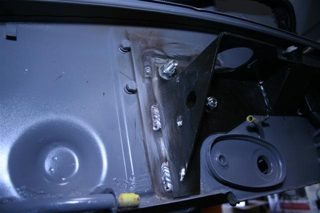

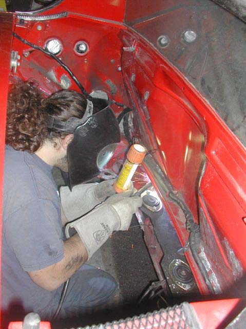

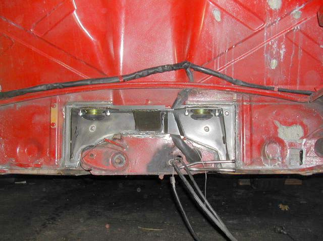

post Mar 7 2009, 11:29 AM
Resident German
Posts: 42,257
Joined: 21-January 03
From: Oakland, Kalifornia
Member No.: 179
McMark doing his Magick:
Seam-welded all around, even filled in the "bolt" holes:
And some touch-up paint:
