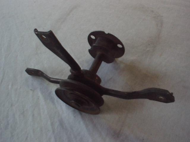

Does the belt attach to the fan to pump or the alternator to pump?
If on the fan are there two grooves on the cooling fan, one for the alternator belt and one for the smog pump?
Or is there supposed to be a secondary pulley coming off the alternator shaft... if so I seem to be missing that.
Thanks for ANY help!!!!!!

There's a secondary pulley assembly that comes off the crankshaft. It consists of a 3 point bracket and a pulley with a shaft that bolts to the fan hub through a rubber damper. NLA, but I have a couple of good used ones. The Cap'n

could I get a pic of this assembly emailed to arvcube@aol.com or posted on this thread? do you still have any more of these?

I have a couple of these also.....

thanks for the pic ejm. How much do you want for one shipped to 92064?
