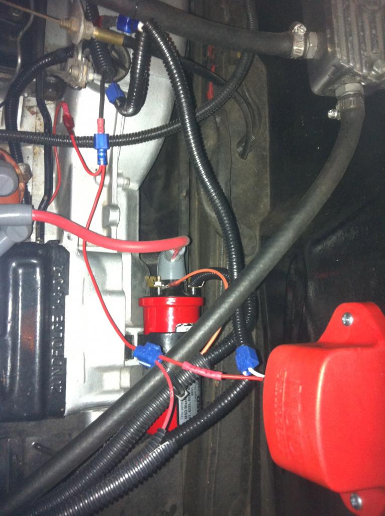

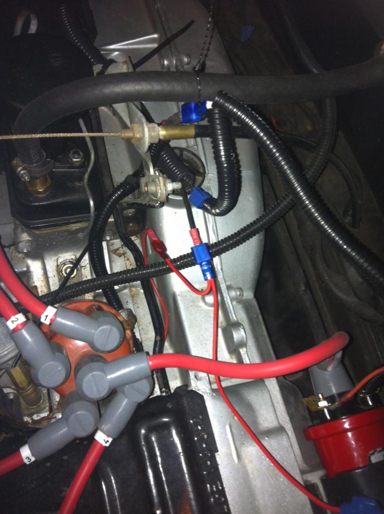

Hello,
I just installed my MSD 6A and I cannot get the engine to run. It will only crank. I used the diagram above for the 8920 tach adapter. I unplugged everything and connected the original set up and it runs, so everything works. Any suggestions as to what I am doing wrong?
reese5997
post Jan 20 2013, 08:28 AM
Posts: 20
Joined: 2-January 13
From: washington dc
Member No.: 15,334
Correction 8910*

QUOTE(Kirmizi @ Jan 20 2013, 02:04 PM) *
I suppose my first question would be, are you sure the MSD box is good?
Have you double-checked all of your wiring and connections?
Mike
For some reason the stock diode with the male and female endings already crimped in place was backward. I removed the diode and the engine fired up in 30 degree weather instantly. I did not have engine run-on when I turned it off so I left it off. So I am good to go.
