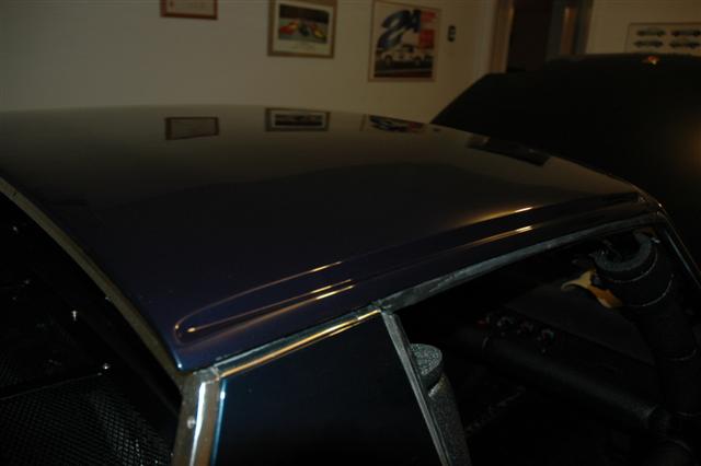

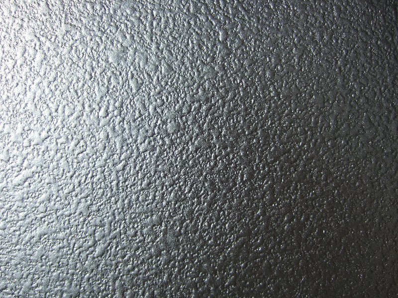

I just spruced up this faded targa top. The results were amazing so I had to post it. I first scrubbed the top with Simple Green. Next I sprayed it down with an aeresol solvent and wiped it down. Now the top seemed to be free of dirt, wax, etc. I then sprayed it with Bulldog Adhesion Promoter. After 5min I then began spraying it with SEM Color Coat Landau Black aeresol. I applied each coat 5 min apart, until the can was gone. I had enough for about 5 coats. These were really thin coats and it didn't even start to fully cover until the 3rd coat. This stuff is awesome when applied in very thin coats as none of the texture detail is lost. The color turned out absolutely great! It's a perfect match, not being too dull or shiny. Only time will tell if it holds up, but if it doesn't I'll just hit it up with another can every couple years. Being the car is only out on nice days, I'm sure it'll be fine.
Here's the before and after...
(IMG:http://i10.photobucket.com/albums/a125/philtheskipper/1973%20Porsche%20914/new%20parts/topsem002_800x600.jpg)
(IMG:http://i10.photobucket.com/albums/a125/philtheskipper/1973%20Porsche%20914/new%20parts/topsem003_800x600.jpg)
(IMG:http://i10.photobucket.com/albums/a125/philtheskipper/1973%20Porsche%20914/new%20parts/topsem_800x600.jpg)
(IMG:http://i10.photobucket.com/albums/a125/philtheskipper/1973%20Porsche%20914/new%20parts/topsem006_800x600.jpg)

That is why I posted. I think the SEM is the closest match to the original color that I have seen. The top really looks better in person than the photo. For some reason the after photo of the whole top looks grainy or something.
