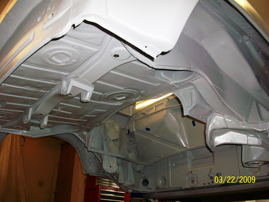

dakotaewing
post Mar 28 2009, 12:04 AM
Posts: 1,163
Joined: 8-July 03
From: DeSoto, Tx
Member No.: 897
Here is mine without!
