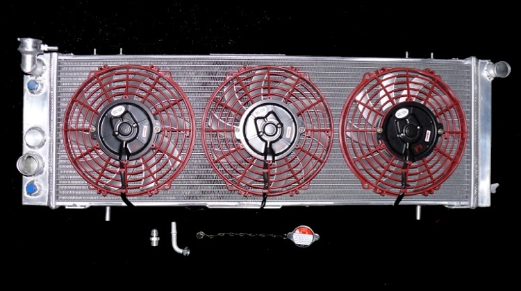

no flames please , but I still keep looking at the "extra room infront from the short ej20 layout and have the radiator in the engine compartment.. I found an AL three fan cherokee radiator.. 36 in across and and 13in high...Sit it low and use the natural air flow from bottom to top...
and I know a friend of mine keeps saying "radiators belong in front of the car"
