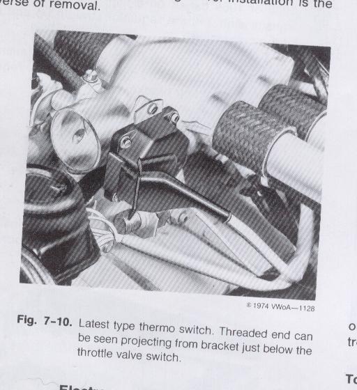

Cap'n Krusty
post Apr 20 2009, 10:56 PM
Cap'n Krusty
Posts: 10,794
Joined: 24-June 04
From: Santa Maria, CA
Member No.: 2,246
You've just thanked someone for the WRONG INFORMATION! That's the thermotime switch, part of the cold start circuit. Temp sensor 1 screws into the side of the plenum, and has a 2 wire plug in connection. The TTS attaches to a case through bolt, along with the forward leg of the plenum, on the right side of the case centerline close to the distributor.
The Cap'n

kpfoten
post Apr 21 2009, 08:59 AM
Posts: 220
Joined: 15-April 08
From: Escanaba, MI
Member No.: 8,927
Here's a photo that will give an idea (although probably not completely accurate):
