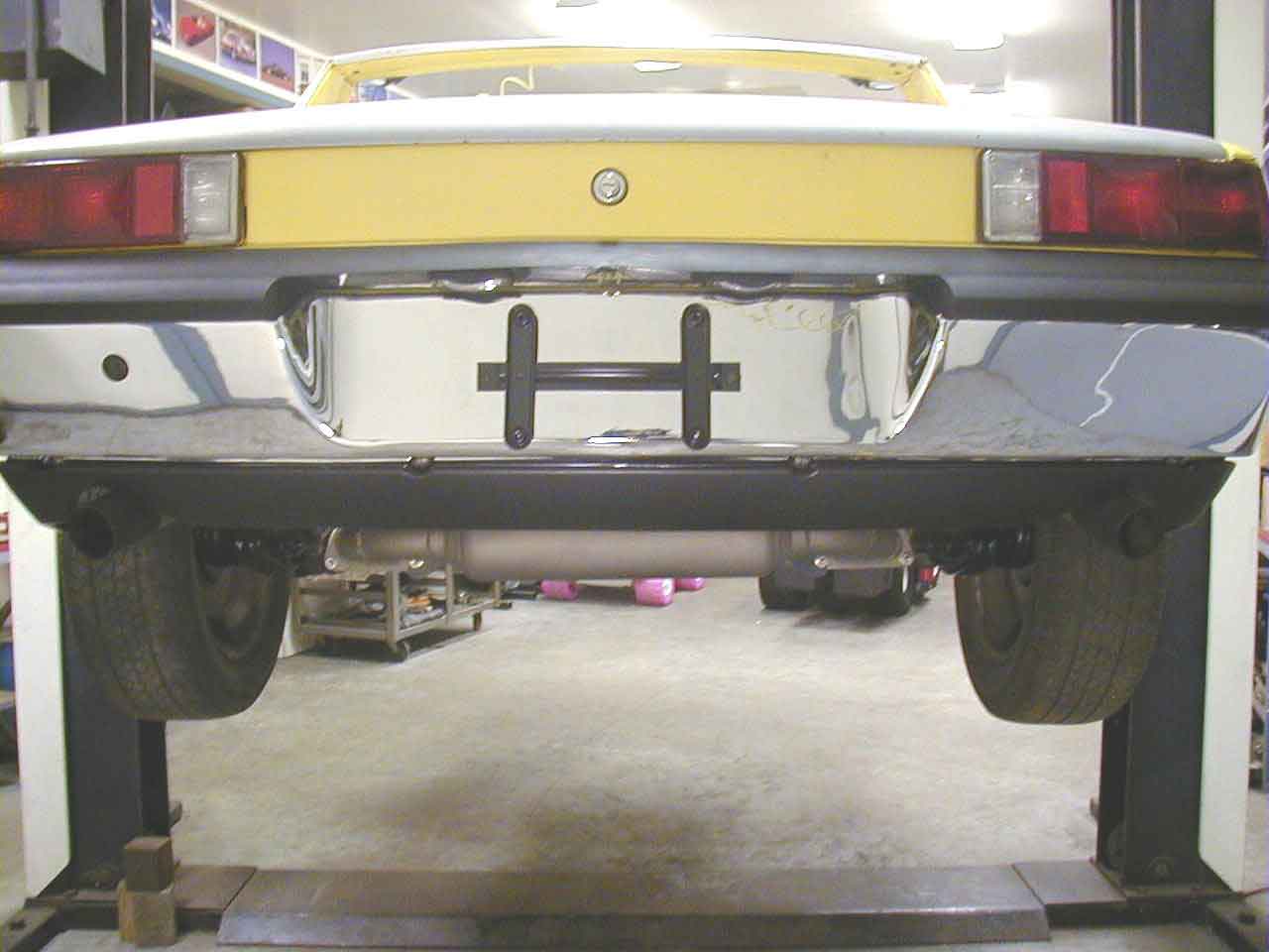

Oops! It was way late, and I was half asleep when I replied originally, so I completely missed the part where you mentioned 916 bumper! Totally different beast than the short valance, I know...though probably much easier to work with. Plus, given it's shape and coverage area, you can probably get away with quite a bit in terms of the pipes being slightly offset, on both X and Y axes.
All the Triads I've seen have exited at the proper valance notch/location (the valances on 4-cyl cars, at least), so if your 916 cutout is in the stock /4 location, I think you should be OK. The pipes are stouter (2.5" OD, IIRC), so you may need to open up your porthole a bit.
Below are a few photos I have that may give you a better idea, even though they aren't of 916 bumpers. Cars are not mine, so I don't have any add'l info. The green one has the stealth/down-turned 2nd pipe, as someone mentioned above.
-duc
