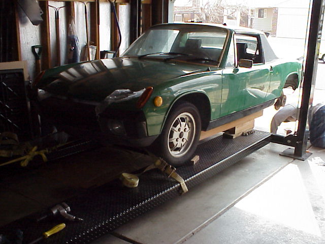

Secured the front end... just in case.

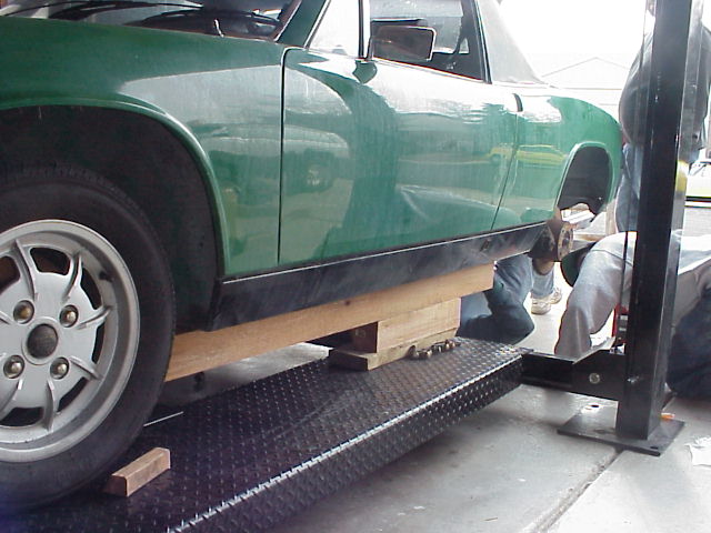

The lift ramps are too narrow for a 914 engine with tin installed. But using the lift in this manner allowed us to keep the car level AND raise and lower the car at will instead of tettering a motor/tranny 3 feet of the ground on a jack. Bob sugeested running a 4x4 from the front donuts to the rear donuts so that we would no incur any floor pan damage. And using 4x4 and 2x6 inder that made for a very secure platform.
