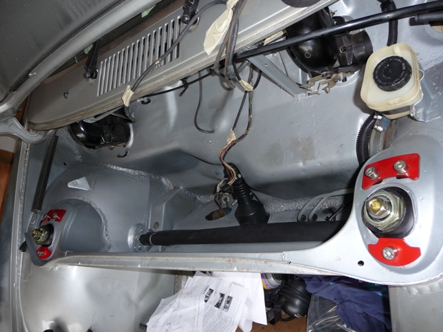

Cleaned up the steering rack area
Cleaned up the wheelwells and installed the Tarett bar!

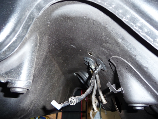

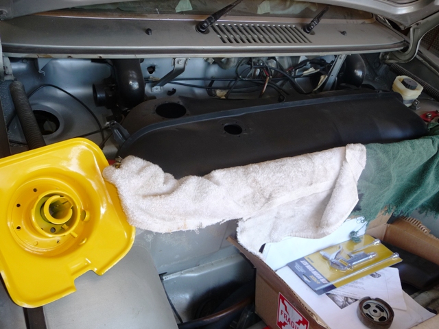

Cleaned up under the fuel tank
Sent the tank to be boiled out and sealed up

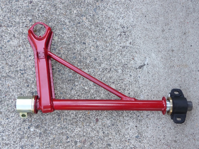

Cleaned up a pair of A-arms I bought from Rhodyguy (Kevin) and installed the Elephant hardware

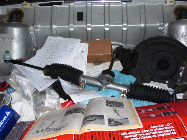

Cleaned up the steering rack and attatched the turbo tie rods

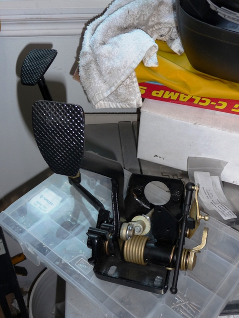

Bdstone refurbished pedal cluster... Tasty! (IMG:style_emoticons/default/beerchug.gif)

Is the cover on the torsion bar to prevent it from rubbing on the tank?
Have you considered running the cooling lines down the bottom of the centertunnel? Now is a good time to figgure the lines out.

Charlie - I used a thin piece of pipe foam insulation to cover the swaybar to keep it from banging on the bottom of the gas tank. rTowle (Rich) has posted using a piece of garden hose but, I am going to try this and see how it goes. As for running the coolant lines, I am debating making a semi-removable panel for the center tunnel like Carreraguy had made for his Suby conversion. I probably would cut out the heater cable tubes and eventually make an access panel in the engine bay like Amenson did: (IMG:http://www.914world.com/bbs2/uploads/post-4154-1215898433.jpg)

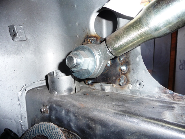

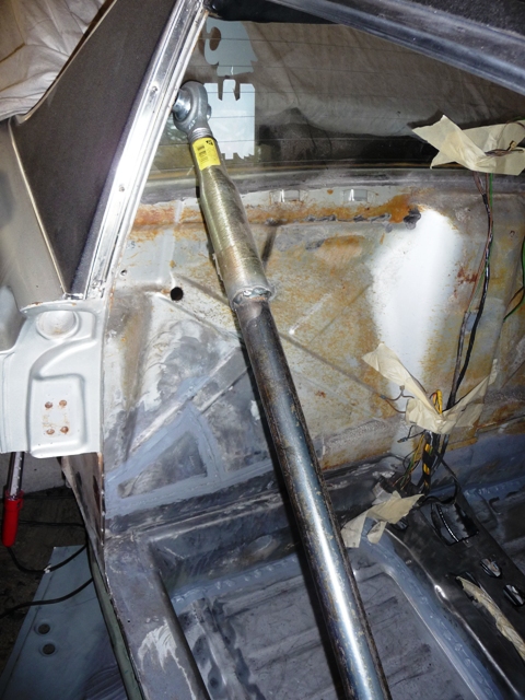

I made a door brace for the passenger side after Strawman's (Geoff) example. Using a turnbuckle cut in two and welded onto a piece of 1 inch schedule 40 pipe. Then, connected to the upper seat buckle mount and welded to a plate in the foot well.
Upper attachment
Lower attachment

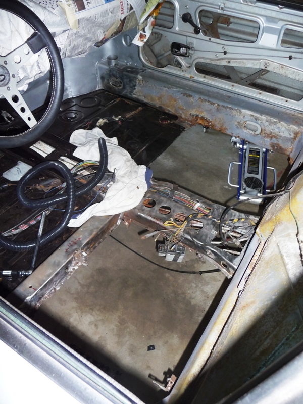

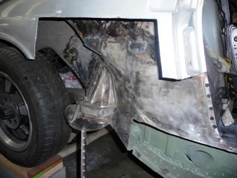

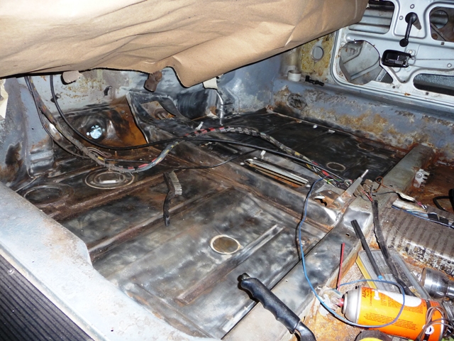

Then came the moment of truth and I broke out the heavy artillery. Many spot welds were drilled out and the pneumatic saws were humming to cut out the rotten areas: rear floor pan, right inner long, jack points, passenger sill, right lower wheel house, and the hell hole. (IMG:style_emoticons/default/sawzall-smiley.gif)
I researched the "Digging into Hell" thread and others to make sure that I did not open up too much at one time. Especially, since I am not using a rotisserie. (wish I was)
Here are some pics:
Cut out rear floor pan

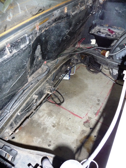

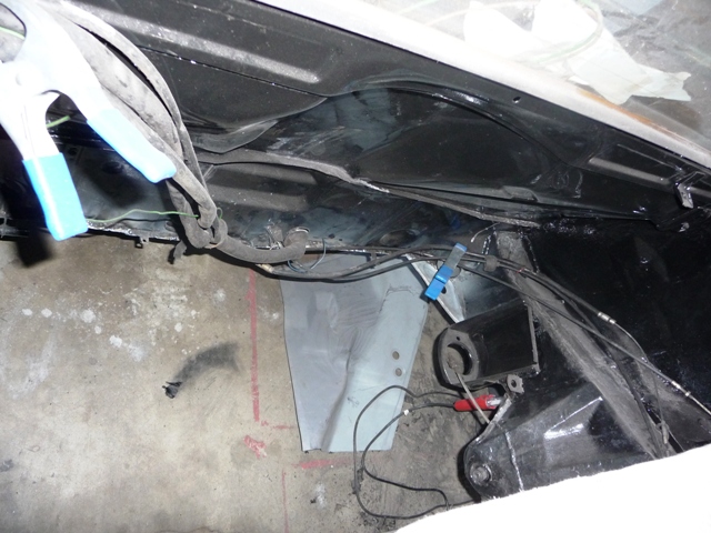

Cut the fender to get at the wheel house and took off the sill and inner rocker.
Had to repair part of the interior long, repaired then double wall reinforcement, cut out the heater tubes & supports.
Wire wheeled it out, prepped and painted.

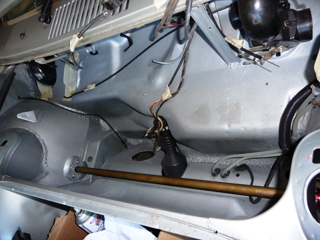

In the engine bay I cut out all of the aircooled tin and extra metal. Wire wheeled it down, cleaned and prepped for POR-15. I have to re-open the hell hole repair I did awhile ago but, it will be a lot cleaner with new metal!! (IMG:style_emoticons/default/welder.gif)
Cut out my slop!

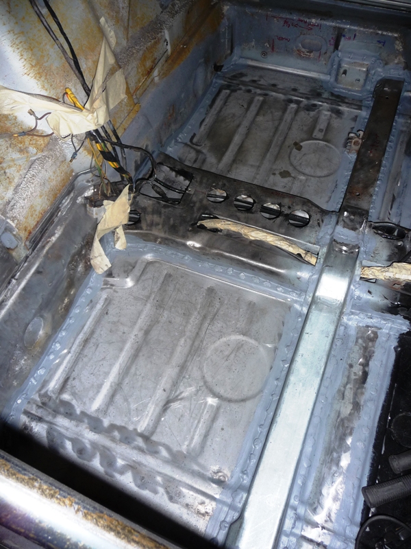

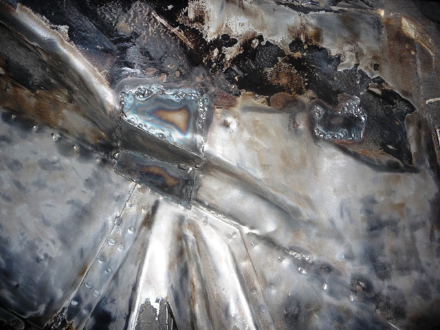

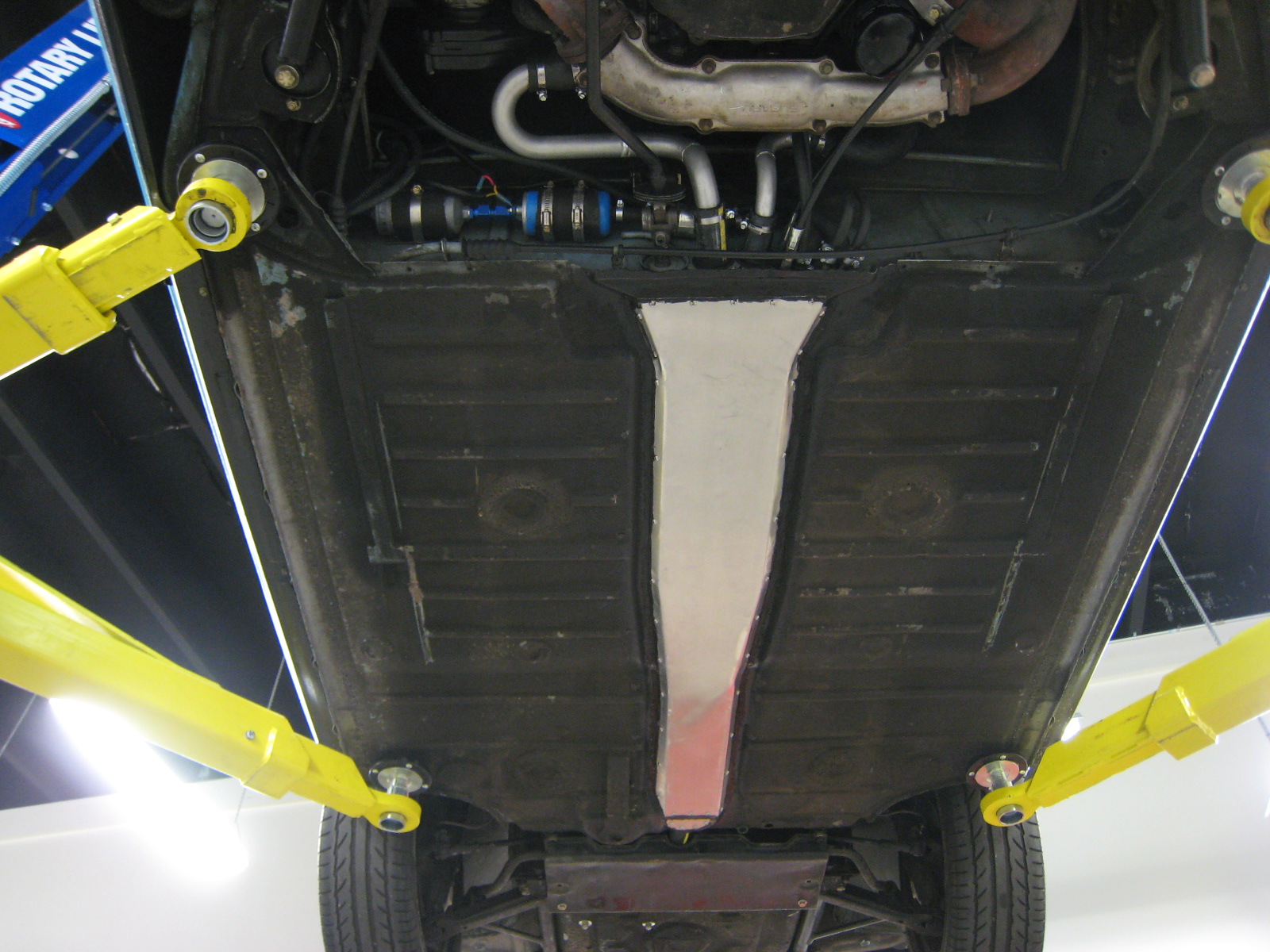

After the passenger long was repaired on the interior side I got the rear floor pan ready. I used Jeff Hail's sketch about over lapping the front and the rear pieces so the rear is on top of the front section. Rosette welded on top and seam welded under neath. I also replaced the passenger side cross member support since it was rotted out too. I ground down the welds enough but not all the way (yet), prepped them and applied seam seal on them for now.
I will get more particular when I install the Engman interior stiffening kit later.

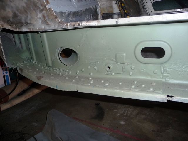

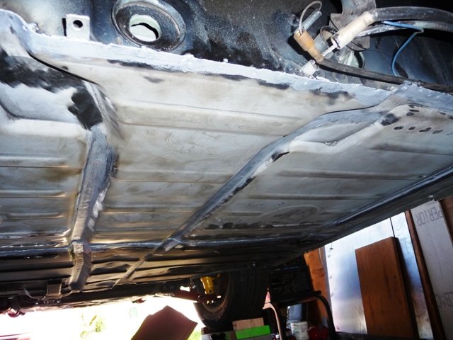

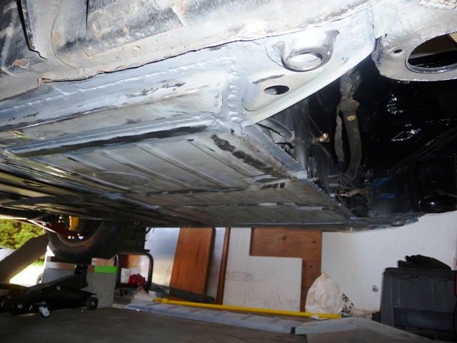

Underneath, the seat rail reinforcements were replaced as well as new Restoration Design rear jack points.
Again, the welds were not ground down all the way yet and seam sealed for now.
Hard to get into all the tight spots to grind everything. Maybe I will use a die grinder with stones.
Fine details will happen after all the repair welding is completed.

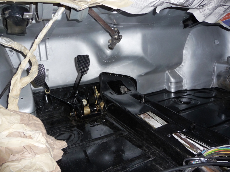

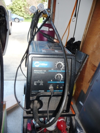

Earlier, I jumped the gun a bit with the interior paint and POR-15 on the front floor pan. But WOW! I like the color contrast!
Touch ups after I am done...
My neighbor said, "Take it over and use it! It is only sitting around over here."
Thanks Tony!

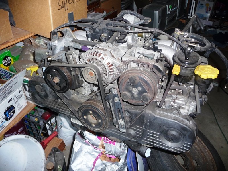

Here is my new engine sitting patiently.
