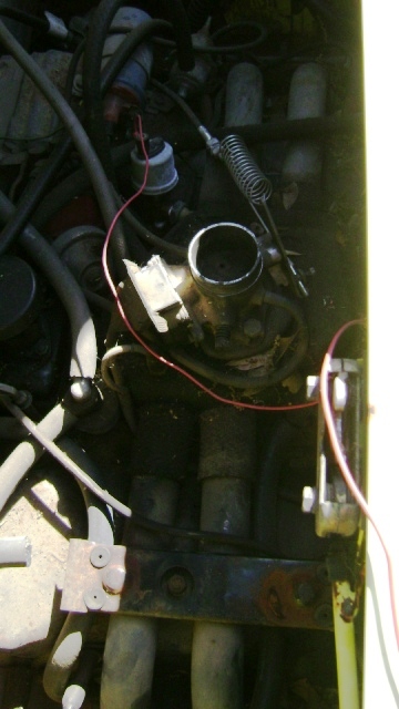

It got really rich and started bogging down. Check very very thoroughly for open connections. Make sure your timing is set correctly. Make sure you have a throttle return spring installed.
Take off the air cleaner and take 4-5 pictures of the engine bay and post them so we can help you look for open/wrong hose connections.

I don't know if the timing is correct cuz I don't have a timing light. Going to be getting one on thursday when I get paid. I do know I have a throttle return spring and that the butterfly valve in the throttle body isn't sticking or getting stuck.
Well here is a pic of the engine bay. Its the one I got in my computer right now. Probably not the greatest. I will take some more tomorrow if its nice enough.

Refer here for hose diagrams: http://www.pelicanparts.com/914/technical_...4_20FI_diag.htm

Yeah. I have double checked that my hoses were all correct a few times and they are all correct.
