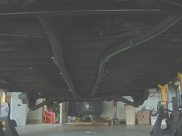

Mine...typical Renegade setup

What's that Renegade setup? what type of tubing is that? What's the Inner Diameter on it?

QUOTE(computers4kids @ Apr 26 2009, 08:48 AM)
Can you show the area where the coolant pipes exit the trunk under the car?
Thanks

QUOTE(RJMII @ Apr 26 2009, 08:55 AM) *
1" and 1 1/4" gates hoses that Renegade out of Nevada likes to use. You can buy it at your local truck stop with the rubberized clamps.
QUOTE(my928s4 @ Apr 26 2009, 09:42 AM) *
Thanks
(IMG:http://www.914world.com/bbs2/uploads/post-4253-1212389199.gif)
(IMG:http://www.914world.com/bbs2/uploads/post-4253-1217899832.jpg)
