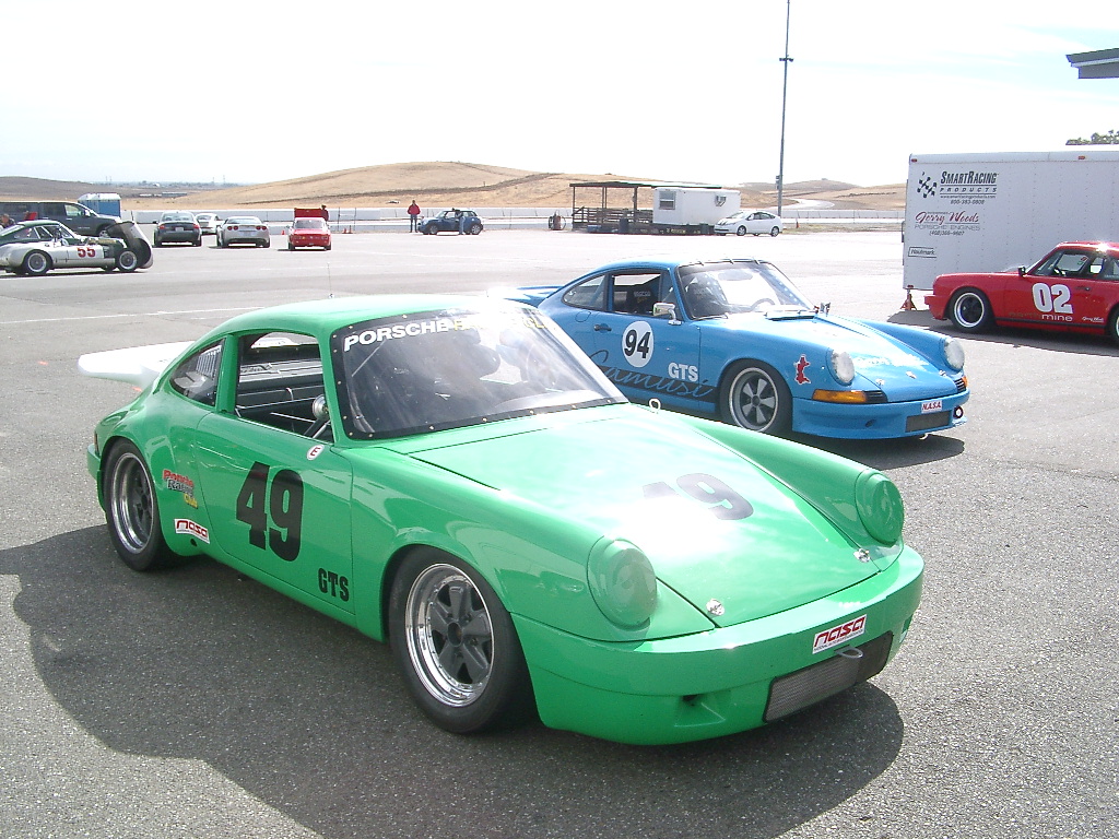

Toyo Spec 911 race car, GTS class with PRC, SP911 class with PCA.
No Street, no AX, just *big* track ... 3.0L with aftermarket FI. About ~270 HP at the rear wheels. 245 x 16 Toyo RA1 tires in the rear.
(IMG:style_emoticons/default/shades.gif) Andy
PS: I have no idea what lube or how much of it they used when they mounted the tires. I didn't stick around to watch them put them on, just picked 'em up later ...

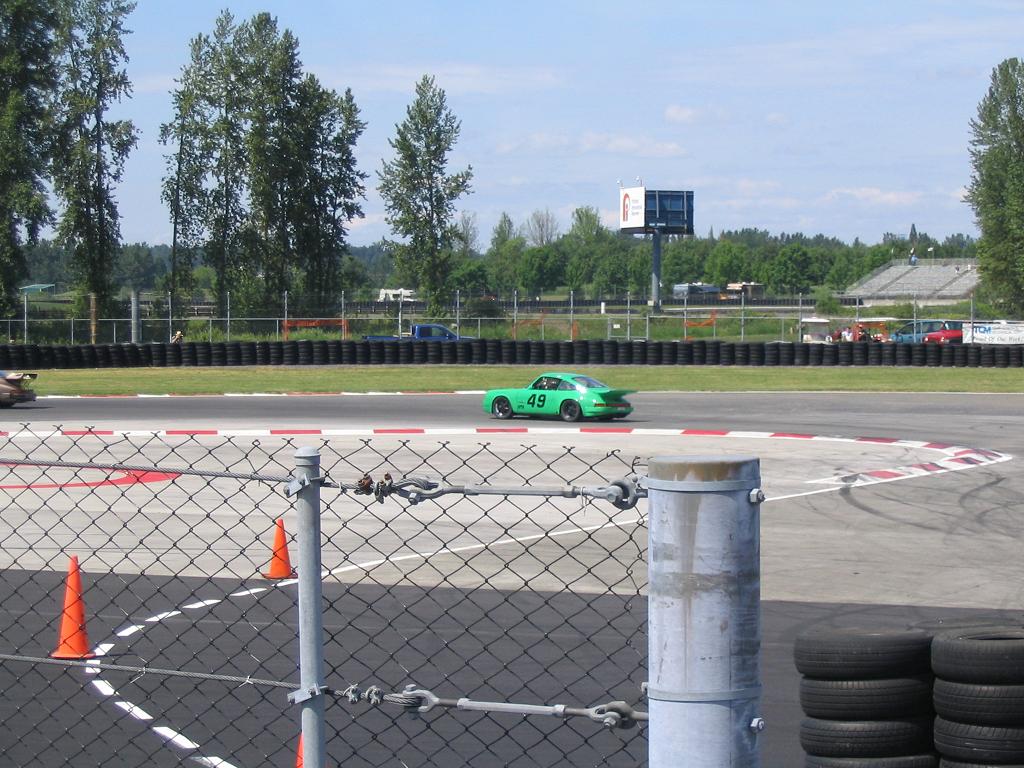

Portland is one of my favorite tracks . (IMG:style_emoticons/default/driving.gif) ....I love that track

I like the color.
