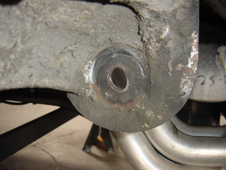

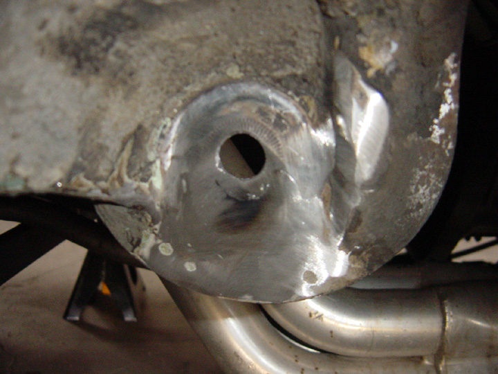

If you have the tools and the parts you can do the swap in a few hours! But I agree with others that you should fix it later and do the "while I am in here" stuff at the same time! I had to do the same thing, bent trailing arm, and when I got the arm off the suspension ear was ovaled and needed to be welded up and re drilled!
Not my photos but you get the idea!
