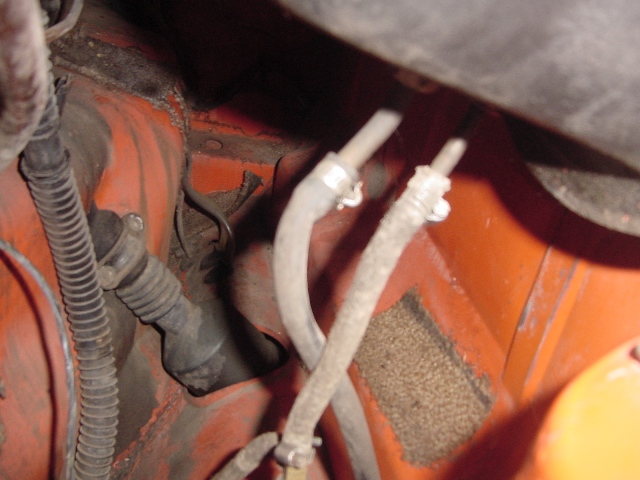

I have been having fuel delivery problems recently, so I am working at the front and going backwards.

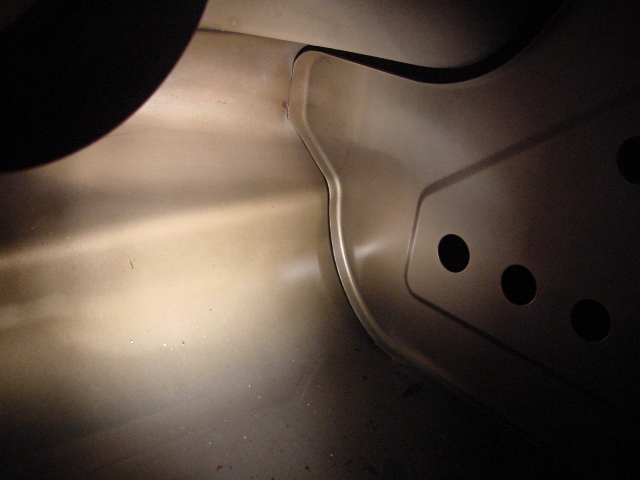

I tried searching the site for pictures of the strainer sock filter thing but didn't know where it was or how it was used. Check out the pictures if you have wondered the same thing. I also got some pictures of inside my tank. Thankfully it is in excellent condition.

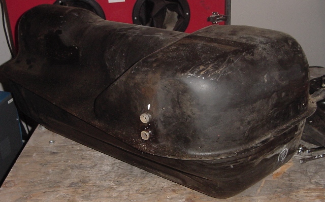

3/4 or 19mm for the securing nuts at the bottom of the tank.

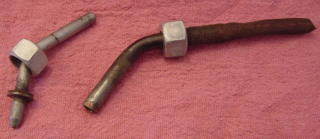

Pulled both fittings with their short lines off and cleaned with gasoline. You can see them on the red shop rag in next post.
Dirty gunk!

Here they are laying on a shop towel!

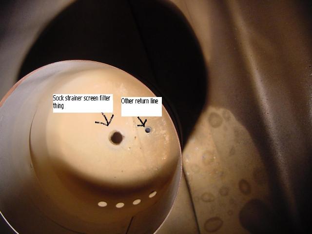

They poke up through these holes.
Outside once removed

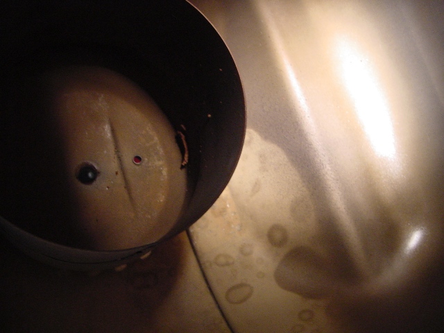

More inside the tank.

I need to replace mine b/c I think it is causing a leak or the connection is just leaking at the bottom of the tank. How does it attach to the fuel output line?
Got a pic of that?

Just with a hose clamp, if I understood your question correctly. You have your plastic or SS if your cool (I'm not yet) than a intermediate rubber fuel hose that attaches from that (plastic lines in tunnel) to the tank outlet lines with the hose clamps.

The base of the sock is a crush washer. When you insert the fuel outlet in the bottom of the tank and tighten that nut you crush it into place. There is another paper like washer as well...

I recently replaced the sock in my tank, after I had it boiled and sealed. My tank was full of rust. You couldn't even see the return line opening inside the tank. When I put it back in I made the new lines the same length as the old ones. One line kinked and I couldn't feel it. I had to take the tank back out and shorten the lines up. It's not too bad of a job.

By the way... That is the cleanest tank I have ever seen!
I thought mine looked like it was in good shape. I was going to clean and reinstall. Will it leak without new washers. I noticed the PO used some sealer on the return line. Does the kit come with the washer for the return line also???
Look at the top 2nd pic as you can see right through it. I am guessing the PO replaced it.
(IMG:style_emoticons/default/agree.gif) You lucked out there. Looks almost spotless!
You should definitely replace the washers with new ones. I don't see a hole in the netal return line (I think that's what you meant), but if there is one, you should replace it too. I don't know if these are still available new, but if not someone here probably has one to offer up.
