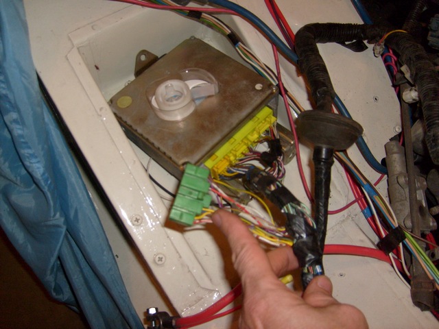

This is an important subject as our injection stuff gets old and parts go NLA.
So, I've been thinking about using something off if a Jap 4 cylinder. I think with a little reverse engineering a setup off like a Geo Tracker or one of the Kia engines could work.

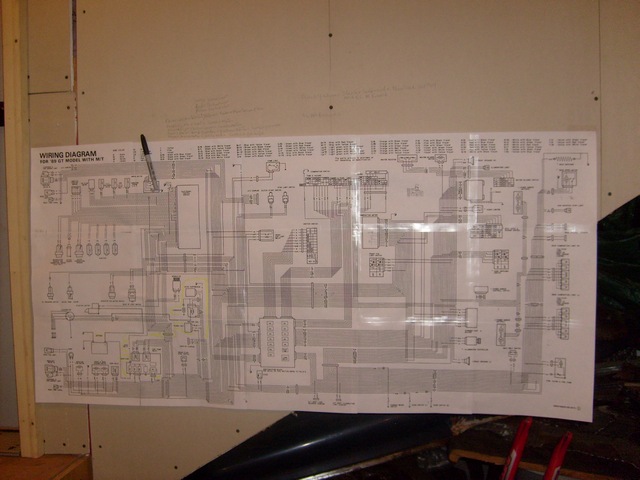

I like McMarks test engine idea. Hey, So am I off my nut to suggest using a modern FI off some 1.8 or 2.0 four banger? Find something with a blown up engine and strip the whole thing off including the injectors. Peel back the harness and strip everything that doesn't make spark or fire an injector... Transfer the guts from the distributor of the donor engine. I bet some crafty 914'r could make their engine run. Retain the test port in the donor harness to read and code errors.
I'm putting a 1300 GTI twin cam Suzuki Swift engine in a 1959 Austin Healey. I stripped the harness of all the crap that doesn't make spark or fire the injectors or run the distributor. I'll let you know if I can get it running. It's a slow process for me. I aalways have too much on my plate.
