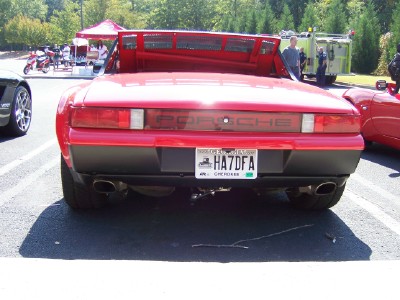

Mines not quite the stock-look but I think it is very clean looking. The prior owner said he used mufflers from a 996 because of clearance issues. I have a 915 with some crazy fabrication going on for a cable shifter. Here is a pic from behind and I can take some from underneath if you like.

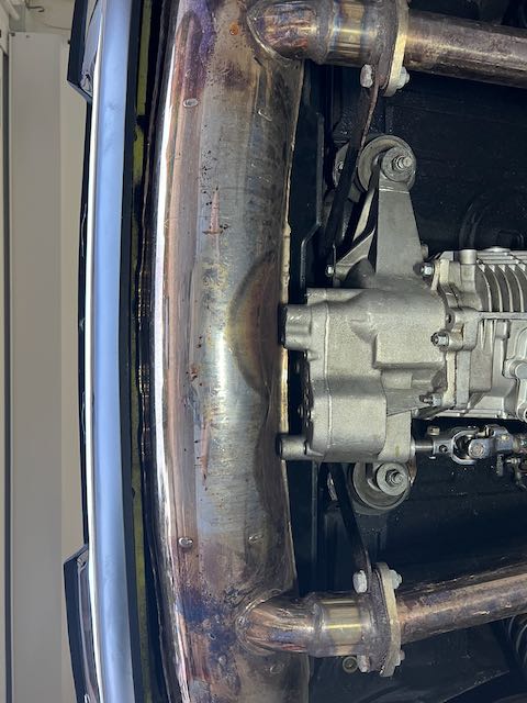

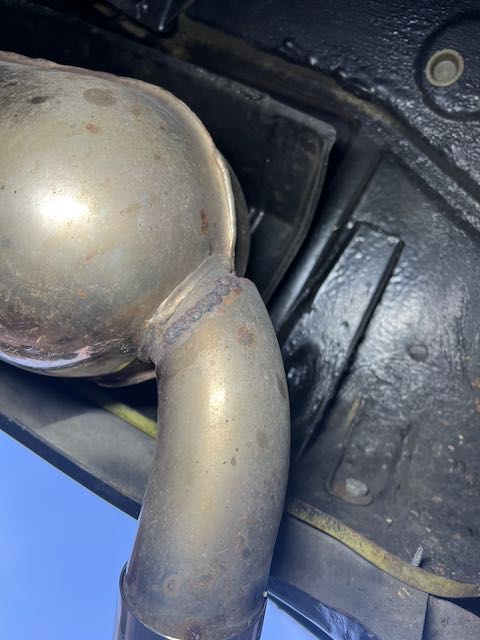

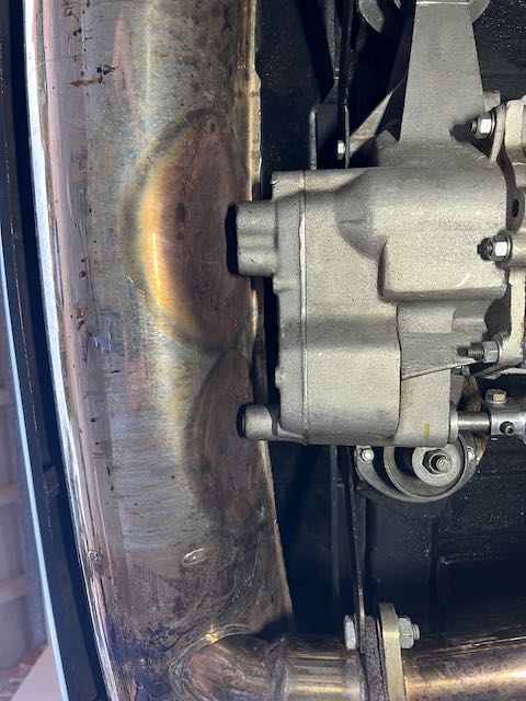

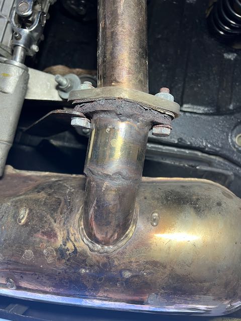

Anything new under the sun on this topic? My car looks to have a modified 911 muffler with the input pipes lengthened to clear the end of the transmission and then the tail pipe at a different angle to work with what I think is the stock 4 cylinder rear valance.
I’ve also realised that there is no support bracket from the end of the transmission to the ends of the heat exchangers so the entire weight of the muffler is cantilevered off the heat exchangers.

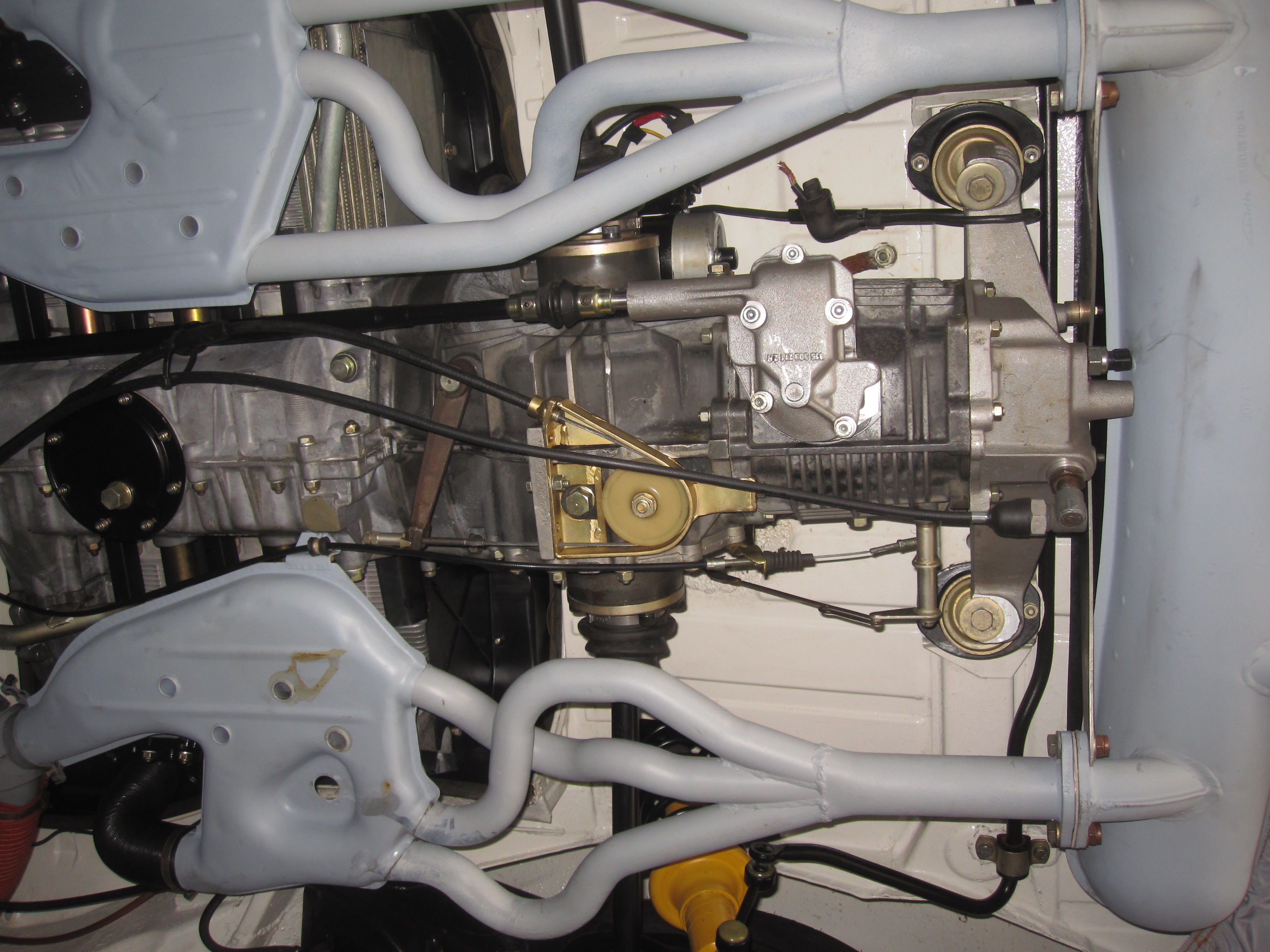

I've fitted my muffler to WEVO 915 cars a couple of times.

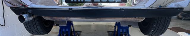

This is what my current system looks like.
I was mistaken; there is a support bracket.
Chris, your headers/heat exchangers look shorter than mine.
Steve
