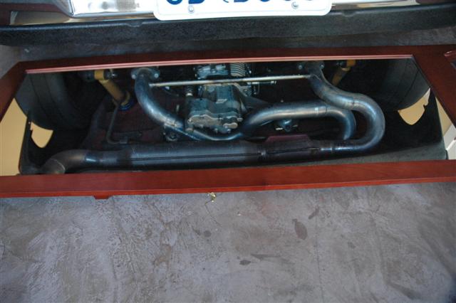

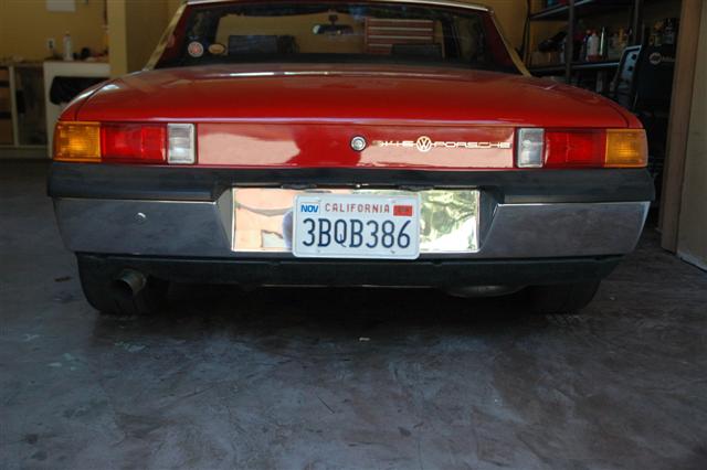

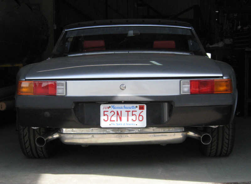

Mines not quite the stock-look but I think it is very clean looking. The prior owner said he used mufflers from a 996 because of clearance issues. I have a 915 with some crazy fabrication going on for a cable shifter. Here is a pic from behind and I can take some from underneath if you like.

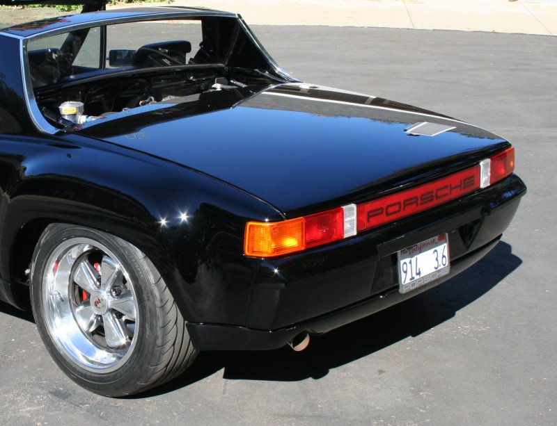

Here's mine:
Flowmaster muffler, custom exhaust. Exits the stock cutout on the valance. Nice piece of work form Rothsport Porsche here in Portland. I don't see how you can get the "stock" look with anything else.

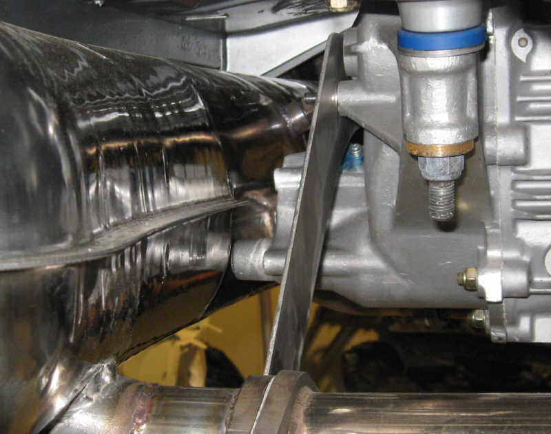

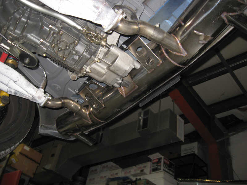

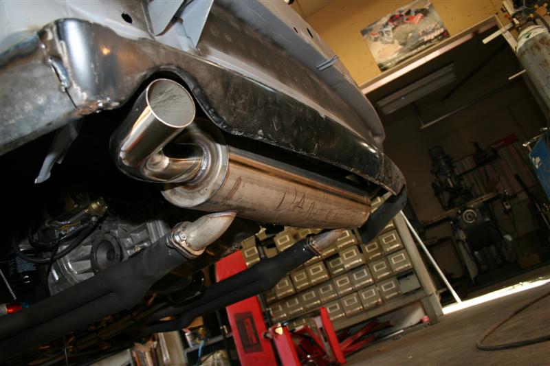

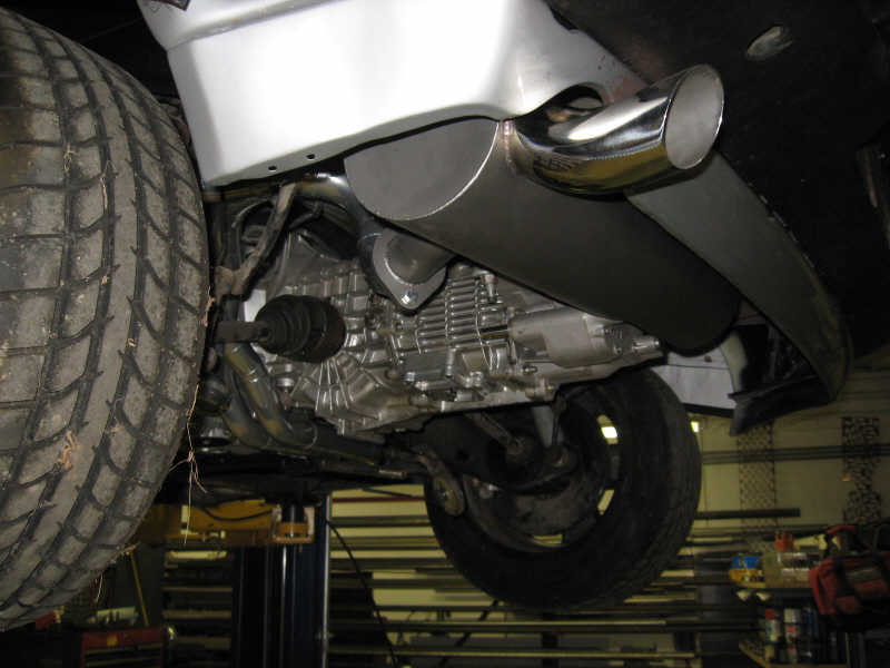

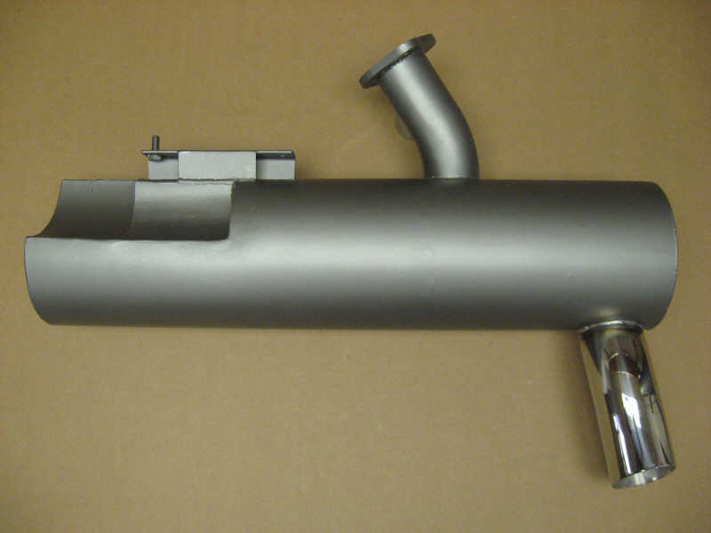

We moved the banana muffler back 1 1/2: and added a pocket for the WEVO on this six:
This is a Tangerine EVO II silencer we modded for a WEVO. A lot easier than the -6 mods above.

That's odd, it would seem that the mod'd banana would be easier. The plumbing under the 915 for the evo looks scary expensive. I looked at your site and don't see either listed. How much?
ChrisFoley
The EVO silencer is for a 4 cylinder. The Tangerine Header only required small alterations to clear the clutch arm on the 915, and the end of the muffler can was fairly easy to alter, since that area only contains sound deadening materials.
The banana muffler is a Dansk stainless unit, and inside are some chamber walls and baffles that are affected, so it was a rather big project. That muffler mod involves extending both inlets by 1 1/2" as well as cutting the can open.
Both jobs are custom, so no set price that could go up on the website.
I would want to have the car at the shop for the six cylinder exhaust work. I think the Tangerine exhaust system can be modded without having the car, now that we have done it once and we manufacture the entire system anyway.

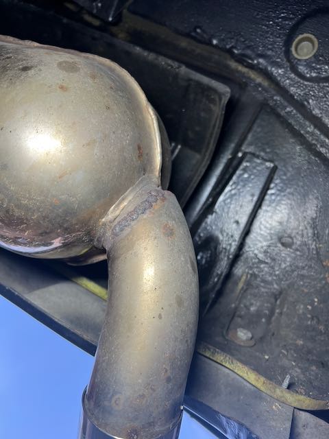

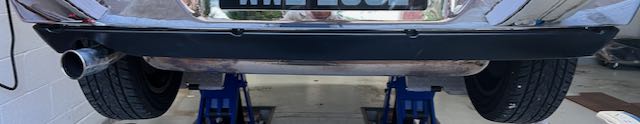

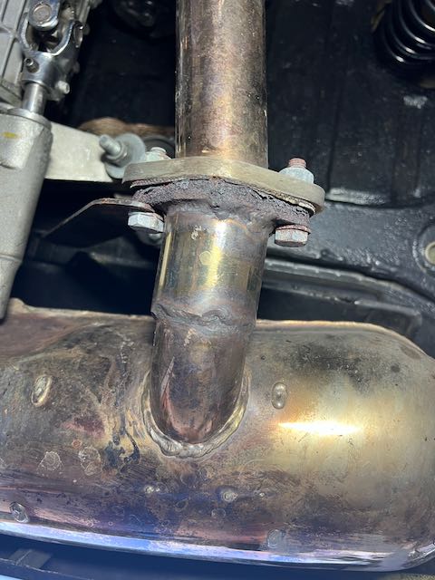

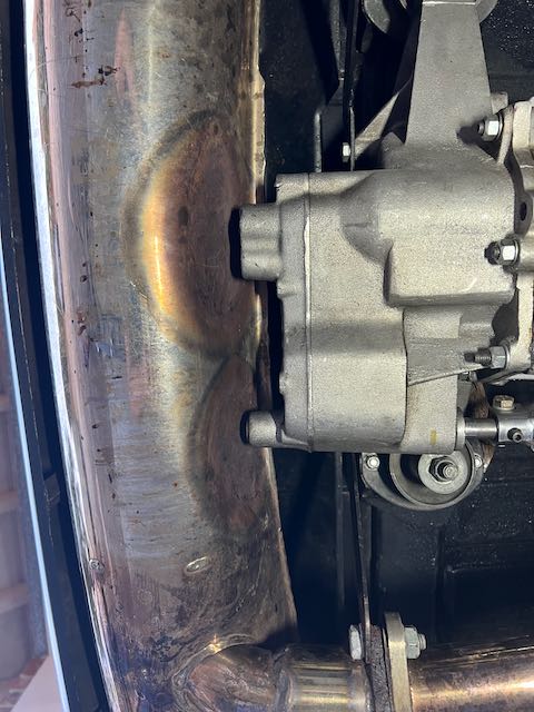

Anything new under the sun on this topic? My car looks to have a modified 911 muffler with the input pipes lengthened to clear the end of the transmission and then the tail pipe at a different angle to work with what I think is the stock 4 cylinder rear valance.
I’ve also realised that there is no support bracket from the end of the transmission to the ends of the heat exchangers so the entire weight of the muffler is cantilevered off the heat exchangers.

Just make some adapters to extend the muffler back 1.5” and done. Made many of them over the years.
I’ll need it for my car. I was hoping I could do exactly what Ben just suggested since I want to use one of his mufflers that I have tucked away. I’m not using a rear valance. I guess I will have to fab a bracket to hold the muffler (or space out the one I have) but that can’t be difficult.

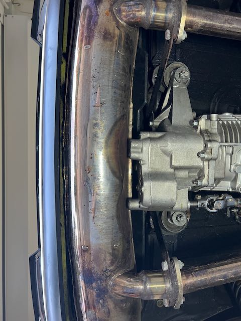

This is what my current system looks like.
I was mistaken; there is a support bracket.
Chris, your headers/heat exchangers look shorter than mine.
Steve
I love the sound of the M&K muffler and it fits behind a Wevo.
