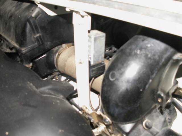

Engman
post Jul 11 2009, 11:49 AM
Zoisite
Posts: 1,349
Joined: 25-March 03
From: New Albany, IN
Member No.: 475
It looks like you have the intermittent wiper relay inside the cabin.
It normally mounts here

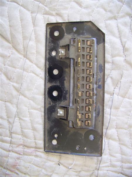

PanelBilly
post Jul 11 2009, 12:16 PM
Posts: 5,948
Joined: 23-July 06
From: Kent, Wa
Member No.: 6,488
Its one of your panels, but I bought it from another member who bought it new and never installed it. Here's a photo of the OEM panel. The relay clipped in the two holes in the lower left corner
Engman
post Jul 11 2009, 12:40 PM
Zoisite
Posts: 1,349
Joined: 25-March 03
Member No.: 475
No problem - will get you a new cover panel and even include a ss brake resevoir strap for your issue. PM me your address.
