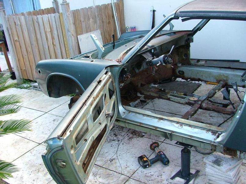

The classifieds on this site are an excellent place to look for parts; practically everything - including engines - come up.
No emblems on the sails; there are small holes along the bottom of the sail panels where the trim piece clips in. Anything else would not be original - or they are rust holes that have been filled.
Good luck with your build; it's a great thing you and your dad are doing. Keep posting here - there's ton's of help to be had.
The frame bracing is a good idea with the car up on stands like that - however the jackstands up front look very over extended; CAREFUL
I have a '73 2.0 so if you need any reference pics when it comes time to reassemble just ask.

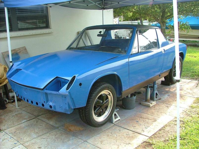

I have to second the idea of buying parts used from other members and from the
vendors who are members here. You can get literally any part from people
on here and it is way cheaper than buying new. I am doing a 1973 myself
and looking back after 18 months I realize I could have saved a lot on parts.
Also, when I needed something in a hurry, then AutoAtlanta has really
been great for me, and their catalogue is like a reference manual, you can
learn a lot just from reading it.
Good luck, post lots of pictures, ask before doing anything and it will save your
wallet and your sanity.
My motto is "Everything I needed to know, I learned from 914 World."
