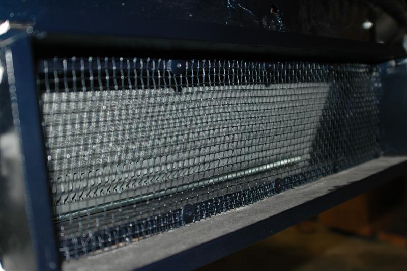

Are you referring to the standard cooler? I have seen one with the cooler mounted to the grate above the engine as well as ones with the cooler under the rear trunk. Both with thermostatically controlled fans.
The current 6 is a 914-6 engine (not 911) but is not original to this car.

Any thoughts on this particular configuration. Would this work with 3.0 fuel injection our would it be smarter to go weber or PMO to get it to perform right.
I remember reading somewhere what the advantages of a big bore/short stroke engine was but do not remember right now. Any insight on this?
We have a very rare 1979 porsche 911sc engine , built to big bore/ short stroke 3.2 liter, complete rebuild to original specs. Has Std crank that has been magged & polished, new bearings, rebuilt oil pump, new chains, ramps and 930 turbo tensioners , new JE pistons (10.5 to 1 comp) & mahle 97mm nikesil cylinders .. Cams are 964/3.6 grind specs, this engithe pistons do have deep valve pockets, so you can run larger cams. The heads have been rebuilt, ported and polished , 3 angle valve grind, new valve guides, new springs.
