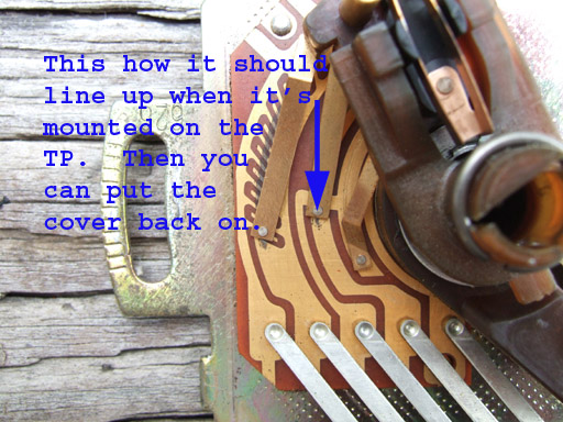

Three things to check and set.
Fuel pressure...get a gauge to test it inline before the pressure regulator.
Check when the car is cold, and again when its hot.
If it changes when hot and goes down...increase it by turning the bolt on the end of the pressure regulator and set the pressure to 28-32 when hot.
Vacuum lines (I get sick of people that claim that this wont affect the car...it does, it does create a low idle issue)
Check them and clamp them if you have any potential leaks.
If you have the knob on the top of the ECU...where is it set?
This is idle enrichment and if its cranked up to the max...you flood at idle.
and finally, the TPS
It needs to be set in a specific position, no other.
It is only adjustable because the switch is used on alot of other cars..volvo, merc etc.
So, open the cover, clean the gold contacts with di-electric cleaner and set it like the picture at idle.
Rich

I've checked the TPS and filed the TPS reports. Adjusted the valves. Checked the dwell and timing yet again.
What else can be causing this?
