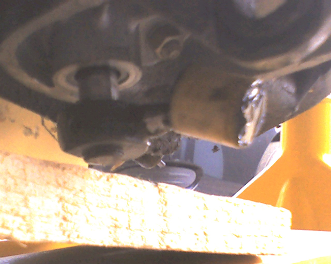

Pulled out the Tranny the next day (Monday). But this happened and I don't know if it was not supposed too.
After dropping (pulling) the tranny, as I moved the Jack from under the car this fell off.
The bushing was left on the tranny.
Is this okay?
Dr Evil
post Sep 1 2009, 11:31 PM
Send me your transmission!
Posts: 23,044
Joined: 21-November 03
From: Loveland, OH 45140
Member No.: 1,372
Oh Shit! That is totally OK.
