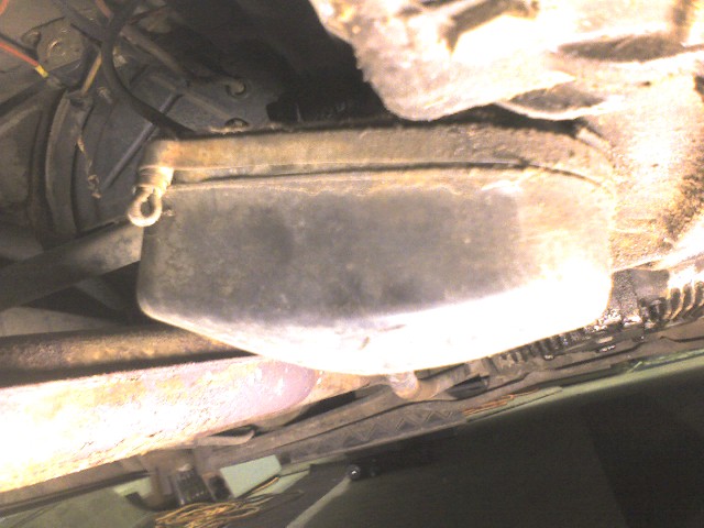

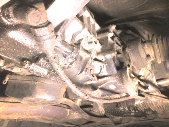

But whats the best way to remove without damaging:
Shift linkage (remove the Spam Can without damaging the clamp), speedo cable & clutch cable?
A few pictures of what I'm dealing with...

Where and what exactly do I remove?
Cupomeat
Aug 17 2009, 02:20 PM
Ok, at the end of the shift rod, behind the bushing, the piece (which is also the cup for the ball socket) that slides over the shift rod has to be removed. You can see the set screw (pin) on the bottom side of it.
Use an allen wrench to remove the pin and gently knock forward the shift rod out of the piece.
Does that help?

Dr Evil
Aug 17 2009, 06:30 PM
The yellow arrow is the rear conical screw. There is one in the front that needs to be removed as well. The whole outer linkage needs to be removed to pull the tranny without issue. The blue arrow shows the end of the rod that you push forward while you pull the cup rearward. Easy
montoya 73 2.0
Aug 17 2009, 11:04 PM
QUOTE(Dr Evil @ Aug 17 2009, 05:30 PM)
was wondering why the rod wouldn't back out of the case? So to the front I go! Thanks Doc. Oh, them triple square bolts are a real pain. I think I may have to destroy them to get them out. I got two out before the tool started to spin out. Vice grips should work good? Uh Doc, I'll buy two sets of bolts instead of one.

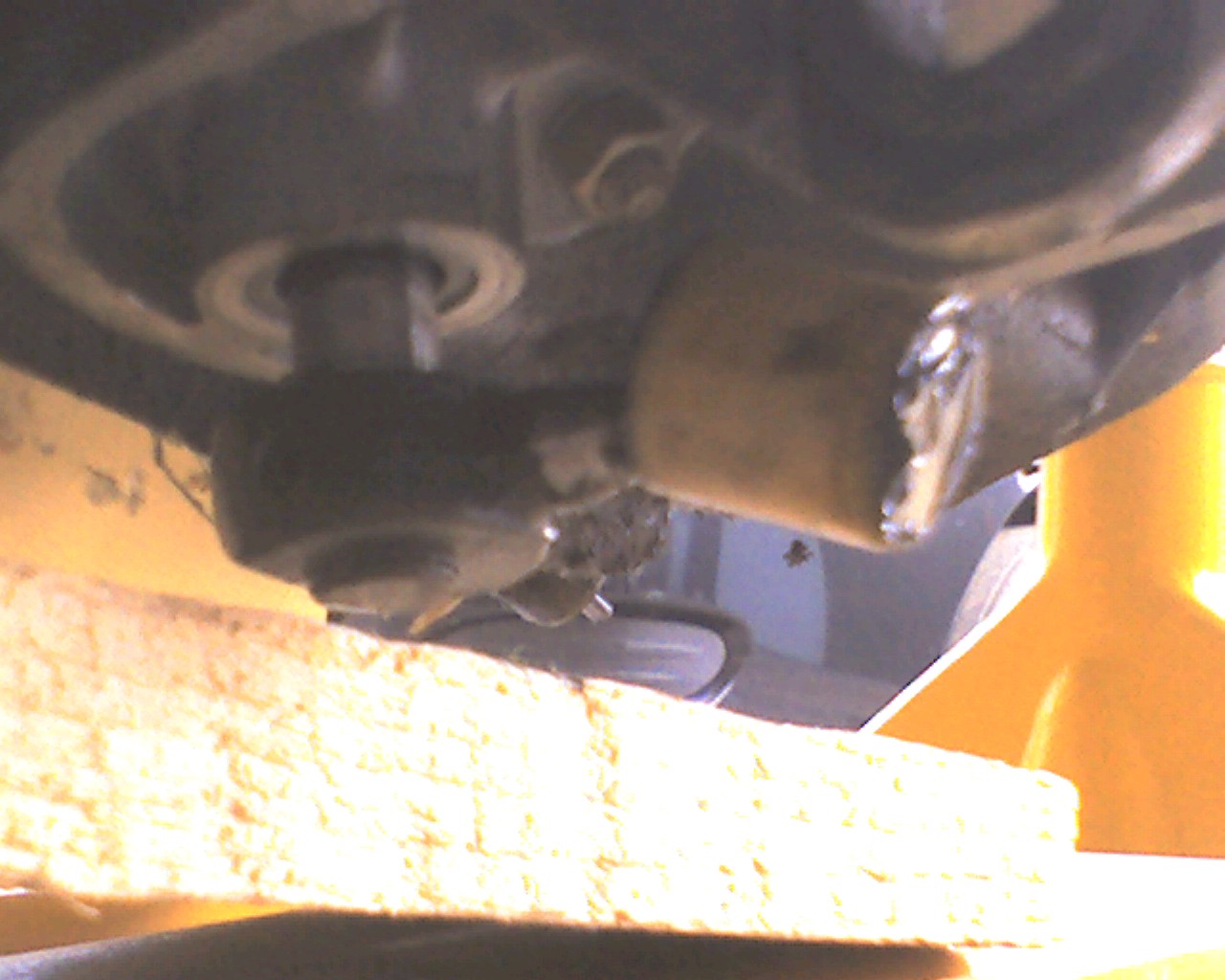

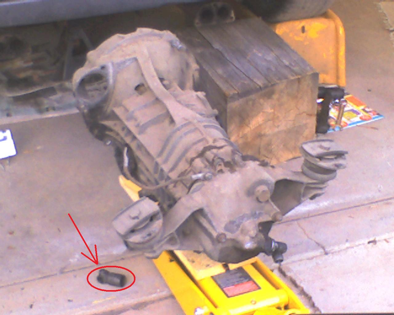

montoya 73 2.0
Sep 1 2009, 11:11 PM
Pulled out the Tranny the next day (Monday). But this happened and I don't know if it was
not supposed too.
After dropping (pulling) the tranny, as I moved the Jack from under the car this fell off.
Click to view attachmentThe bushing was left on the tranny.
Click to view attachmentIs this okay?
Dr Evil
Sep 1 2009, 11:31 PM
Oh Shit! That is totally OK.
montoya 73 2.0
Sep 1 2009, 11:55 PM
Okay cool! Just checking.
