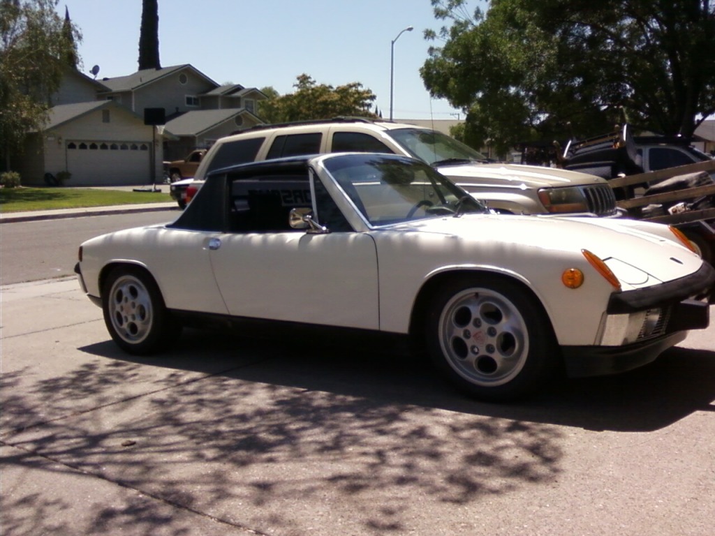

I have some Revolution 15 x 7 with 5" back spacing.They are almost perfect. I had to roll the rear fender lips some to get the 205-50-15 A6's to clear. If I could choose, I would go with 5.5. FWIW
